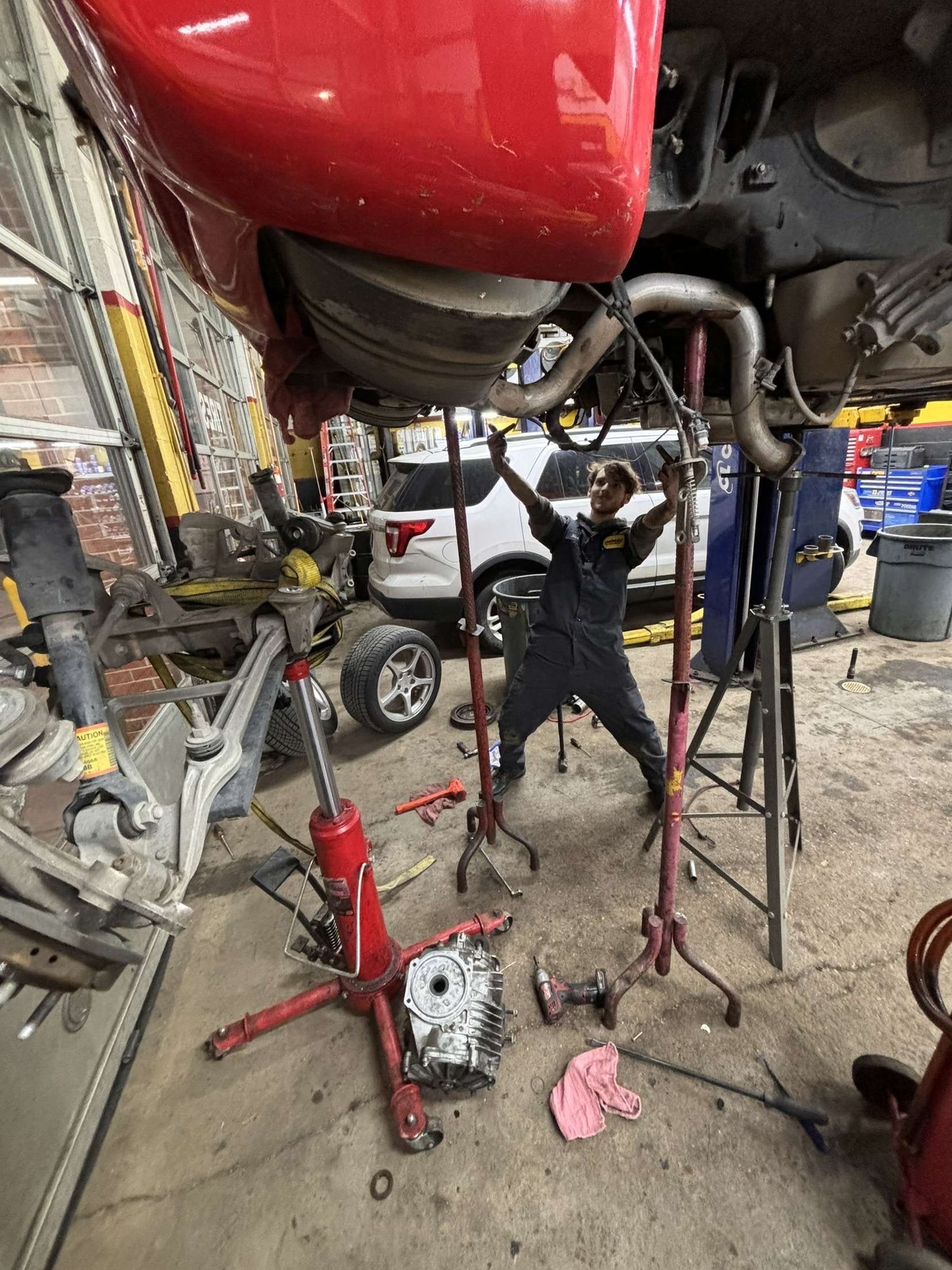

Hello, I have a 2000 c5 automatic. I recently tried replacing the seals between the trans and diff. Without much research I ordered #12455045 for the trans side. A brown quark material ring gasket. Didn’t realize at the time the description says “manual rear output shaft seal” and #24228816 for the diff side. A black quark ring gasket. Description for it is “transmission output shaft seal” Needless to say I still atf dripping between the diff and trans. I have scrolled and scrolled through the internet and can’t find the name of the seal that goes into the diff side where the output shaft goes through. Do I just get two output shaft seals???
