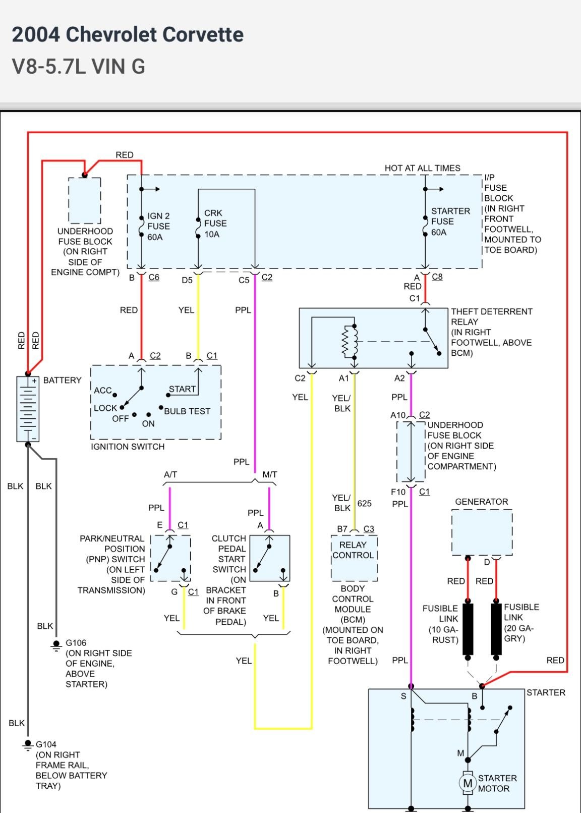

Here is your wiring diagram for your starting system…do you have a 12 volt test light and can you follow this wiring from the battery down to the BCM and on the load side from the starter fuse down to the starter ??…unfortunately we can’t diagnose this for you…HP Tuners probably won’t help you here and there are no trouble codes you posted that will keep the car from starting.
I wanted to say "thank you" for posting this. I didn't see it until today. I will use this for troubleshooting tomorrow, or perhaps tonight after work if it's not raining.

EDIT: Troubleshooting. When I turn the key to the ON position the aluminum box in the passenger side clicks twice. (That's the BCM is this correct?) When I turn the key to the OFF position the #37 relay clicks twice.
Still troubleshooting...
Soooooo, is this unplugged pigtail the TDR? Becauuuuuuuse I know I didn't unplug it. However, my ex wife had removed the floormat and fuse box lid.
I have 12 volts to one of the two orange wires in the TDR pigtail...
The TDR clicks twice when I turn the key to the ON position. I verified this by feeling it click with my fingers on it when I turned the key.
Okkkkkkkkkkkkkkkkay. I was wrong. The theft deterrent relay is on the left. What's the plug on the right?
I jumped the red and violet wires on the TDR and the car started! So I assume this means I have a bad relay?

There is more than one relay above the BCM, the TDR socket should have four wires a red,violet, two yellow wires one of the yellow wires will have a black strip. The red is battery power always hot, the violet runs down to the starter solenoid, solid yellow is +12 volts for the relay coil and yellow black strip wire is -12 volts or ground to the other side of the relay coil provided by the BCM.
