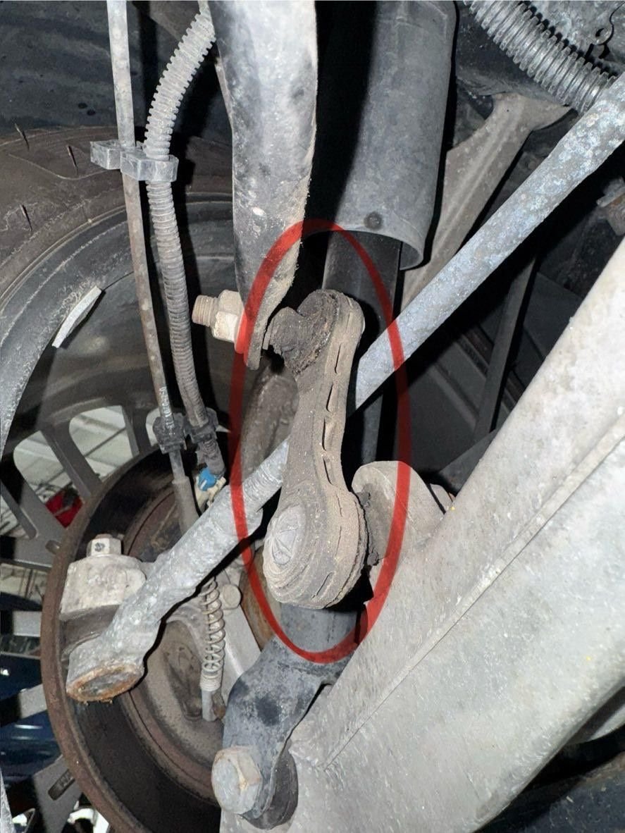

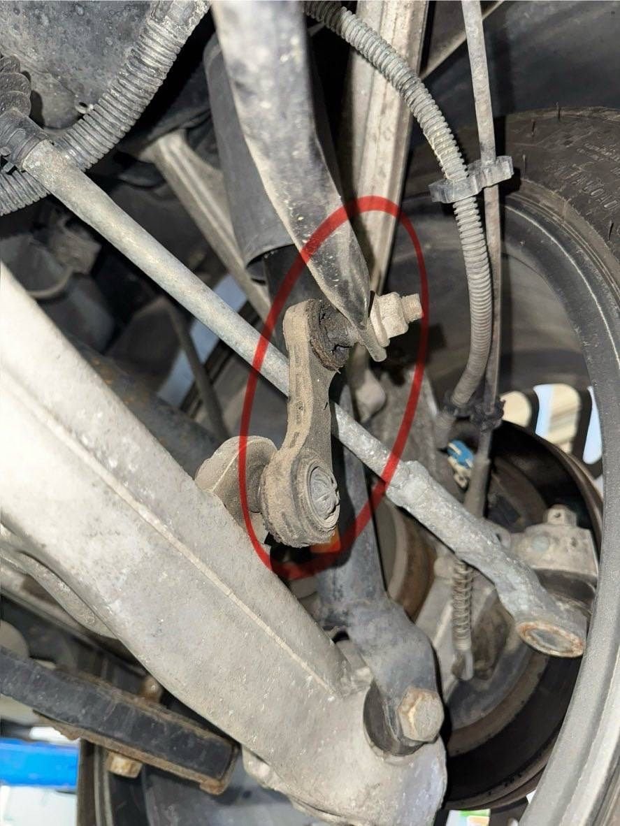

Hi,

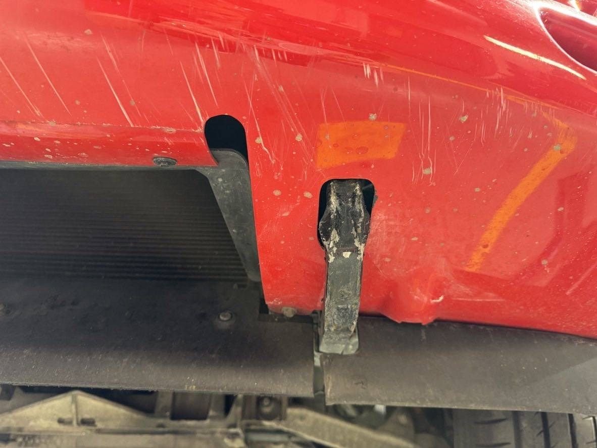

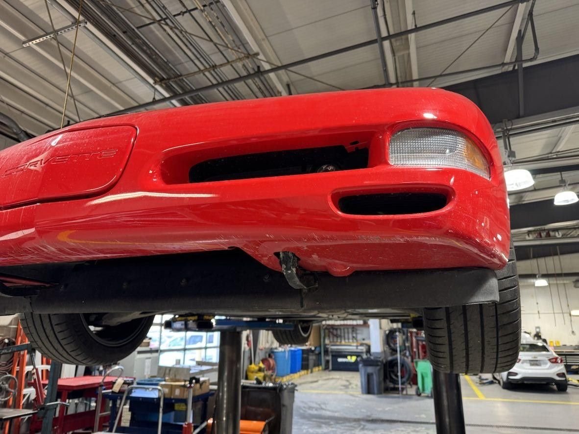

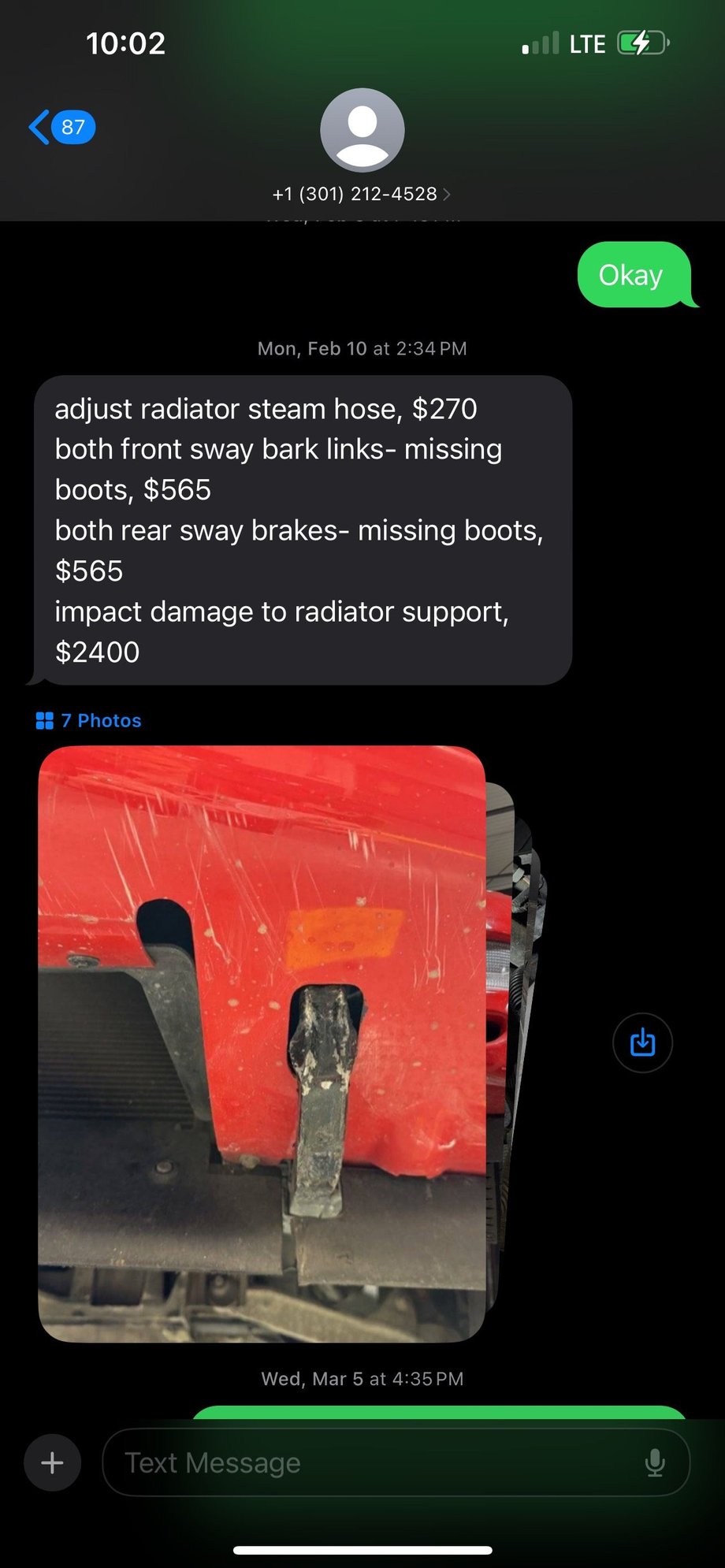

Recently my Grandfather passed away, leaving us with his 1998 Corvette. I started driving it and am feeling blessed to have to since I had no car. I took it to get inspected and was alarmed at the price of the fixes. I also started hearing a knocking noise behind where the the A/C is. And today the car started shaking and vibrating. I don't know much about cars but I am willing to learn. Are these easy fixes I could do by myself. I also live in Germantown, Maryland and am willing to pay someone to help me, I just don't have nearly enough to cover the costs of what the shop said.

Run. that is completely ridiculous.
Changing the clutch is cheaper than fixing radiator support. and half the car has to come apart to change clutch.

The rad support is mostly cosmetic and most C5s have the same damage\issue so no need to touch it. The sway bar end links are cheap on amazon and an easy replacement. The steam hose is attached with hose clamps...For someone to do what is needed at their home you are looking at probably under 100 bucks total for the replacement of the end links and "adjusting" the steam hose......Whoever gave you that quote wins scammer of the year

That shop is a ripoff. Get your car out of there ASAP!! Sway bar end links range from $6 to $32 on Rock Auto. Too bad you weren't closer to me. I'd fix that for no labour cost. I had a 98 for about 5 years. I've changed out my C6 end links 3 times and haven't spent what they want for just the front or rear.

That radiator support mount looks like that on every C5, the left side of mine has a folded over brace and it's bolt has been pulled through the frame (and I only know because I went in there to do headlights). You could replace it with an aftermarket support for ~$500 (for the part at least) but it's probably not worth it. The nose on the C5 is so long, it's going to scrape and be dented again, unless it's falling off or rattling/sagging forget it. The missing boots and stem hose are basically just labor costs and probably don't matter either, you do that stuff when you are servicing related components. You asked the shop "is there anything wrong" and they gave you the "well technically..." trying to make a lot of money taking some stuff off and putting it on again but with fresh rubber booties.
As for the vibrations/noise... could be nothing, it's almost 30, it's got aches and pains, noisy/stuck fan bearings...I thought the HVAC fan was a harmonic balancer in the early stages until I turned the AC off to listen and realized the sound/vibration was gone. I was right to be paranoid though because the harmonic balancer will go on every Vette. You should check your late grandfather's service notes if you have them and see if he already replaced it and also what are the miles? If you develop serious vibrations/bucking don't drive it!

Radiator support is not a problem. Mine looks worse than that. Doesn't affect anything if it's just cosmetic. I replaced my sway bar end links myself with premium Moog links ordered online. Parts were about $100 and took me a couple of hours taking my time but I also had to have the right tools.
