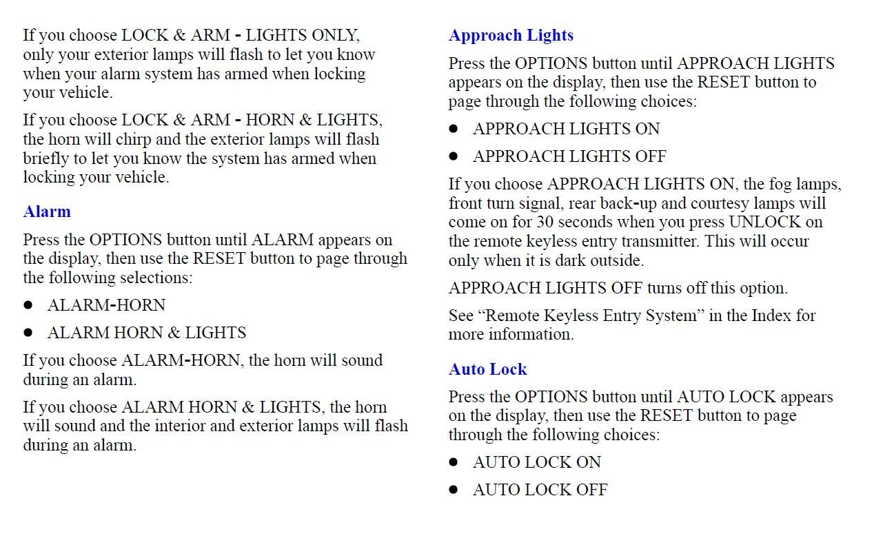

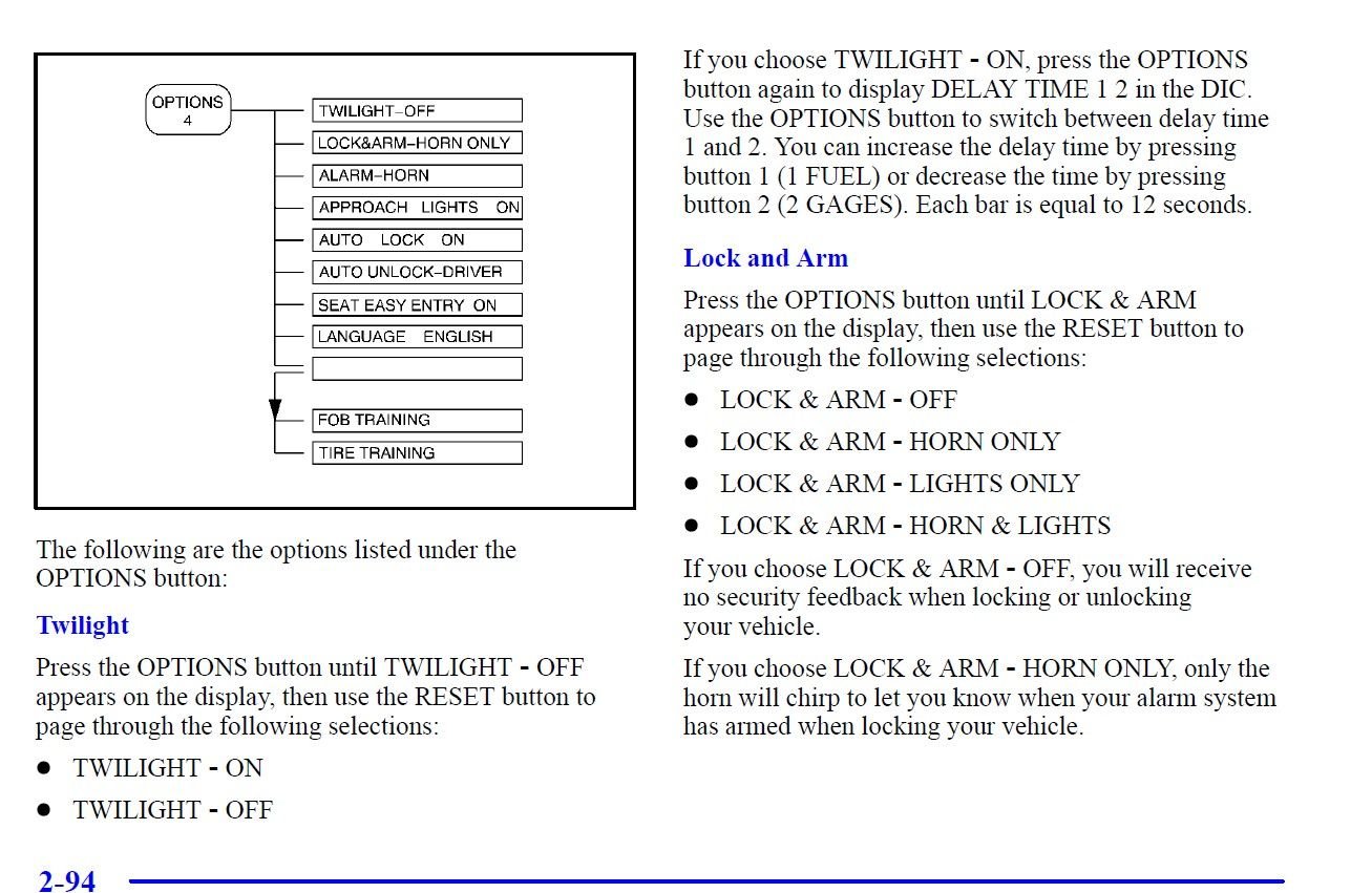

Does the horn sound when you lock the car with the fob?
Old Mar 27, 2025 | 02:59 PM
Espi2's Avatar
Espi2
Joined: Nov 2024
Posts: 205
Likes: 45
No - wonder if somehow turned that off in the options.
Old Mar 27, 2025 | 03:26 PM
lucky131969's Avatar
lucky131969
Posts: 19,388
Likes: 1,134
From: Dyer, IN
In your owners manual "lock and arm" :
Old Mar 27, 2025 | 03:30 PM
Espi2's Avatar
Espi2
Joined: Nov 2024
Posts: 205
Likes: 45
Thank you!
