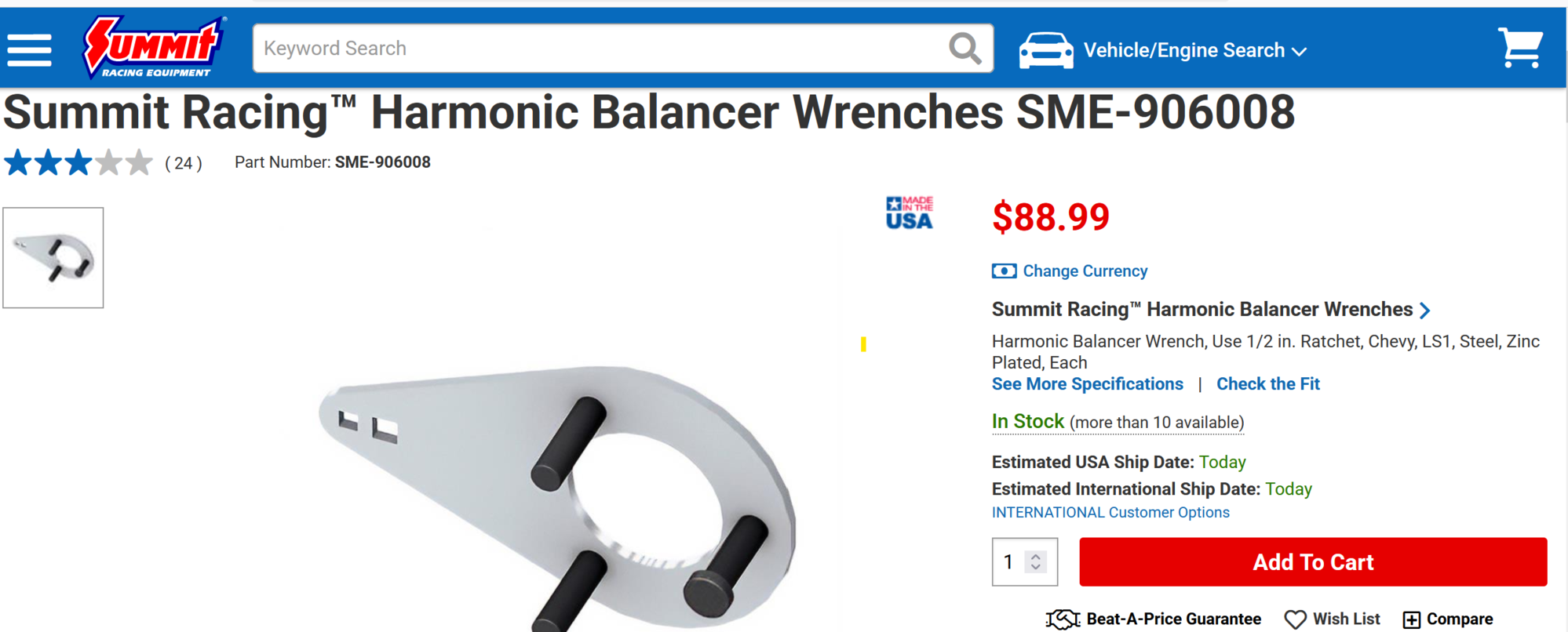

I'm assuming you have the proper tool that presses the balancer onto the crank already? That being said, Depends which dampener you have. I installed a Fluiddampr and had to use the one with bolts on the hub of the balancer. If you have a stock stye HB with the three slots there is another you can use.
Bolt on style:
Tool bolts to the front of the hub of the HB
Three pin design for oem/stock balancer:
https://www.summitracing.com/parts/sme-906008?rrec=true
OEM or stock style
OEM or stock style
You can probably rent a tool at Auto Zone. Many times you can purchase the tool and return it, in essence a rental. I just did this to use a steering wheel puller from Auto Zone, when done, I returned it and got a full refund.
