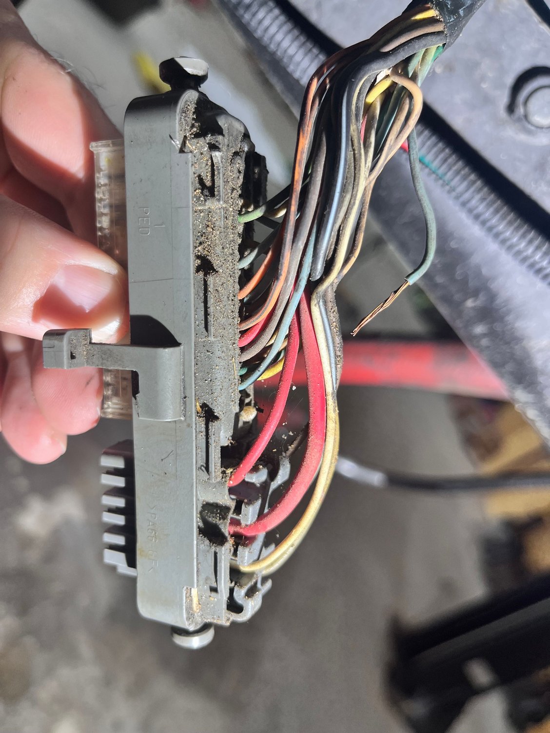

Hey all….does anyone know how to remove the cover on the harness to the brake controller? I’ve poked and prodded and now scared to break it. LOL

Not sure. But it looks as if you were to pull the little gray tab at the bottom and pull the upper portion upwards it would separate.

I thought the same thing....unfortunately, it's not like that

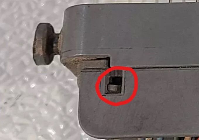

The backshell release is here. Should be one a both sides. You will have to clean that dirt out to see it.

thanks for the push Lucky! Got it figured out. So, yes, push those tabs in and then push forward and the cap slides off in a forward motion
