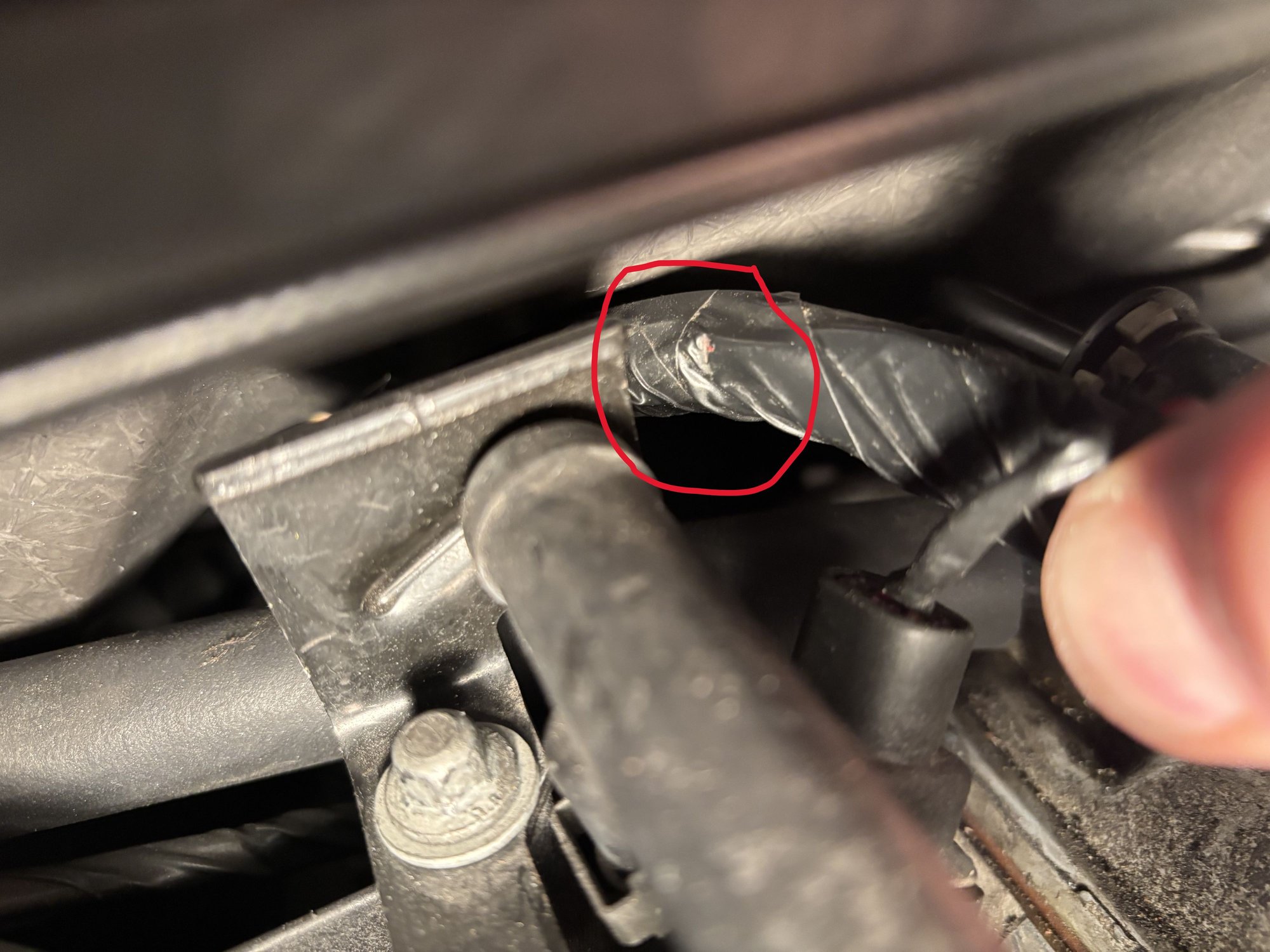

I think I may have found the rubbing through the injector wiring harness issue described in other posts. This is on the drive side where the wiring harness goes behind the fuel rail. Could this be enough to throw the P0200 error and would adding a few layers of electrical tape be sufficient to address this for the time being. The car seems to be running fine now

Yes that can be a cause !!…tape is a temporary repair…you want to splice a new section of wiring and solder and shrink wrap it depending how bad it is.
