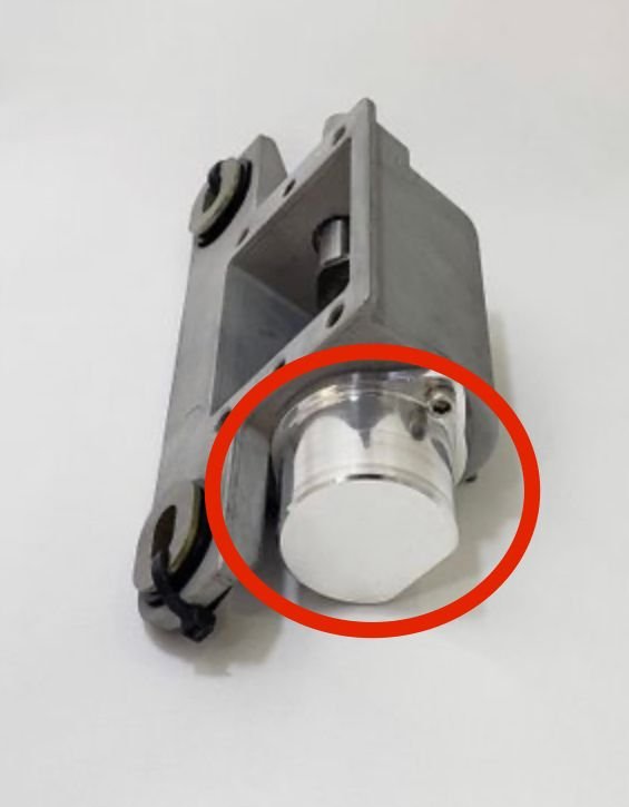

What is the circled item and is it needed on the billet box?…

Cap and bushing. The cup itself installed through there initially.
One thing which needs to be remembered is that the T56s everyone has are all different, and all of them have seen up to 28 years of relatively aggressive driving. They may take a beating and keep going but they also can be hard shifts. These same short shifters on a fresh box or on a 6060 are far smoother by nature. Annoying facts of life.
