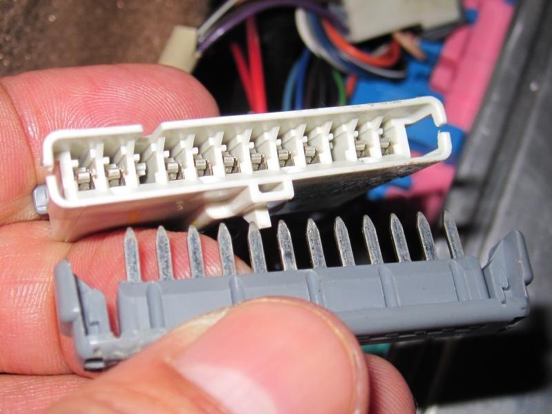

If you know where Star Connector 1 (has 8 or 9 wires on it) is next to the BCM remove the "comb" or busbar from the top of it and which isolates all the modules to include the radio...now jump the dark and light green wires which will connect the BCM and PCM together and will allow the car to start.
I unplugged the radio, unfortunately nothing. What do you mean by jumping the wires?

Maybe jump between the 2 Star Connector terminals is better terminology…this is the bus bar removed so wherever you can use to front probe those 2 terminals…light and dark green wires with a length of wire or bend a paper clip into a U and join those 2 terminals that way.
