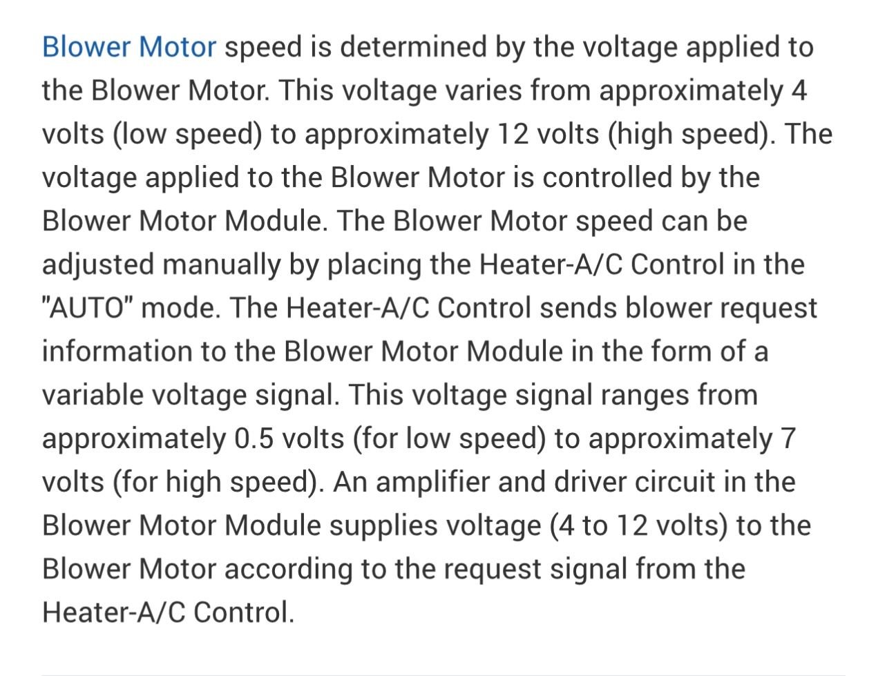

You could apply 12 volts to the red wire and see if the blower runs at high speed (12 volts)…it is PWM (Pulse Width Modulated) so the voltage as you can read in the description varies from 4-12 volts…if blower motor operates you will need to check the wiring.

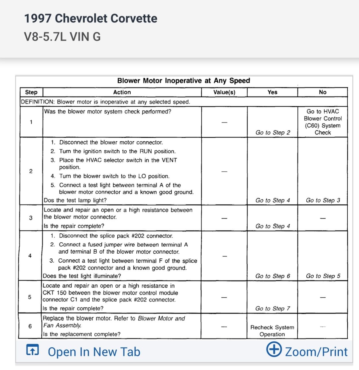

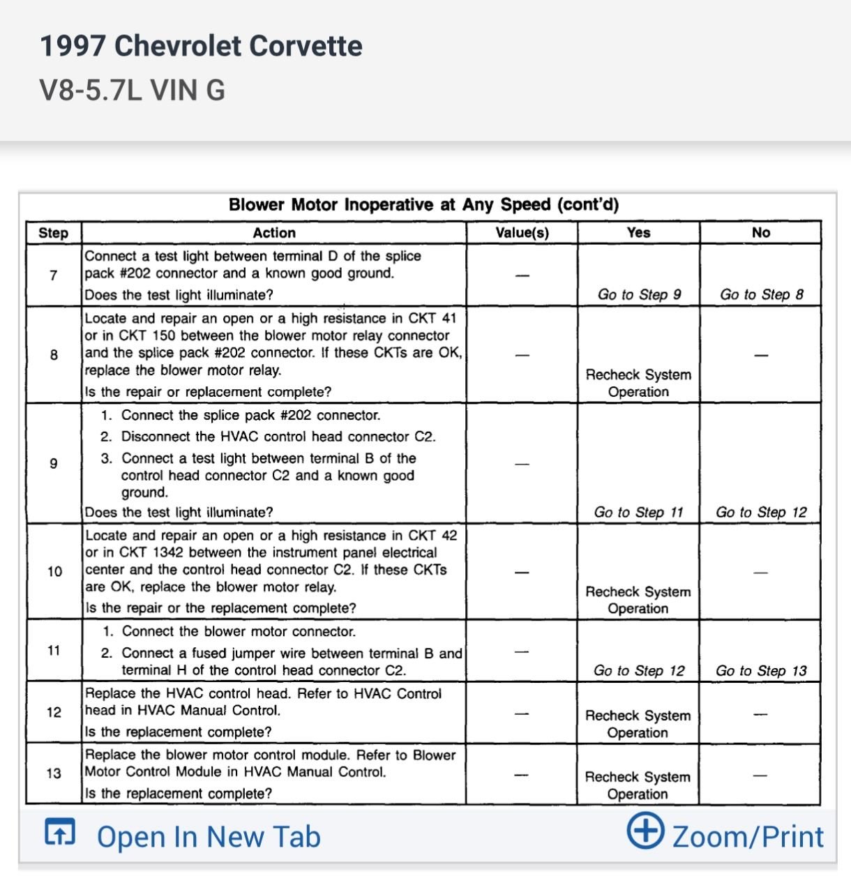

Don’t know…could be wiring, HVAC module or the module…if inop at all speeds you can follow the flow chart below.

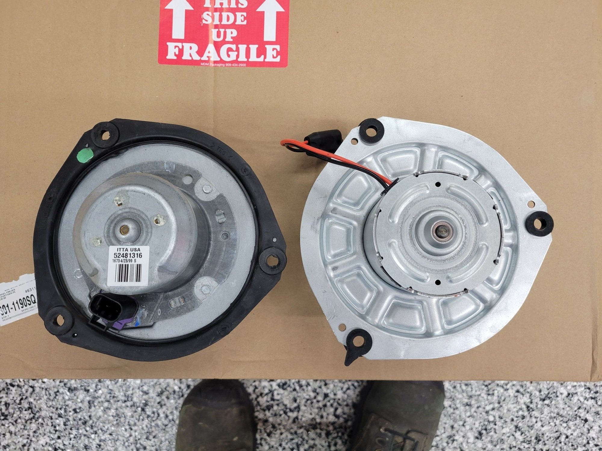

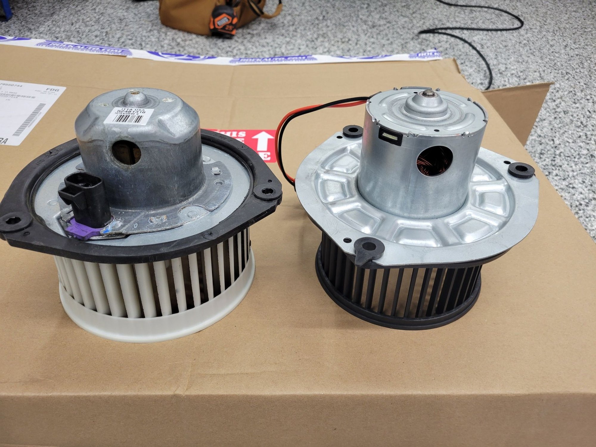

Yup, that is consistent with the new china replacements. Did the mount holes actually line up, and is the squirrel cage the same size. Below is my final attempt to get a blower from a local parts store. OEM on the left, crap replacement on the right.

yep, that looks like the one I have

I returned it it. The mount holes do not line up, the tube to route air to the blower motor does not line up/fit, and the smaller squrirrel cage will move a fraction of the air.
