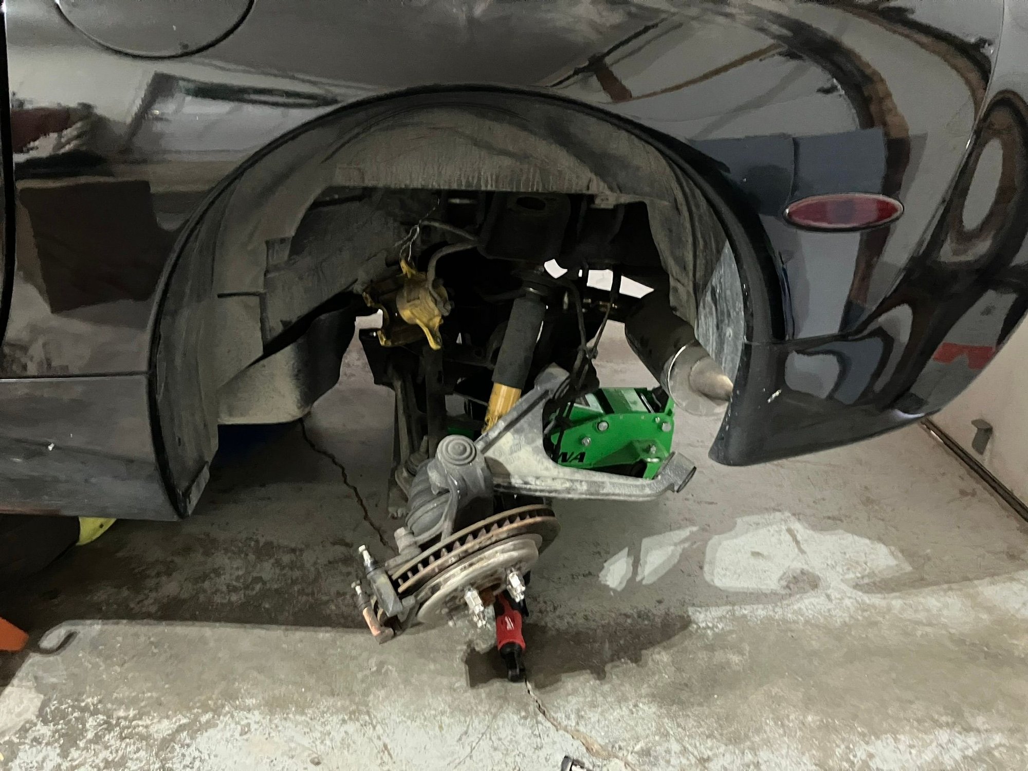

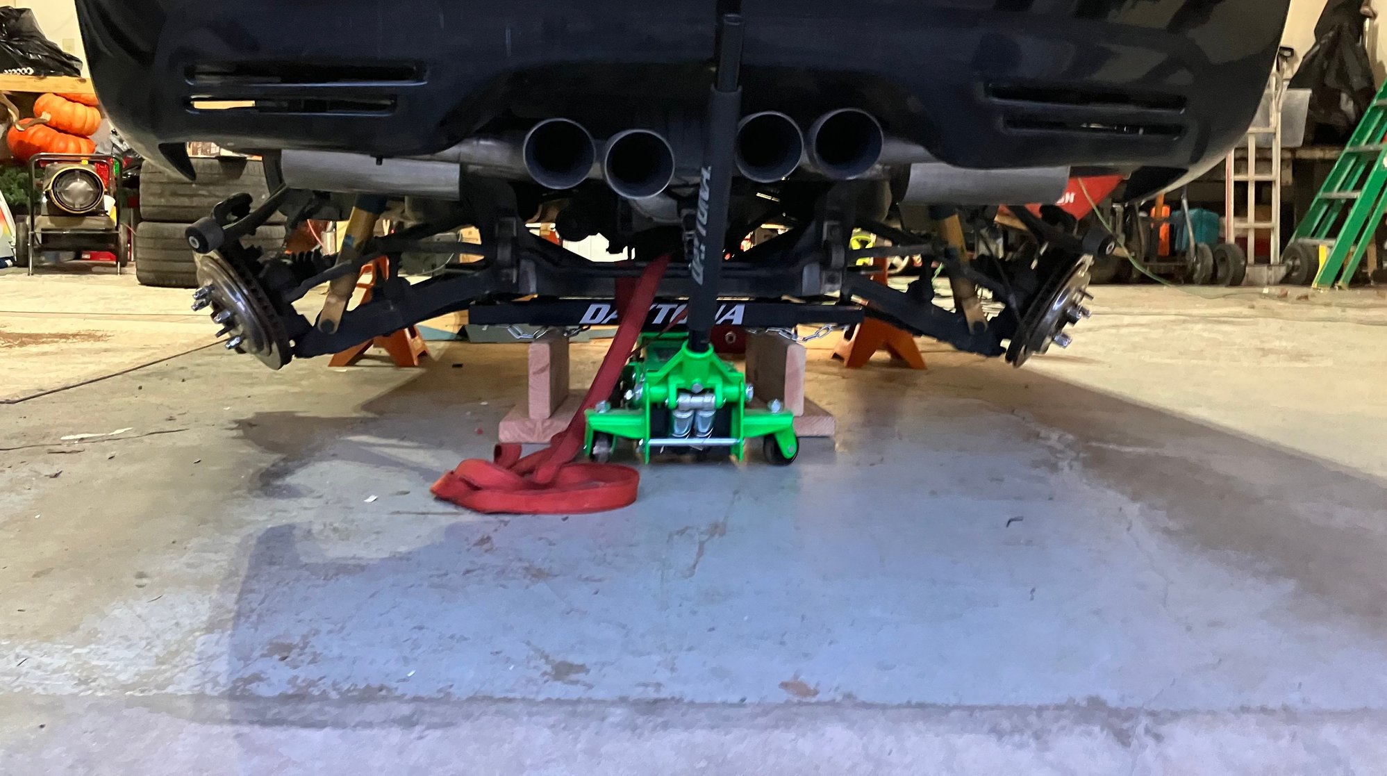

I just finished with installing a clutch and rebuilding the torque tube in my 99. It was done on jack stands by disconnecting all of the stuff from the rear suspension and then lowering the whole rear end just enough to slide the transmission off the back of the supported torque tube, then removing the torque tube from engine. The engine rocks back easily on the mounts enough to get the transmission off the tube. Just don’t try to lower the rear end too much as the engine will hit the firewall area and damage it.

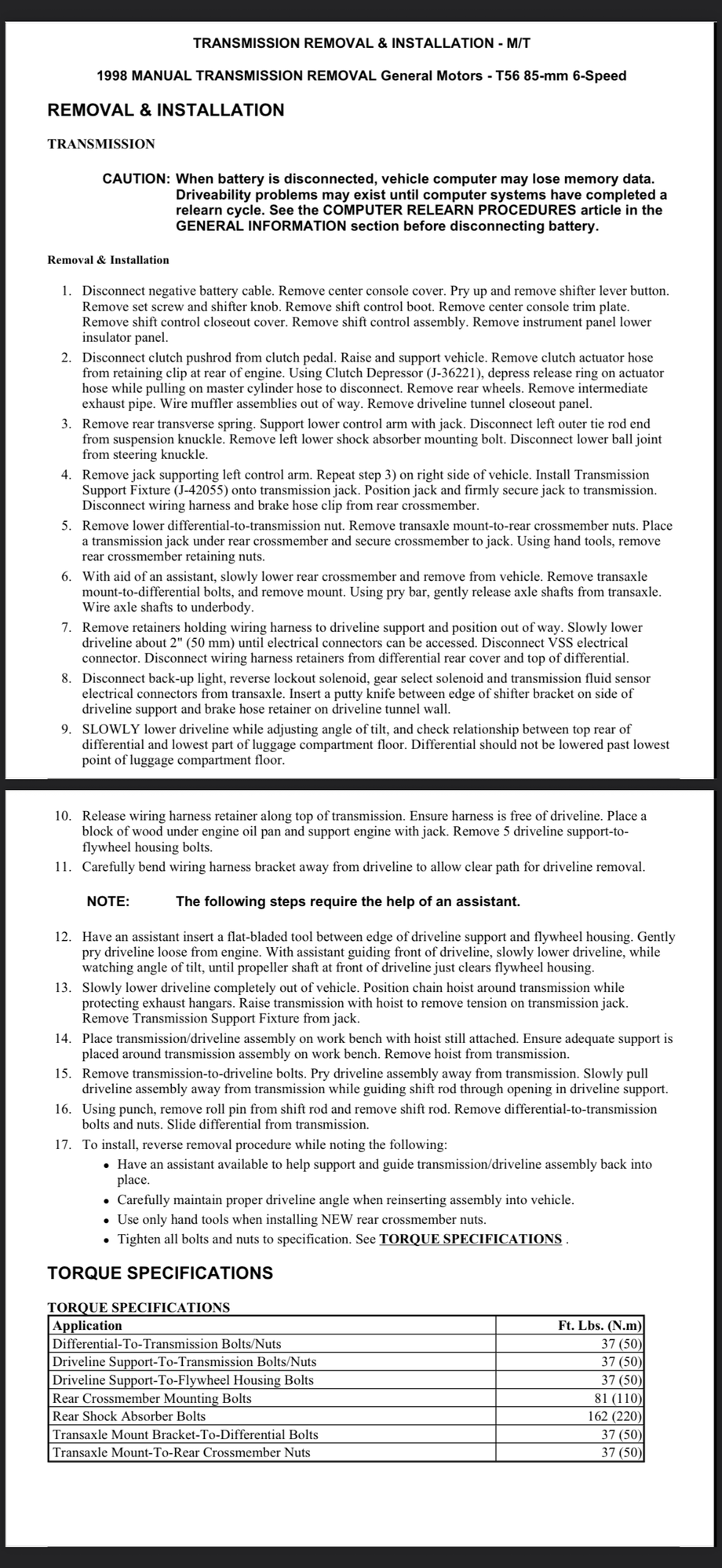

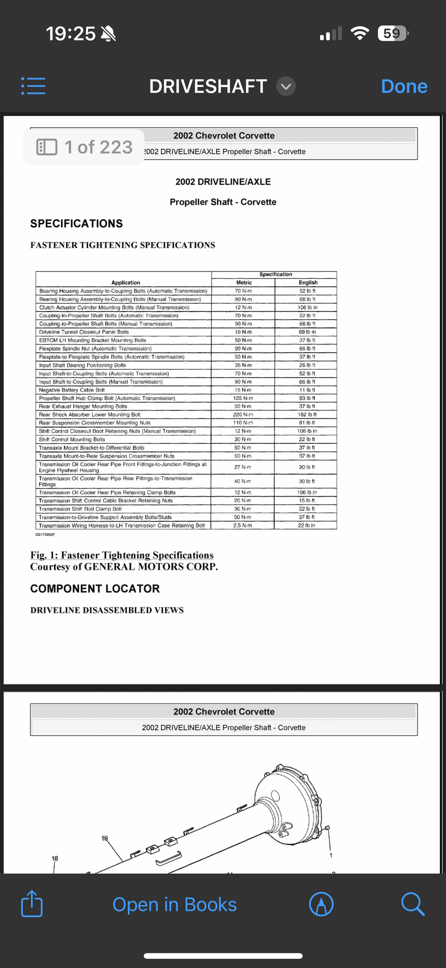

Hopefully, this helps.
I have this, too. Just not sure where to upload it.

That's definitely the no-frills version.
