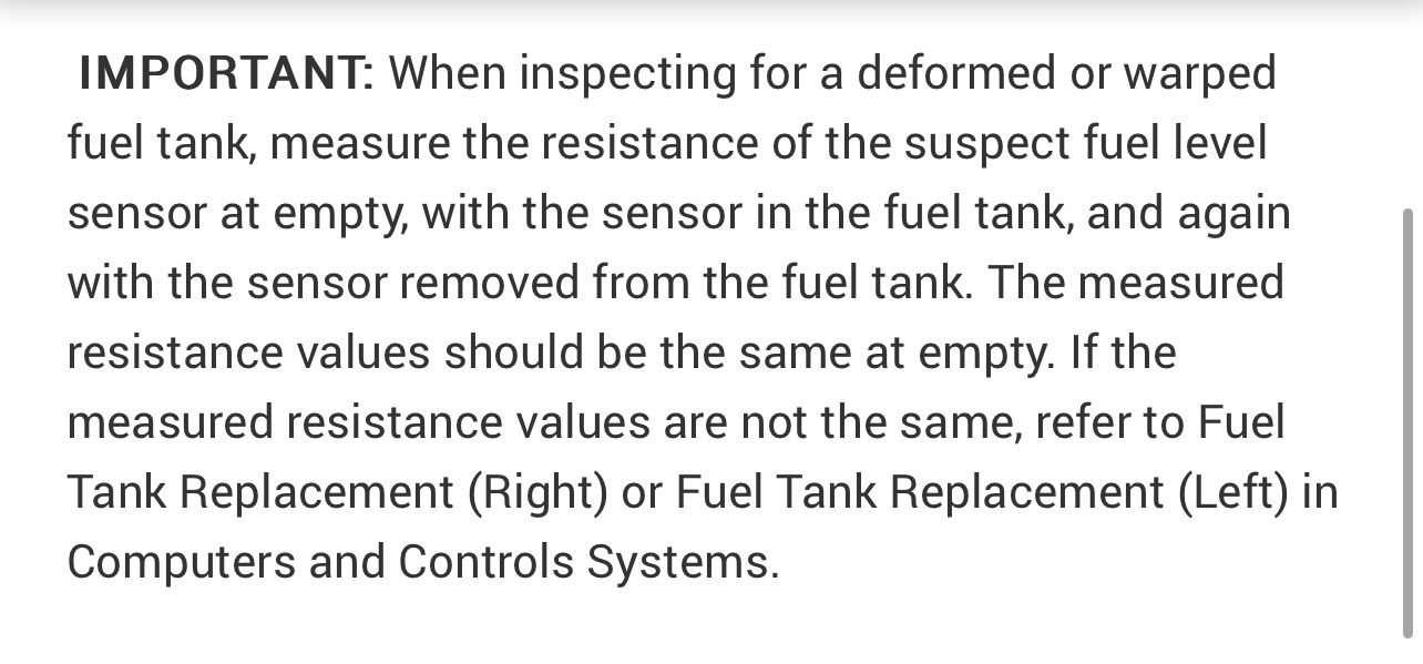

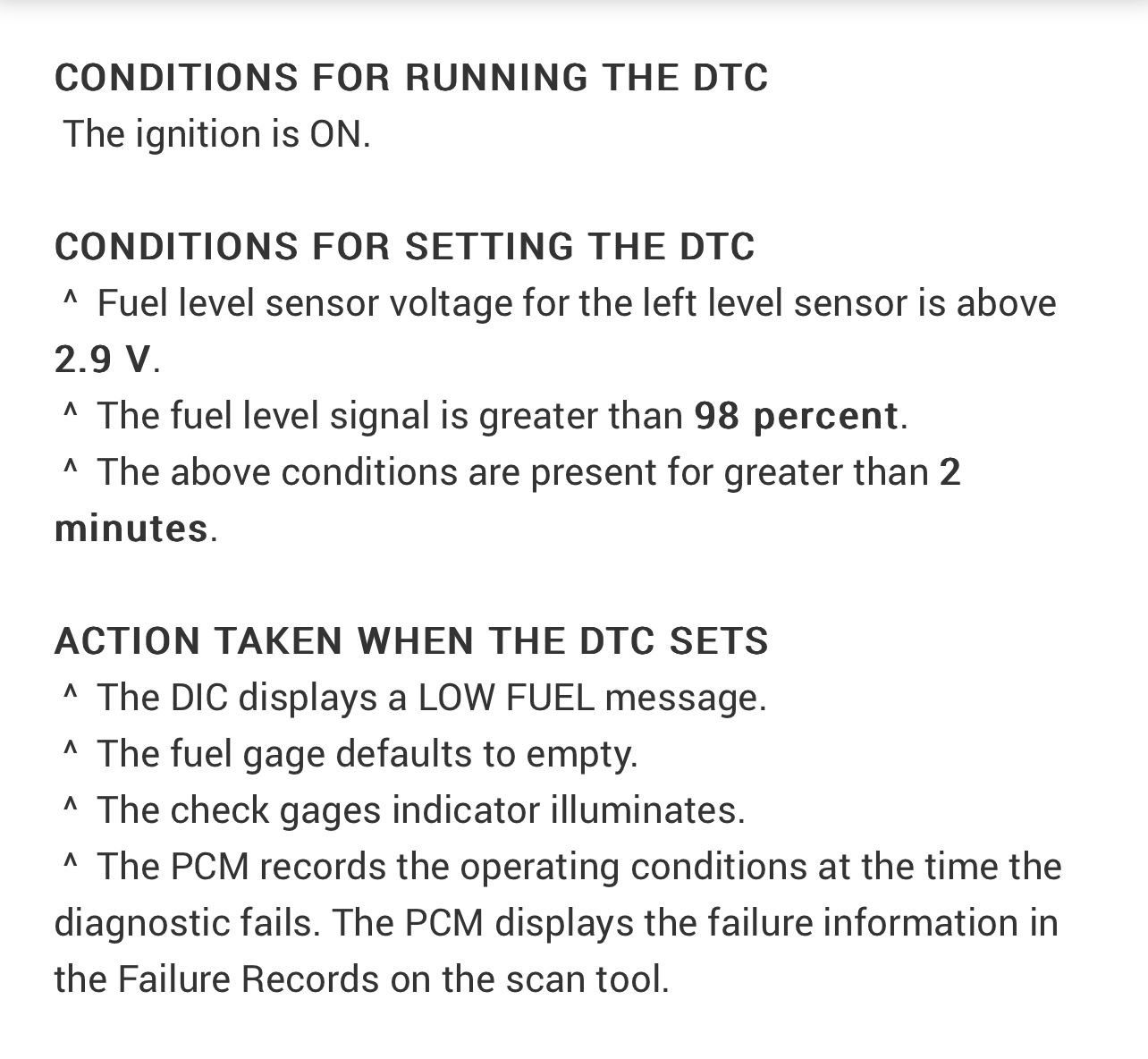

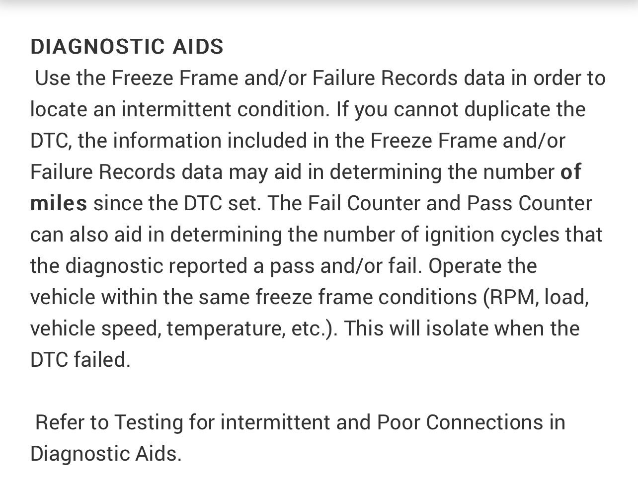

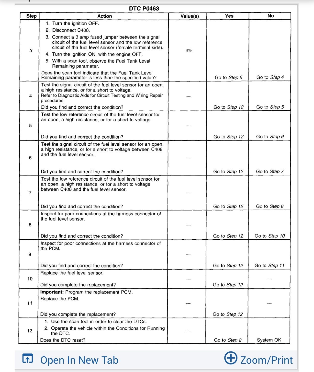

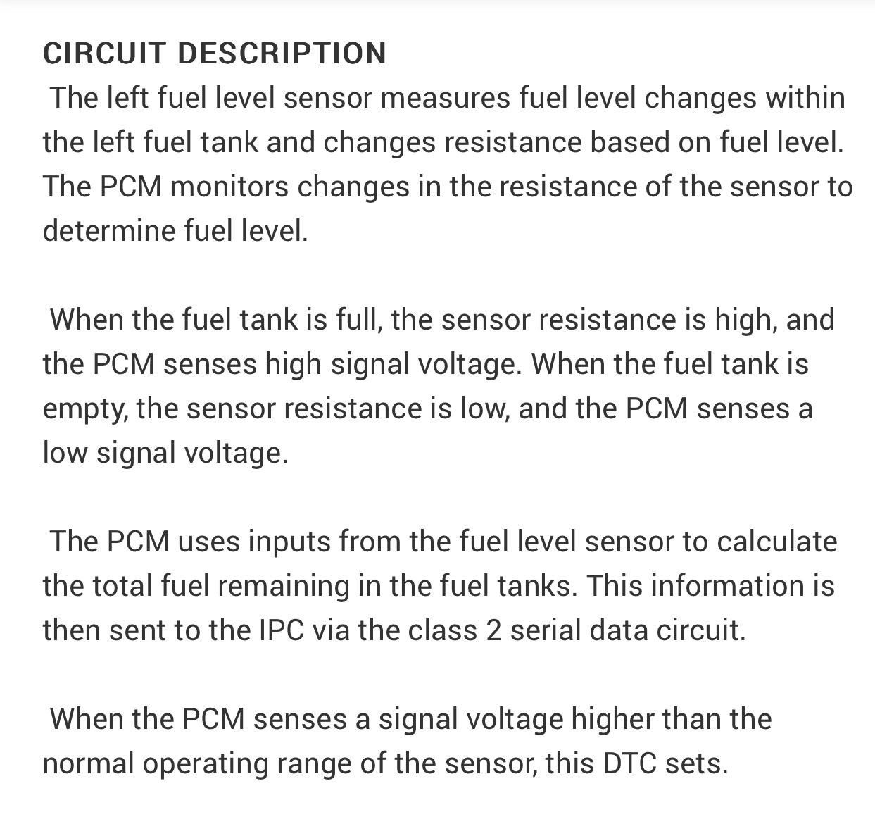

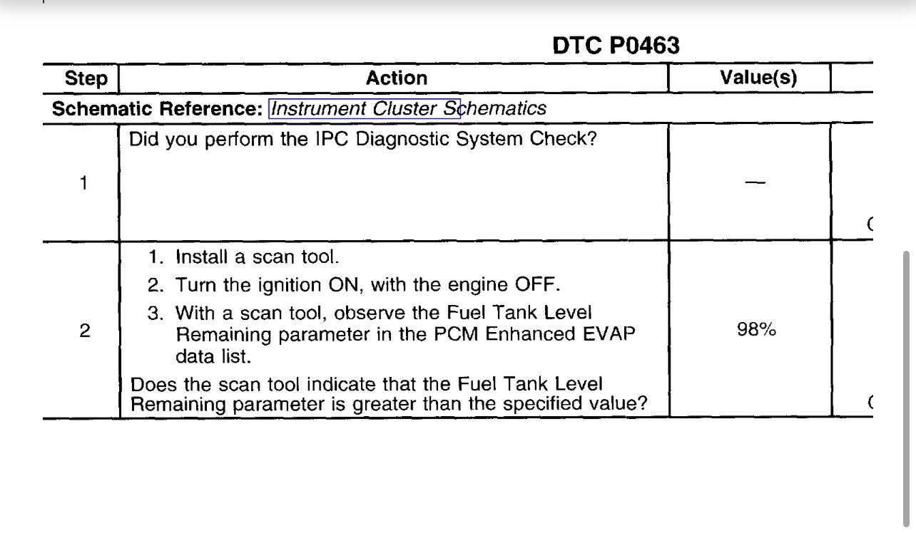

Unfortunately there is no one fix for every trouble code…if you have electrical experience and you can follow the troubleshooting instructions below this may help you…good luck !!
