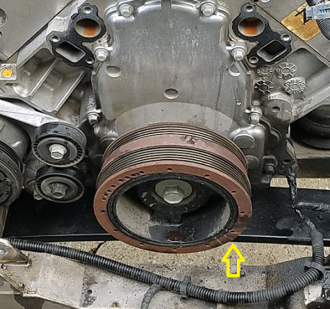

I took mine off a few months ago to do a cam swap. It looked smooth when running but now that I've taken it off.. there is a chunk of rubber missing on it.
2004 Z06 51k miles
