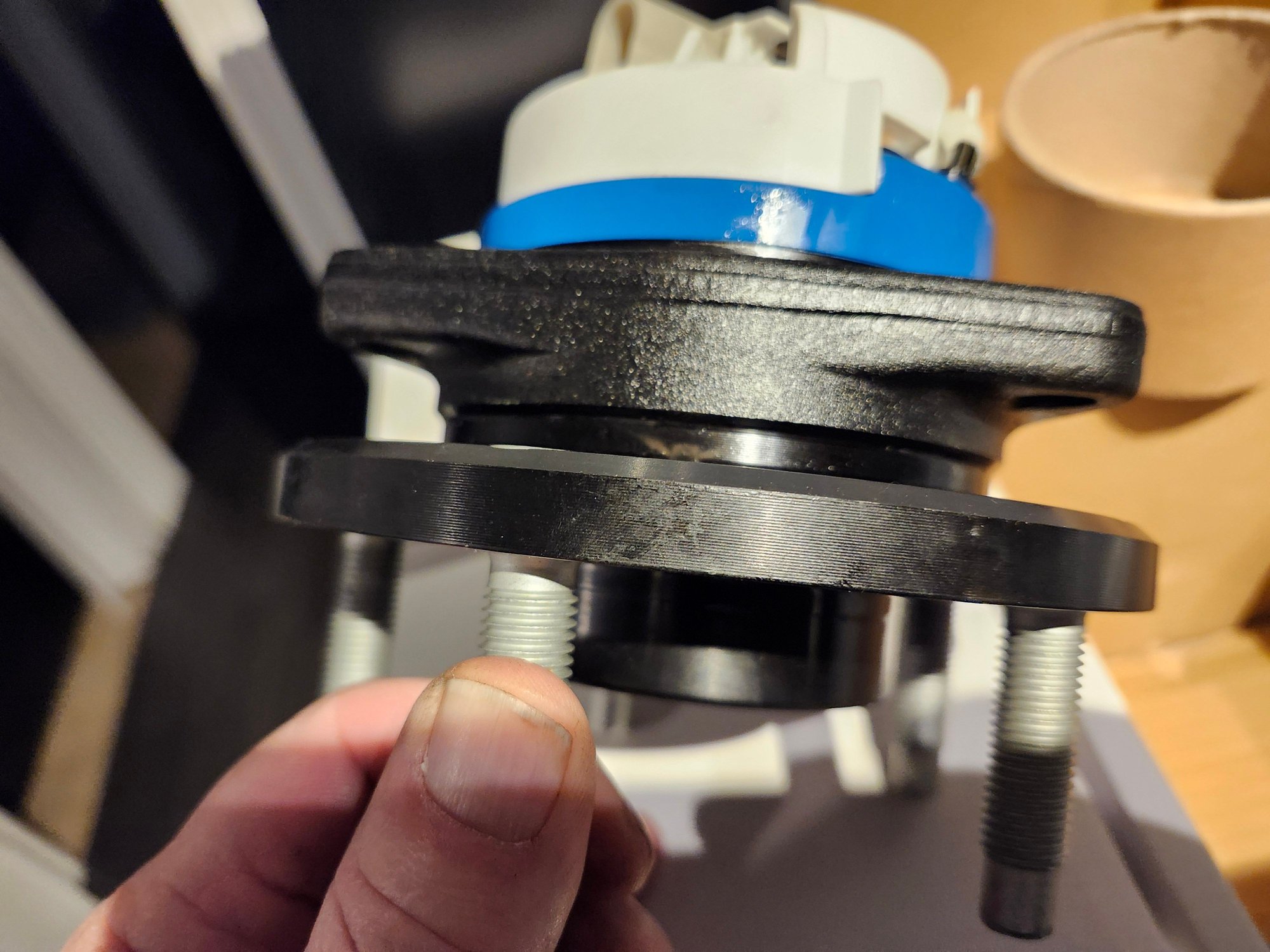

Originally Posted by 2002 C5
I looked into them, I've seen reviews where they do not last as long and have leaked.
MPI released a new, more robust version. They told me that these were extensively tested and vetted by test engineers. Just finished installing mine over the weekend. We'll see how these hold up.
New
Original
Is there a different part number for these or is it an update?

Unsure if the part numbers were updated
Originally Posted by Monty23
Any status updates here?
Are these MPI hubs holding up to the abuse of a track car?
Too early to tell - I only have about 5 or 6 sessions on these hubs as my last 2 track days have been cut short due to unrelated failures. My ABS codes and traction control issues haven't made a comeback, so that's a plus.
