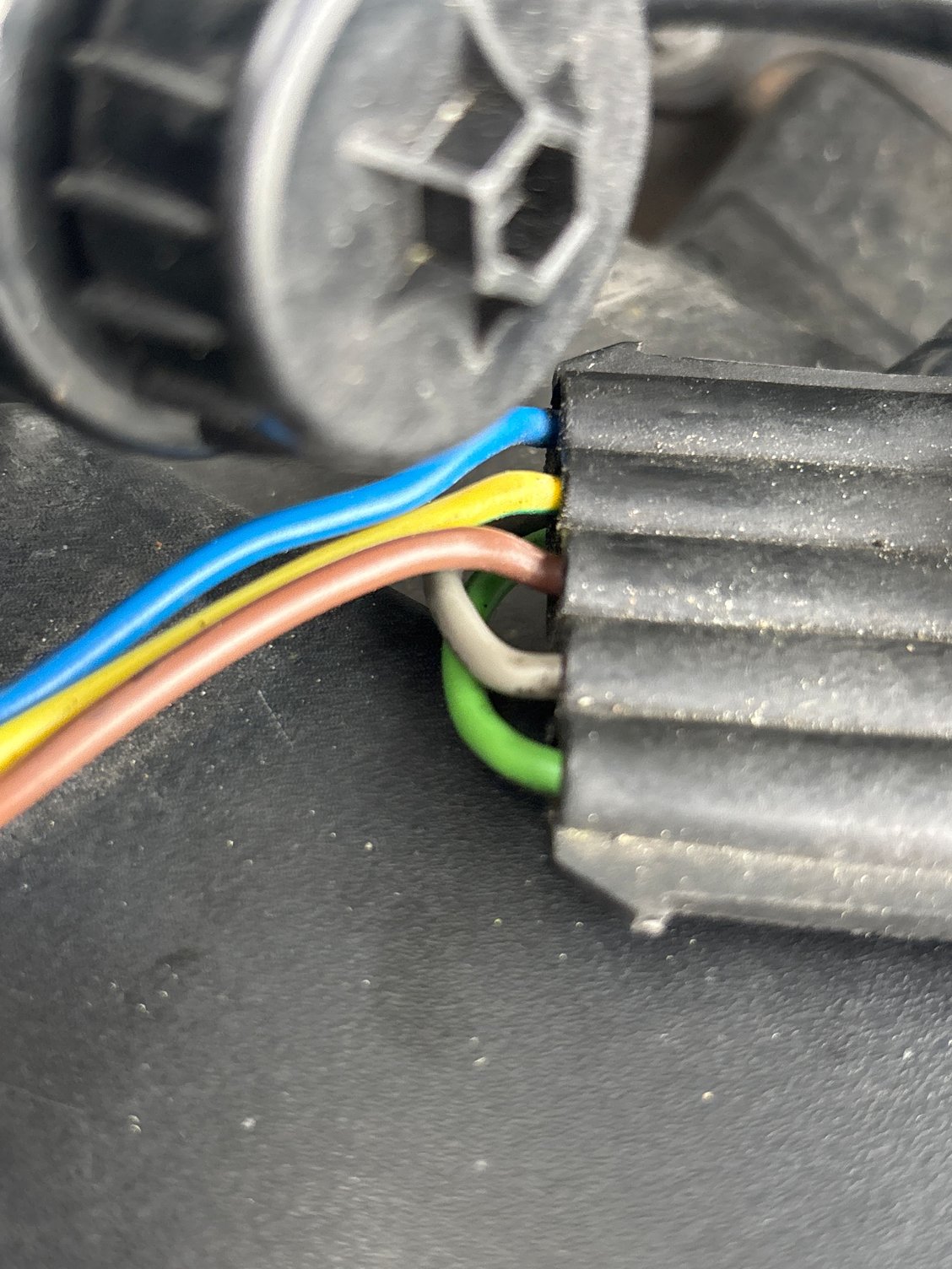

2000 c5 base. Headlight USED to pop up and down when switching on and off. Saw some things about the bump stops and changed them. Now the motor doesnt even work at all. Lights on but no movement from pop up

Does it make any noises? Grinding? I just had to replace my passenger side headlight gear.
Probably need headlight gear rebuild kit.

no noises just nothing

Connectors get pulled apart while putting the bump stops in? I would check there1st.
Or the brackets could have gotten behind the stops but think the motor would still be making noise trying to open?

So what do you think is the next step? Check fuse 4 in the underhood fuse box? Check for 12 volts and ground at the door control module?

bro you saved me lol. Was touching the wires and this little green one seem to have slipped out. Pushed it back in and it works!

You have to make sure the pin is locked in the connector or it will happen again. Give the wire a light tug to make sure it's seated.
