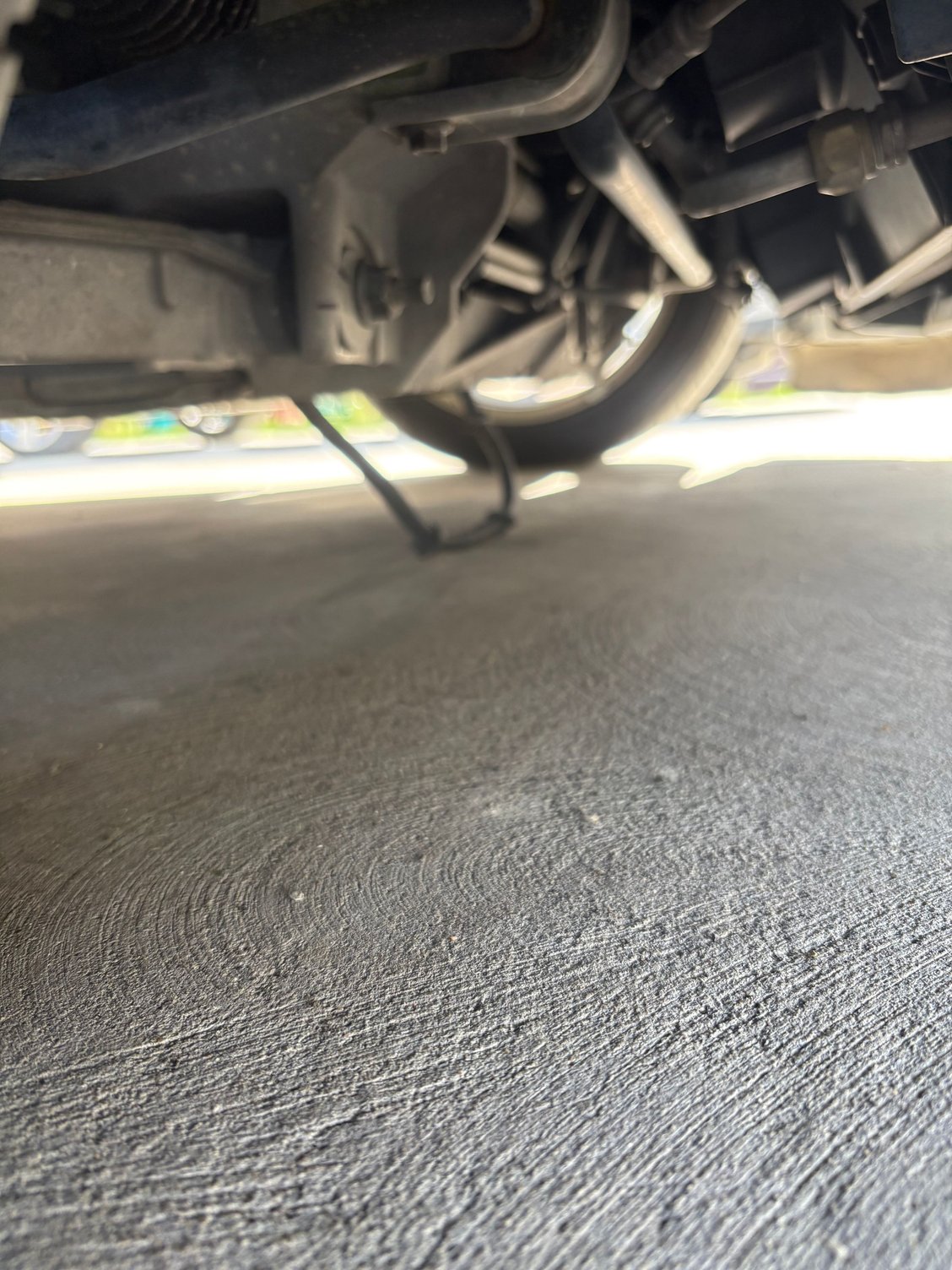

I was looking under my 2003 coupe this morning and saw this wiring harness hanging down, touching the ground. Where does it get tied up/attached? Pic was taken from the passenger side in front of the front wheel. TIA.

That looks like the steering rack harness that should be tucked in the cavity of the front cradle. It is held in by a few push-in wire loom holders

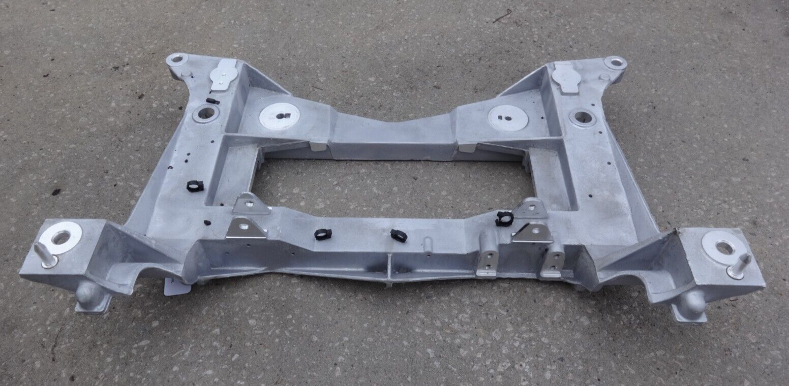

I tried for a while to find the harness installed but was not lucky
Here is your front cradle, do you see the push-in wire harness holders?
That's most likely where that needs to be. You will know when the car is properly lifted and when you go under to investigate

Awesome. I’ll get it up on some jack stands and check it out. Thanks!
