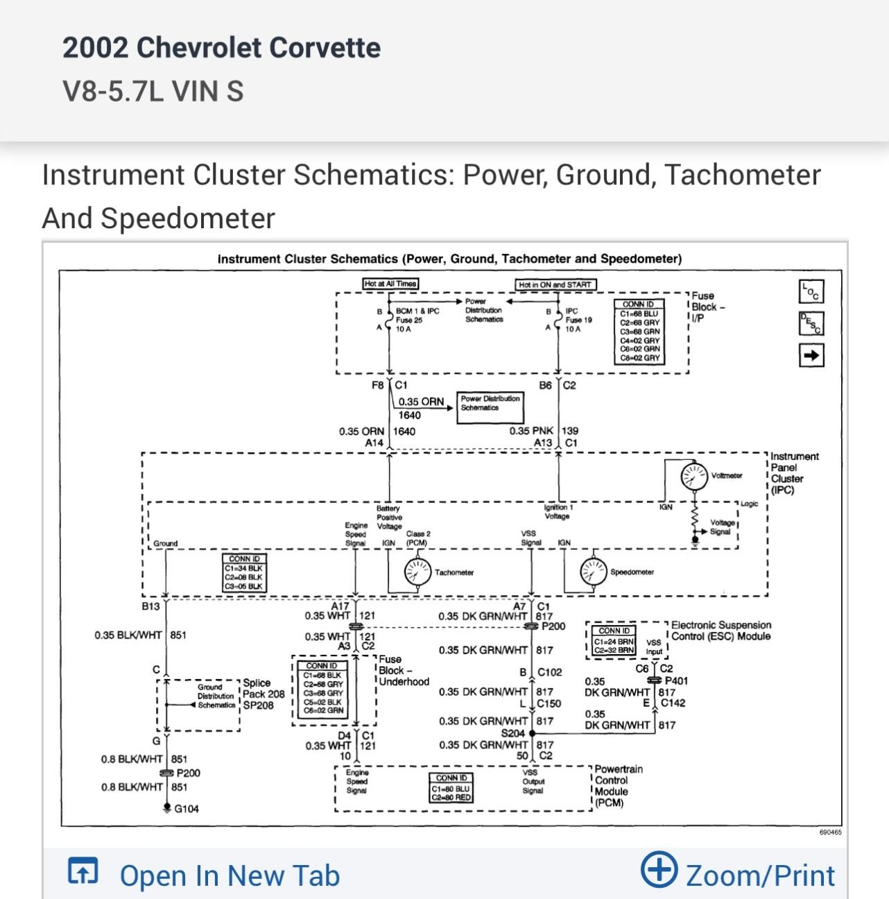

First, sometimes when I turn the key to run without starting the engine the cluster flickers and fails to illuminate. Once I got a "Low Voltage" message in my DIC. Battery is fully charged (12.6VDC). All other electronics (climate control, radio, power outlets etc) all work normally. After starting the engine the cluster returns to normal like nothing ever happened. So my question is, how is the cluster powered? Does it run off of a relay (like my 300ZX, which I had similar issues with) or does it get power from the ignition switch? And why would it return to normal every time after starting the car?

Although I have not experienced your exact issues, I have had many start/no start/almost start issues all the result of a bad ignition switch. Just replaced the switch again. Second one in 6 months. My go to mechanic opened up the brand new one in GM boxing and found the connectors not making contact. He did his fix and hopefully it will work for longer then 6 months.
