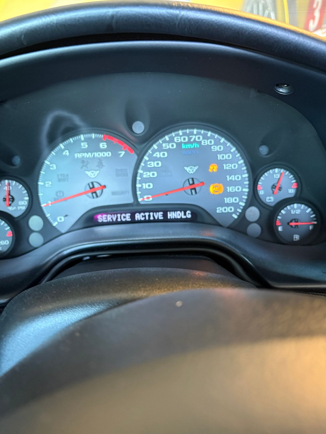

Hi Forum. Hope you can help a Danish Corvette C5 owner. I have a 2001 convertible with an ABS/Traction control fault.
When I start it, this error message appears (see the first 3 pictures) but if I turn off the car when it has warmed up and start it again, the error codes are gone again and the ABS + Traction lights are off again..
The mechanic has put a tester on the car ... (see the last pictures)...
We don't know immediately what to do, can the Forum help with what is wrong ??// Brian from Denmark

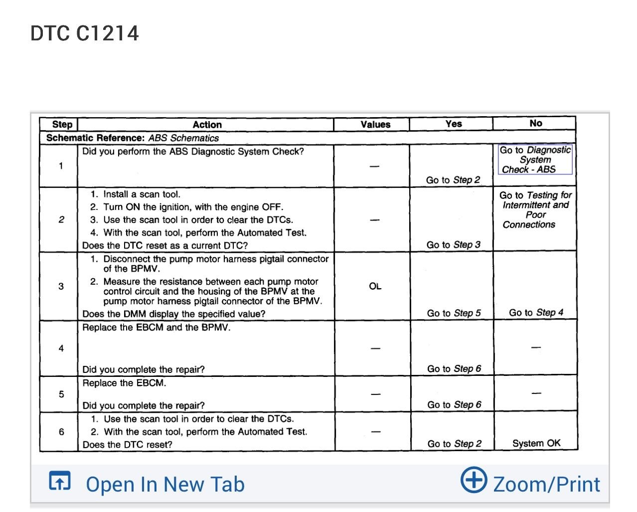

Here is how to diagnose your 1214…if your mechanic can’t perform the steps below find someone who can !!

EBCM relay has cracked/broken solder joints. It can be repaired. One of if not the most common problems of C5. Search this forum or google C1214. If you are not comfortable repairing it yourself, look for a repair center that specializes in repairing automotive electronics.
