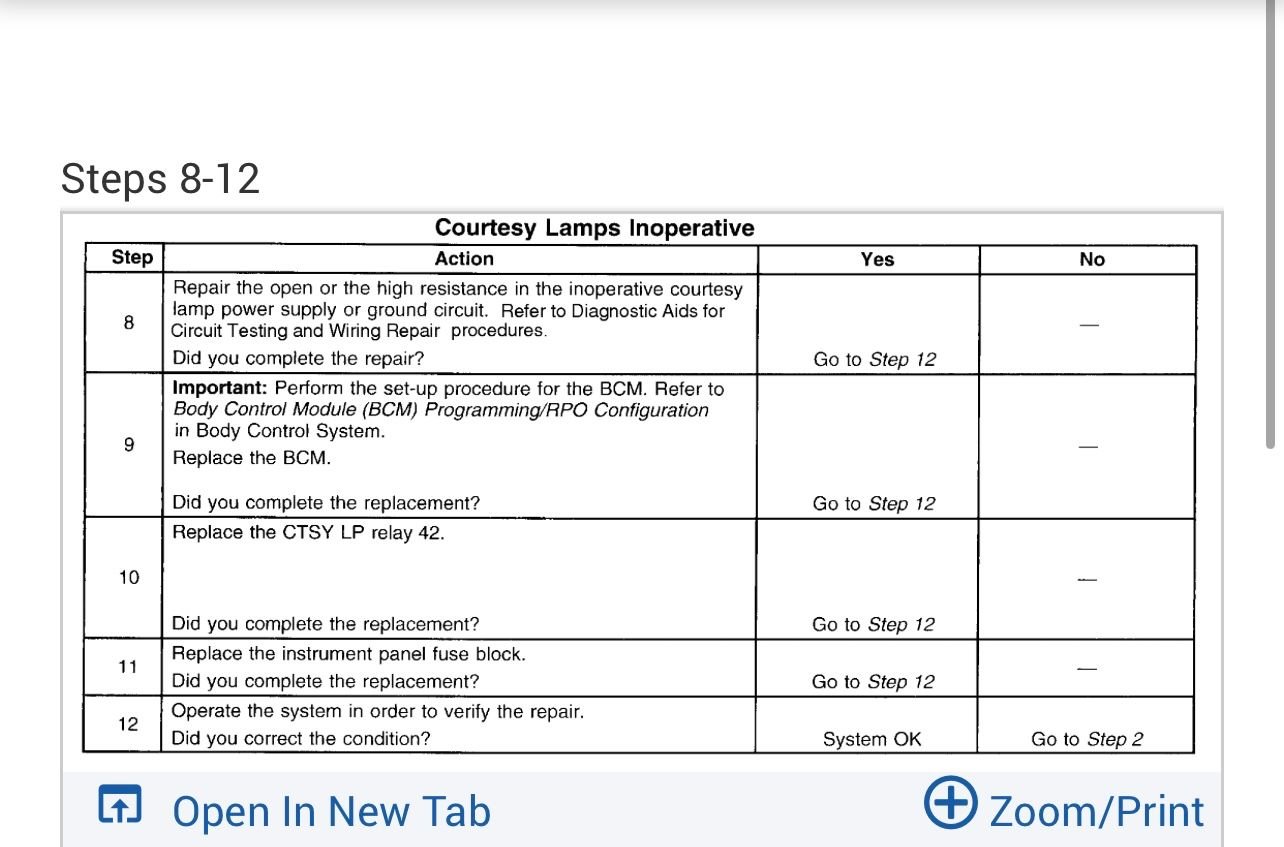

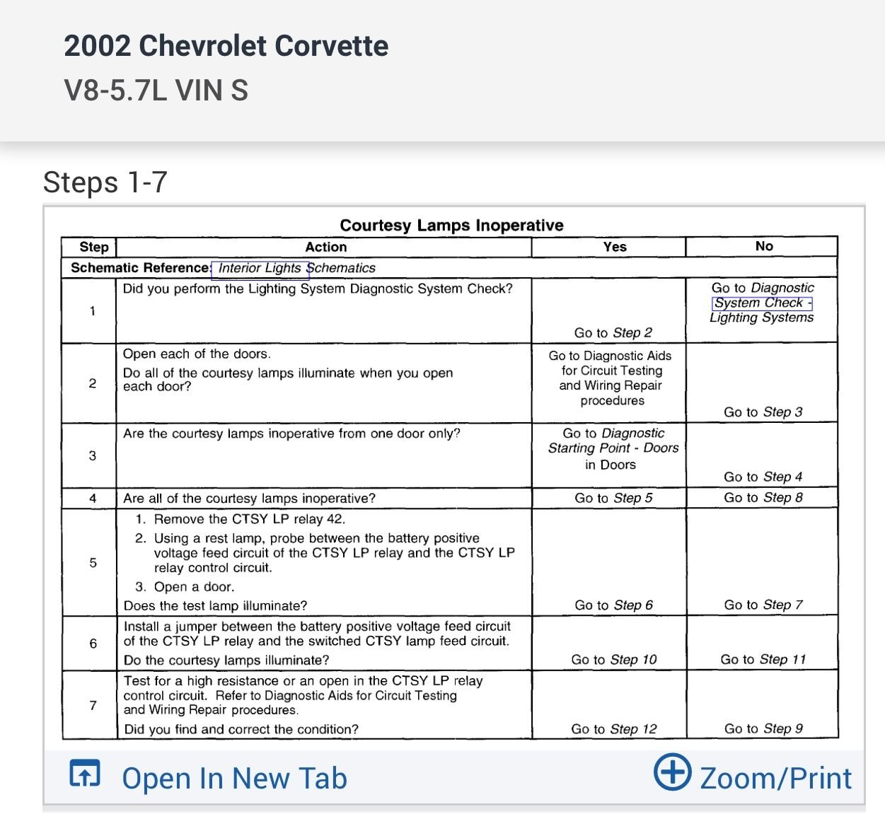

If all courtesy lights are not working and your electrical skills go beyond replacing a fuse follow the steps starting at 5…good luck !!…on step 5 it’s “test” lamp not rest lamp.

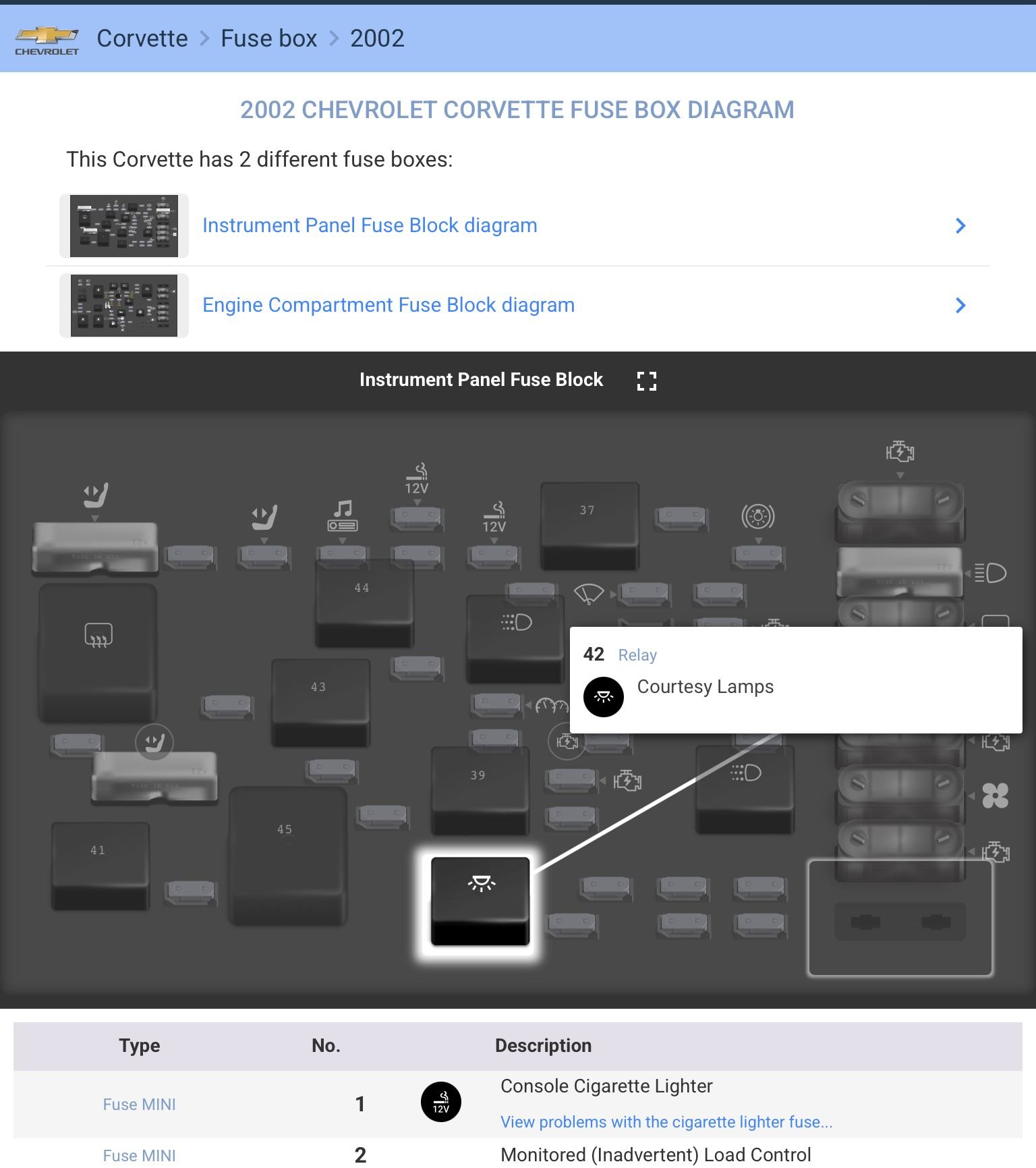

This shows where to find the relay
https://www.startmycar.com/us/chevro...o/fusebox/2002
