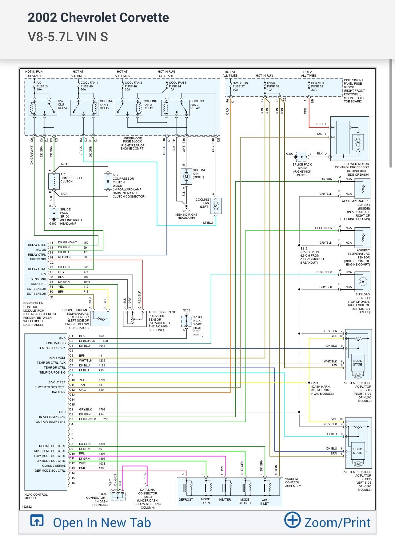

Hello, good afternoon, I have a problem with my 2002 Corvette C5, the HVAC doesn't work. I bought a replacement on eBay and what it does is that when I connect it, it turns on the AC, blows a little air, and then it turns off instantly; that's all it does. The buttons don't work, the screen doesn't work either, the only thing that turns on are the HVAC lights.

You bought one from Ebay ??…that’s probably your problem…you should check your powers and grounds at the module.
