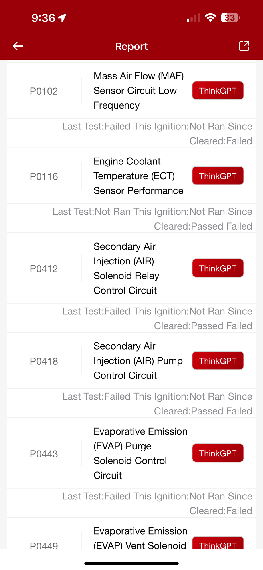

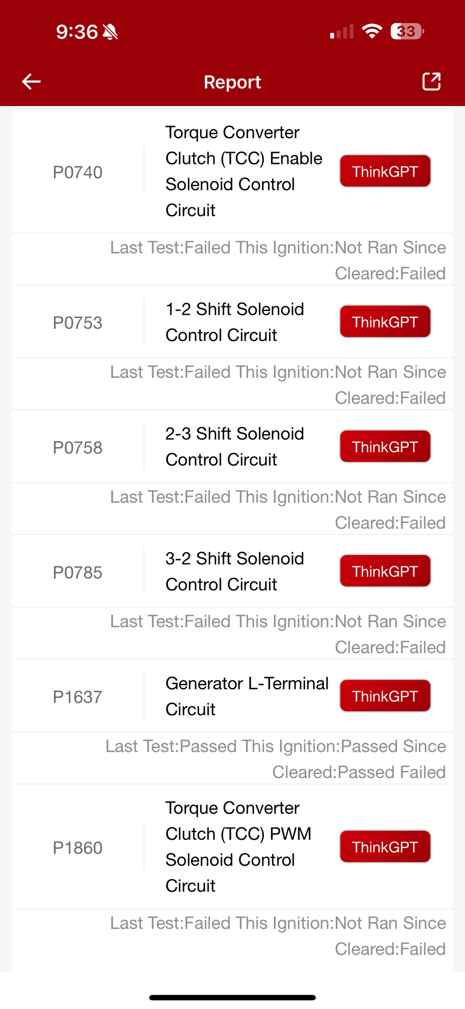

Don’t know what happened or why but I am getting mad circuit codes and I changed the solenoids and such. No one with the same direct issue and idk where to go next. I’m fixing pieces which seem to lead to grounding, possible battery issue, possible alternator issue, broken PCM, just a bunch of stuff but nothing that tells me what will
fix these problems… but what I do feel like is certain it’s some sort of electrical issue?? Only because I changed the parts that it threw codes for but the problems didn’t fix.
not modified aside from now has coil overs. It’s a 2003 anniversary edition with the suspension option. The 4 corners have the 10ohm resistors to allow 80+ driving BUT I now can’t go over 80 with the issues I’m now having but it does not throw a code for the suspension!
help
-Big Wes (or Swaggz if you’re local to DE)
oh and by the way it’s not just codes sitting, when I do reset everything I get into 3rd gear and it no longer down shifts so I’m in 3rd gear unless I clear codes and reset. Yes even when I let the car sit over night. I’m always in 3rd. I’ll post live data as well in a bit

Looking at some wiring diagrams the MAF, EVAP Purge, EVAP Vent, and both Secondary Air codes may be related to Ignition Relay 42 or even the ignition switch...if you have a DVOM and know how to use it I'd hook one lead up to battery Positive and the other lead to the Pink wire which is the 12 volt feed...do you know how to back probe a connector...if so back probe the Pink wire while the engine is running and note the voltage drop from battery positive through the ignition switch and Ignition Relay 42...you should only see 0.2 to 0.3 on the DVOM...if more than 0.5 you have a big voltage drop either on the ignition switch and/or relay.
