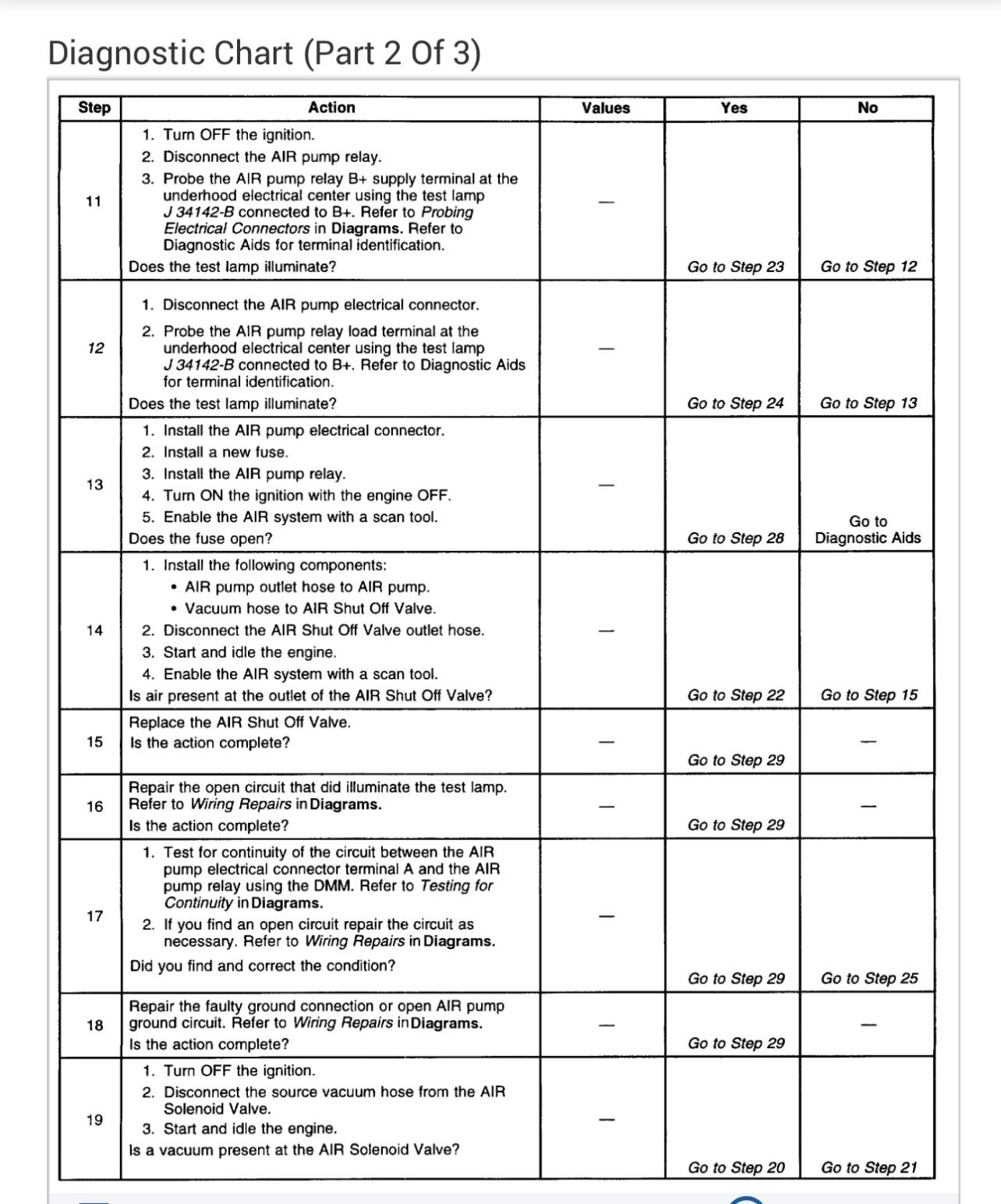

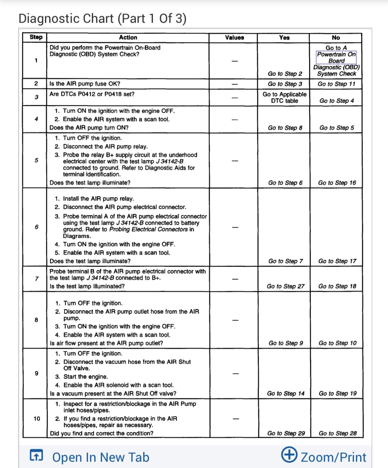

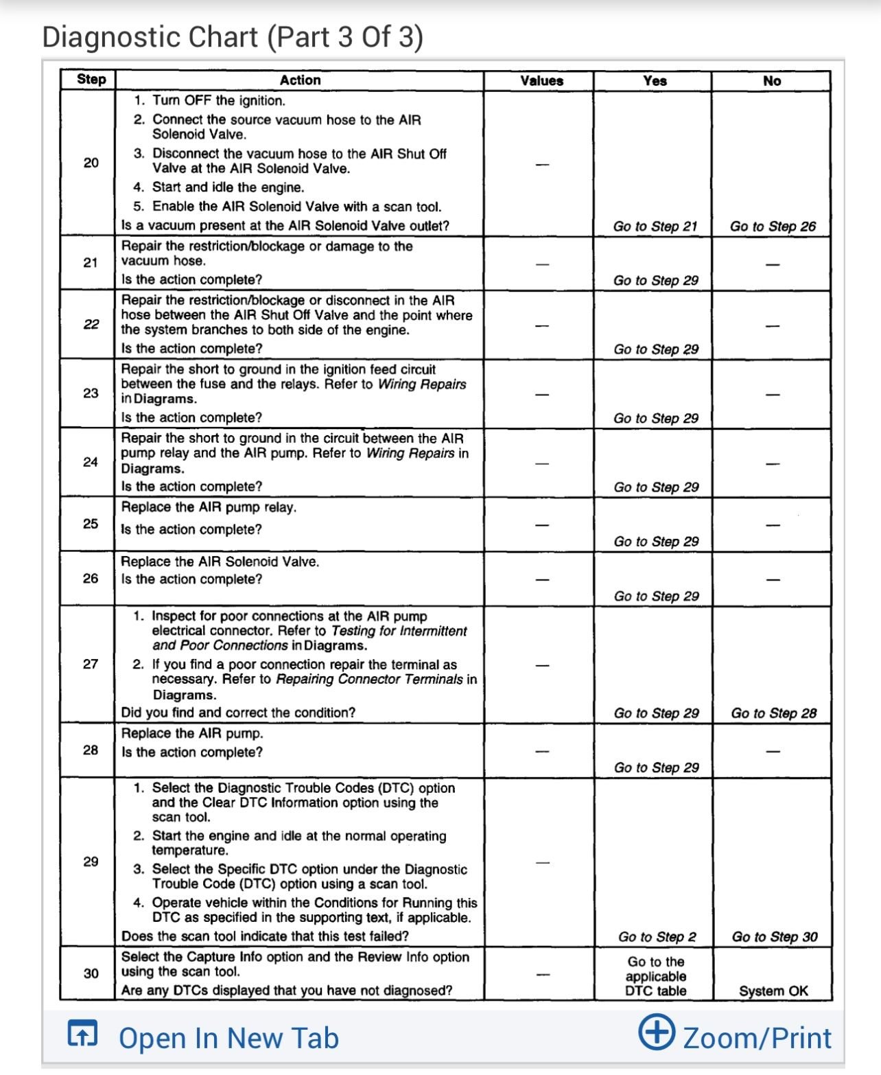

This is from factory Service Information and what a dealer tech would use to diagnose this…
To 2003 C5 codes
