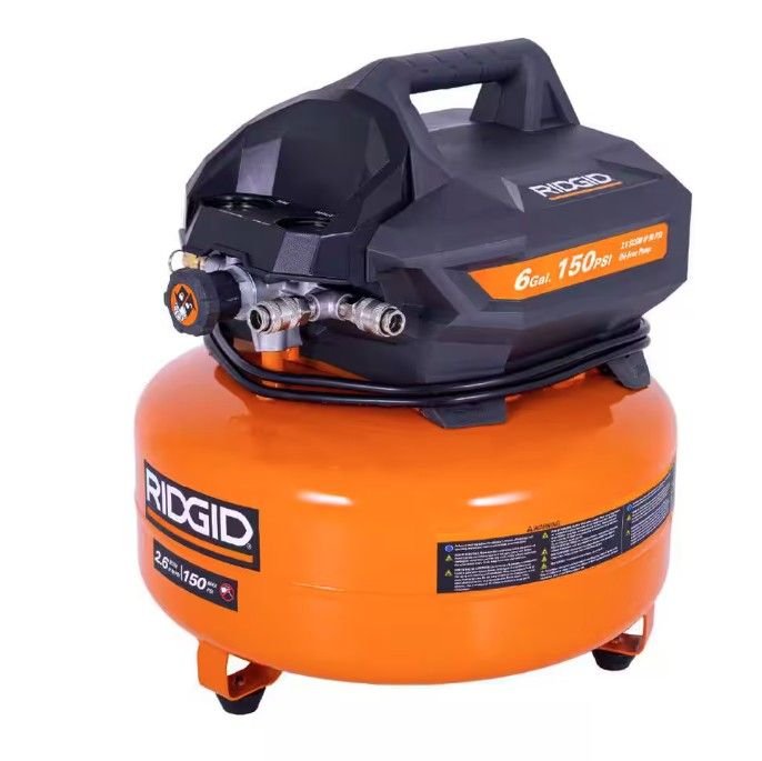

Originally Posted by RiverBoy
Any tips on how to tap new holes/clean them (I don't have an air condenser, but I could buy canned condensed air maybe, unless it's a bad idea)?
An air compressor is a minimum requirement for this type of work. Probably a good idea to know the difference between a compressor and condenser.
Condenser
Condenser
Compressor
Compressor
