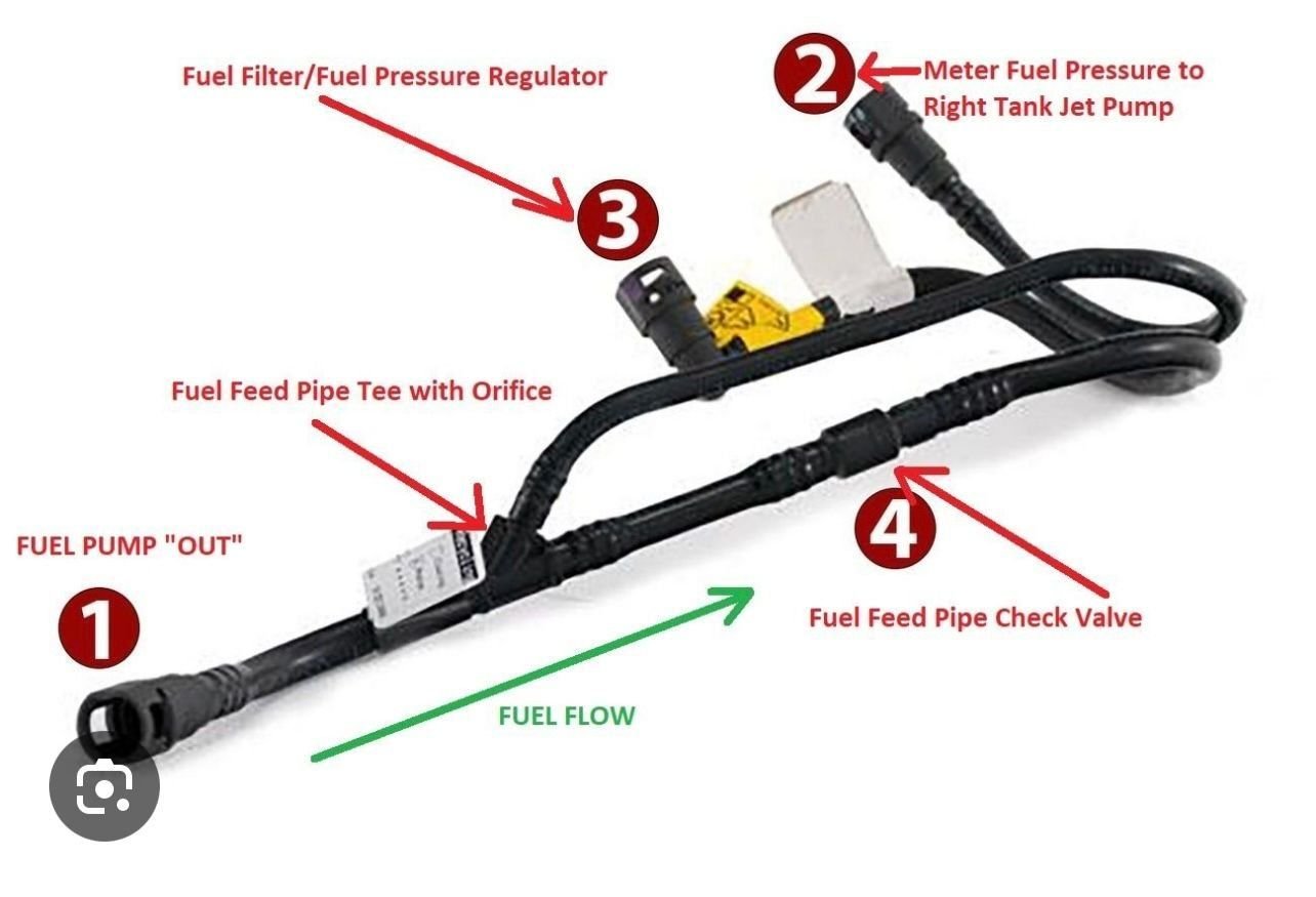

I dont believe they are. The check valves should be integrated in the fuel pump assemblies. To prevent tank equalization / easier & faster engine starting
Sometimes what we believe is not always true, or applicable to all years.
Like this example before FFS....
i too ran into that jpeg online. When i glanced at it i remember thinking it was not oem. I have done several sensor swaps on my 50th anniversary z06 and a few on my zr1. My life got way easier never going below 1\8th tank if i could help it and also staying away from the fuel company that uses much techroline..... shell and petro canada have been no problem. Knock on wood lol. Dont want to jinx it
