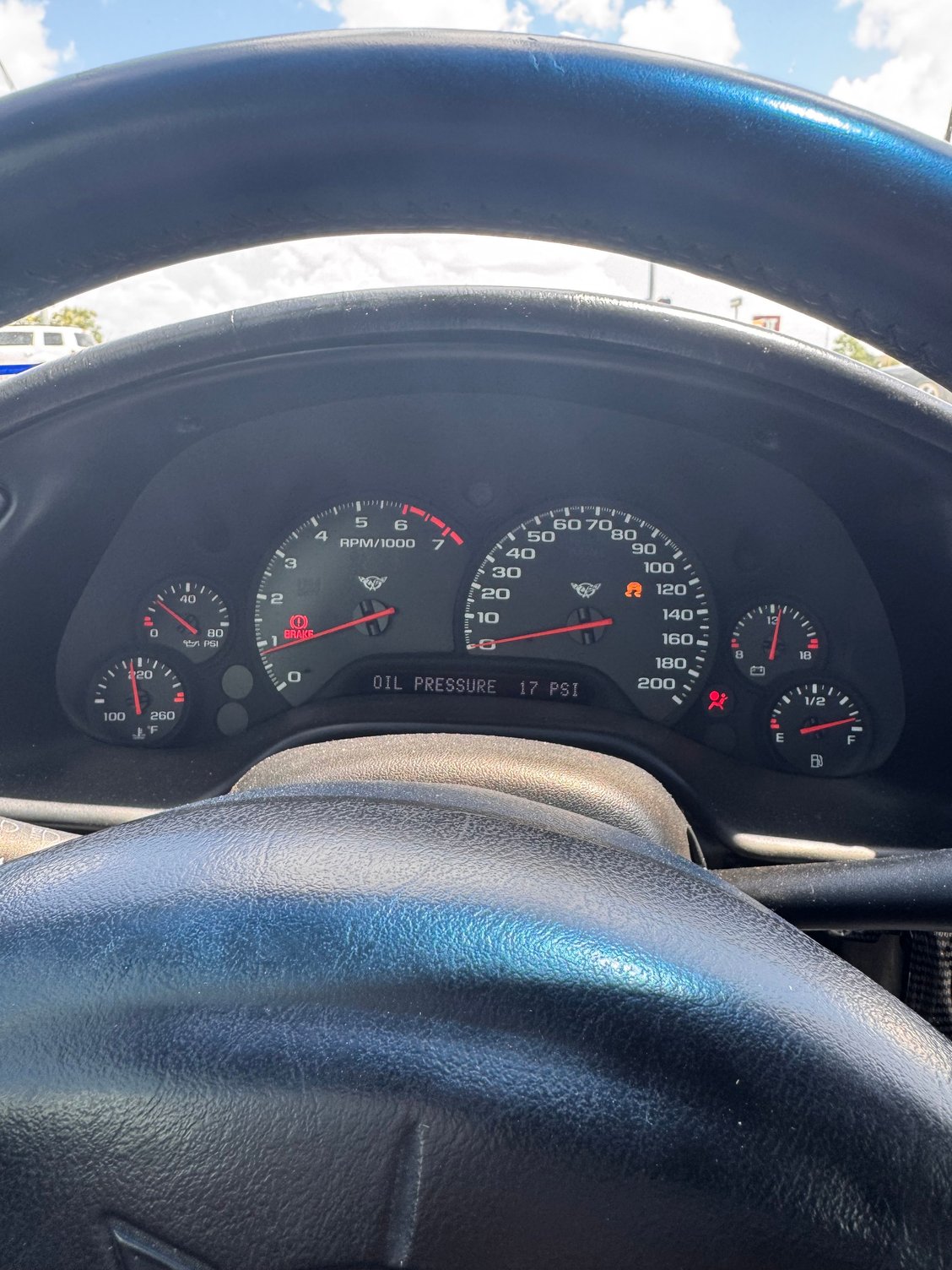

Hello, I own a 1999 c5 corvette ls2 swapped. The oil pressure reads low (very). At 17 today around about 220 oil temp. Is this an oil issue, sensor, or I am toast?

You are the only one that can answer your question. Use a mechanical gage to measure your oil pressure and compare it to the oil pressure sensor read out.

"Typically" when a sensor fails, it will read zero or pegged to 80. I doubt it is your sensor, but it is possible. Above solution will confirm, manual verification of pressure.

Agree on the sensor probably being OK. Questions: who installed the pump? GM crate engine or built? How many miles on engine? Shooting in the dark here, but thinking the pickup O-ring has been cut/compromised, or the wrong one is installed. LS pump pickup tube is like a straw. If there's any entrance of air above the oil level, you'll get the result you're getting.....

17 is not so low that I would expect catastrophic failure is immanent but it's lower than typical.
First thing is check the level and make sure it's full. You might consider pulling a sample and sending it out for analysis. That would tell you if it's the correct viscosity and might indicate some wear issues.
If it comes up with rpm I'd probably keep driving it, gently.

What does your pressure do as you drive? While 17 PSI is lower idle pressure than typical, it's well within the 10 PSI/1000 RPM rule of thumb. You likely have more than 20 PSI at 1000 RPM, 30 PSI at 2000 RPM, and 40 or more at 3000 RPM. If so, what, me worry?
What oil are you running, and how old is it? Idle pressure is definitely affected by temperature, viscosity, and age.

so 20-24 psi at 2k, but it doesn’t go up from there while cruising. I use 5w-30, oil it’s a week old, new filter. Although, on cold start is 40 psi. Then when it gets hot (220-230 F) it just doesn’t get any higher in psi, I live in Texas.

Next step is compression test, see which cylinder(s) are low.
If it's using a lot of oil (more than a couple quarts between changes) and has low compression in one or more cylinders I'd be planning my next move whether that is repair or replacement. You can run a long time if it's not getting worse and you baby it but I would limit my risk wherever possible.

Hopefully someone else will post that you need a new oil pump or thicker oil, — and my first action would be a crankcase of 10-40.
My experience says bearings: main, rod, and cam.

What brand of oil filter was installed? Hopefully, not a "run of the mill" Fram. However, even a defective "name brand" filter could affect oil pressure, and it's an easy and inexpensive thing to change out, for the sake of verification....

1. mechanical oil pressur gauge sample from top rear of engine , compare
2. change oil filter for something quality / name brand / OEM, new oil
3. inspect oil that comes out carefully for debris and metal/plastic/etc...
4. Check o-ring in oil pickup tube / change it anyways , could be sucking air, common
Compression really has nothing to dowith oil pressure. It can tell you whether piston is damaged or cyl wall is damaged but these don't really have much to do with oil pressure other than the can cause shaving which you might see in oil , and shaving can clog things up, but the engine will develop blow-by and oil leaking and vibration/misfire/poor running as major side effects not necessarily low oil pressure.

How long have you owned the car? Did you do the LS2 swap? Has the oil pressure always been 17 psi @ 220F or was it higher say, two months ago and it has now dropped to this reading?

Going on two months, i didn’t do it. Yes it’s alway been at that when temp gets to operating. It however there. I recently replaced the oil pressure, no change except that it now the pressure gets higher in higher rpm’s. The other thing I found out was that I disconnected some vacuum lines and the pressure climbed up to 23-25. Maybe my vacuum are improperly routed.
