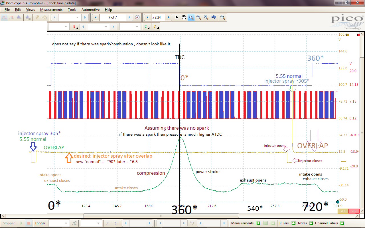

We've got to take a full 720 degree perspective on this issue. As the engine rotates, 4-stroke, the intake valve is closed most of the time. So the fuel is going to puddle on the intake valve and vaporize, absorbing heat from the valve, especially anytime injector duty is over say 18 to 25%.
There is no significant 'atomization due to injection' in those cases. And even if you could, you wouldn't want it; If the fuel injector energy supplied could atomize fuel instead of the heat from the engine, then running rich won't pull heat out of engine parts on gasoline volatile fuels - In other words, the more pressure/atomization is used, the less heat of vaporization is available from gasoline to pull heat from engine parts it comes into contact with. Not good! Gasoline like other liquids can remove heat from parts but only if it comes into contact with those parts as a liquid first.
2. When the fuel and engine is very cold, there isn't much heat to vaporize the fuel, so it can wash down the cylinder walls and create poor engine performance, stumbles/misfires/etc... So as the engine is COLDER the time for injection is SOONER before the intake valve opens...
3. Because injectors are typically 'too small' from OEM (they achieve duty cycles above 30% frequently) The only viable OEM injection strategy is to place fuel onto the closed intake valve, otherwise its a risk of spraying into overlap, which almost always guarantees poor performance, fuel wasting/washing, awful fuel smell in the exhaust. This is more noticeable with long overlap periods... A stock spray injection angle with a long duration cam frequently produces complains from customers "The car bucks and bogs at low speeds" & "The car trailer hitches at highway speeds" & "The car smells like raw fuel most of the time".
Thus, or therefore, Almost all/every if not every all OEM manufacturers drop fuel to the closed intake valve, and we have a pretty scope here for you to see
https://forum.hptuners.com/showthrea...l=1#post686870
On to aftermarket tuning and/or with way oversized injectors: Yes we can spray fuel post exhaust valve closed if you know what you are doing and willing to spray through overlap if/when the ECU(depends on the ECU) back calculates injection pulses that are longer than the intake stroke itself at high output... but you had better know what you are doing or it can have wear/tear long term issues with engine longevity/ health if fuel starts washing down cyl walls especially when the engine is cold. It can be even more troublesome when using alcohol fuels which seem to be more easily 'corrosive/oxidative/dilutive' to an engine/oil quality/oil system.
Some OEM Ecu allow you to move the timing based on conditions, but some like Gen3 GM do not. It can be a trade off for those.
here is a Haltech example showing how you can move the injection timing post EVC at high output To get a torque boost (just an example) And also back to post EVC Spray when at idle and low speeds to keep from smelling like fuel. The timing numbers are in BTDCC (before top dead center compression). So 440* is 440* before top dead center compression or a good 100 degres or so before intake valve opens.
Did I say torque boost? Ah yes
https://forum.hptuners.com/showthrea...l=1#post686907
I would argue that with my dying breath Boosted applications especially it is a VERY keen player - I have gained up to 120hp with injection timing alone on twin turbo setups below 3000 rpms Not to mention if when done correctly and at a linear retard rate with rpms IT WILL increase torque enough to rip the tires loose whereas it may not have before... Just takes some playing and getting right for the particular application.
This is a kind of, secret, because it has far reaching influence on engine health, and power output, and depending on the tuner and ECU you may trade one for the other sometimes. If you don't know what you are doing it can really screw things up. For educational purposes I will give a sort of summary
A. Spraying before intake valve opens = OEM strategy. Considered safe. Puddle fuel, vaporize fuel from valve, fuel becomes a gas before the intake valve opens. When engine is cold, spray happens much earlier. Never spray during overlap. Spray is back calculated generally from the latest possible spray before the intake valve opens. Spray pressure/atomization is not a factor in performance since the valve is closed.
B. Spraying after the intake valve opens = can be risky, but also may have benefits for large cam engines and certain types of intake systems. Air is a fluid and when fluid gains momentum, having a properly positioned injection spray burst can supplement that momentum/kinetic energy and increase engine torque. It depends how and where the injector is positioned and how its spray time *on* is tailored to work with the incoming air flow, or not. The spray can just as easily cause turbulence and lost momentum & lost power this way, stock engines may have losses because they do not depend heavily on flow momentum to fill a cylinder, stock tend to rely more on exhaust scavenging and intake suction (pressure drop from piston + exhaust to conserve energy = more economy).
It is an empirical investigation. Usually to see gains a very large injector is used to keep duty cycle down near 20 to 30% at wide open throttle so most of the spray can fit between exhaust valve closed, peak piston velocity, and bottom dead center (approx 320 to 220* BTDCC)
Pressure at < 100psi is not really a factor in any of this. If you had a competition where forced induction was forbidden and any fuel pressure could be used, you'd want say 500psi or 1000psi or something, it could be like a mini-supercharger having all that fluid blasting in at high pressure can help pull the airflow along. At our level of 40 to 80psi however the difference in energy input is negligible, instead the real key player is WHEN(timing) and for HOW LONG (duty cycle vs piston position) in conjunction with valve timing events can relieve poor drivability, fuel smell, and boost torque in the mid-range.
What is desired in reliability apps at high output is, reliability, so low fuel pressure = easy pump lyfe. Low fuel system stress. Long fuel system lifespan. Low heating of fuel and fuel related parts. And all of this also leads to increased fuel pump capacity for flow at high output which is safer. Setting up low pressure fuel systems can support high output with long life span. And all of the benefits of timing is still there - you time it right, use the right size injector, empirical test to find ideal trade offs depending on the ECU's capability. That is how you tune the fuel system really fully.

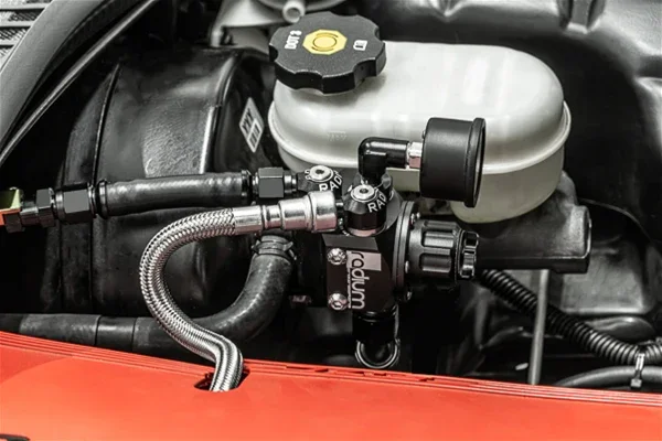

After that, he went for the Radium adjustable regulator with their mount (Link). The Direct Mount regulator on their website unfortunately doesn't work as a "Dead Head" style regulator in the engine bay as their support staff said, so he had to run a fuel line from front to back of his car but I expected as much. It works well, but if you key off you do have to key on and prime the regulator a bit since it's at the engine bay & drops pressure nearly instantly from a key off. Great from a safety standpoint and most of the hot fuel dumps back into the tank. He did revise his tune from the other regulator and made more power with the same fuel pressure but that could be other variables as well.

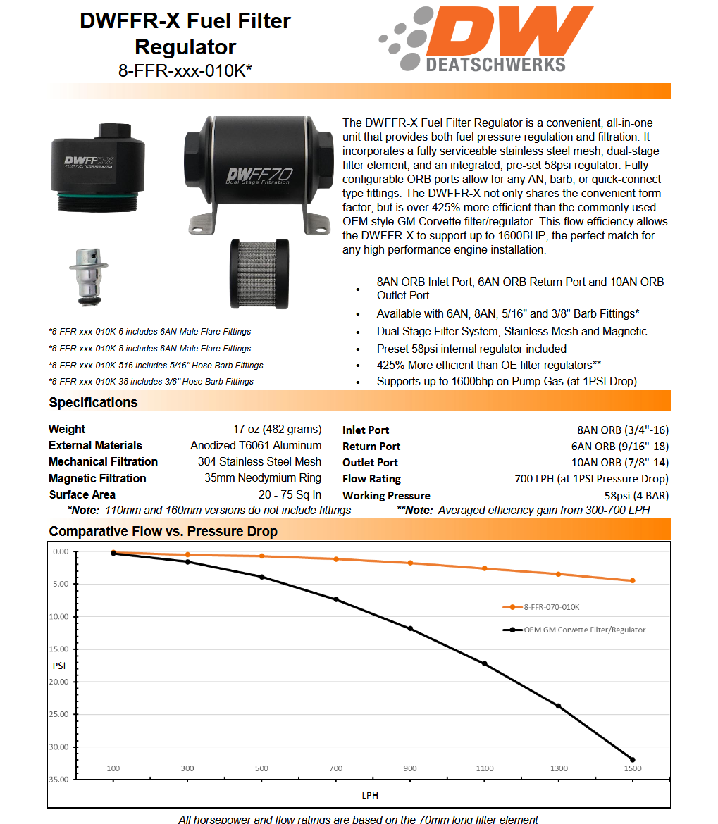

NOW we are on the cusp of an actual easy button solution.
Deatschwerks has a DWFFR-X (Link) which goes in the stock locations & is setup to be a simple plug and play fix with a serviceable FPR & easy to service 10 micron filter with your choice of size.
MY ONLY issue with it is their website doesn't have a proper 1 click solution. We need a 3/8 Male SAE Quick Connect to 8AN Orb for the Inlet, a Male 5/16 SAE Quick Connect Outlet to 6AN Orb for the return, and a 3/8 Female SAE to 10AN Orb for the Outlet to go to the factory connections.
But it's the most affordable & simple solution. I've emailed Deatschwerks Support about trying to get a All-In-One option on their website.
We have lots of options, but in my opinion this is the easiest option especially for stock ECU cars or things that don't need a vacuum reference fuel regulator.
