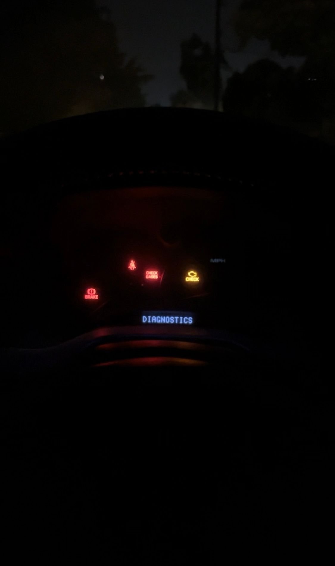

last night I was driving my 02 Z06 that I have had for almost a year now. I was in 5th gear and cruising (I was just cruising for the moment though, 99% of the time pushing it hard) and the engine just shot off; no loud noises, didnt feel any hiccups, just functioning like always (perfect in my opinion) and engine just shots off. I still had all my dash lights and everything though all the pointers on every gauge were stuck on random places and didnt move (until I stopped and shot off the car and they went back to shot off position). it still cranks, tried the next day and it does the same thing.
Codes the car shows me in diagnostics mode: (first time ever using this function, didn't even use it when buying the car)
P0342
P0522 (oil pressure sensor has been stuck on max since I bought the car, I should've changed it yes)
P1120, P1220, P1516. (3-4 months ago I checked for codes with Snap-On Zeus scanner and these three were listed as pending codes on there as well, and they did not cause check engine light).
P1637
C1282
B0605
U1160 and a bunch more of these door codes, about 20.
What do you think I should do? or where to start from? Personally, the most worrisome code for me is the Camshaft Position Sensor code (.
