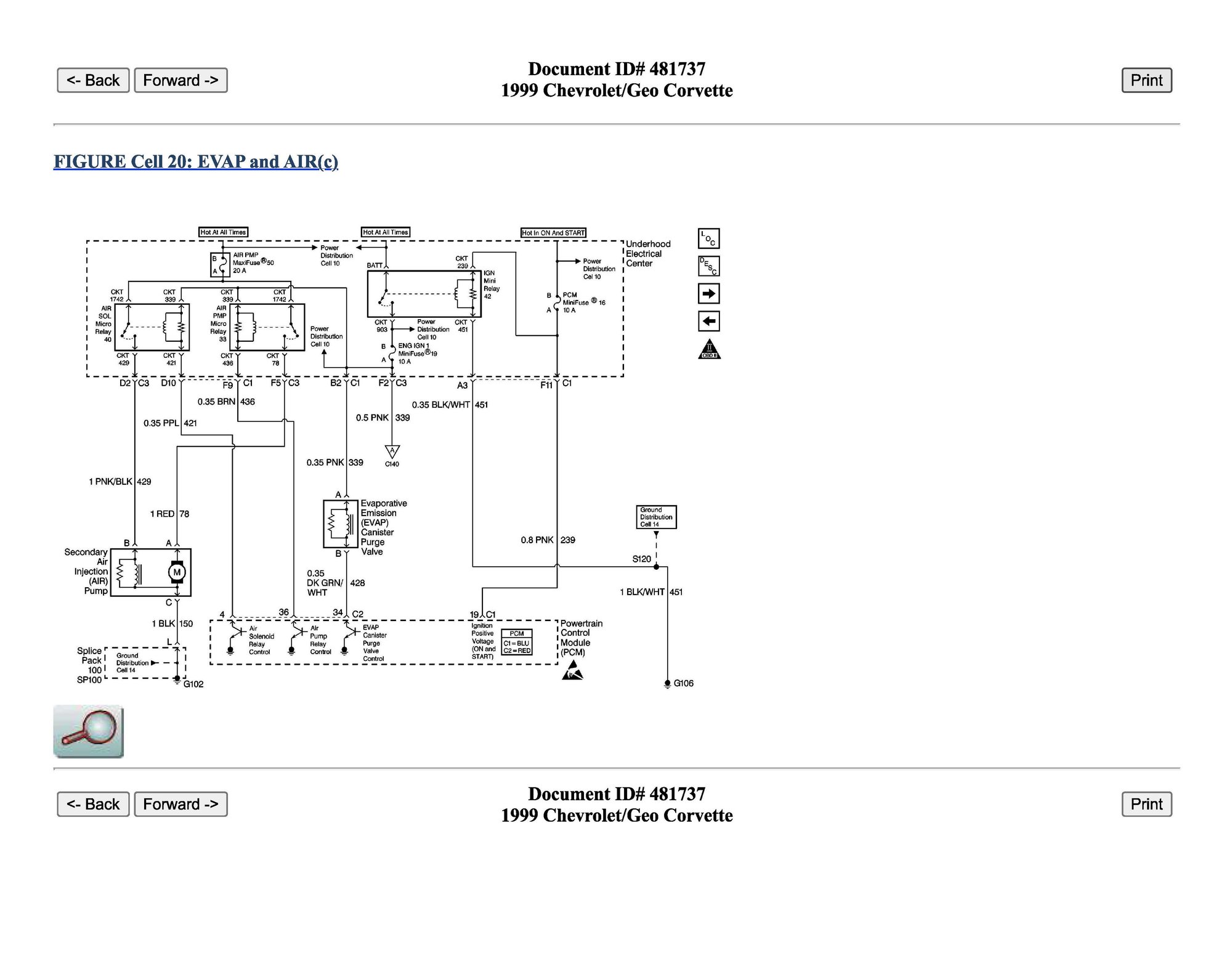

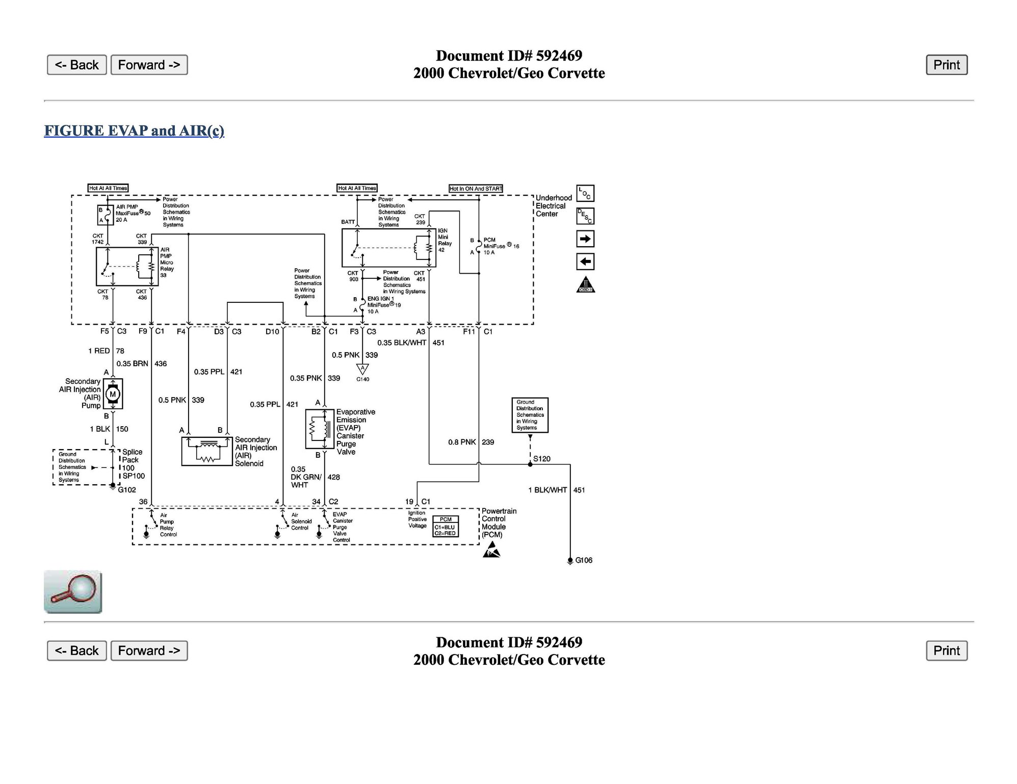

You fixed the issue, but you did not fix the problem. Did the customer not want to pay for the labor to correct the problem? You still have an unknown issue with the hokey previous repair….which will probably be the next failure point……..whatever that combination of elbow, zip-ties, and copper line.
Given the source vacuum was an issue, your customer should have also had issues with the HVAC, specifically air coming from all vents, not being able to switch modes, etc.
Your approach covers 2000-2004, but it is important to at least understand the differences with a 1997-1999.
On a 1997-1999 the shutoff valve that controls air from the pump to the check valves is integrated into the A.I.R. pump. There is a separate relay in the Underhood Electrical Center (#40) that is operated by the PCM to control the shutoff valve.
For the same symptom on a 1997-1999, where the pump runs, but you have no air to the check valves, it’s important to use a test light/load at the pump connector. I have seen numerous times where I have been able to command on relay #40…and read 12v at the connector….yet….it will not energize the shutoff valve solenoid in the pump assembly. Sure enough, connecting a lamp/load does not illuminate. In every case with this situation that I have experienced….relay #40 was bad.
Schematic for 1999 below( same for 1997-1998)…..and 2000 for comparison.

So, you're saying that replacing the relay might fix the problem? Oh course clearing the codes after the repair..this is a 2003 Z06 with 3800 original miles..thanks so much!!

So you make this difficult partner, because I asked you for specific codes. You provide none.
I specifically described the differences with a 1997-1999 A.I.R. pump............and you have a 2003
Relay #40 is not applicable to the A.I.R. system on a 2003, and you will find it missing from the 2000 schematic(also applicable to a 2003) I posted.
If you have a P0410 code, why not follow the troubleshooting in the video?.....it's well done.
