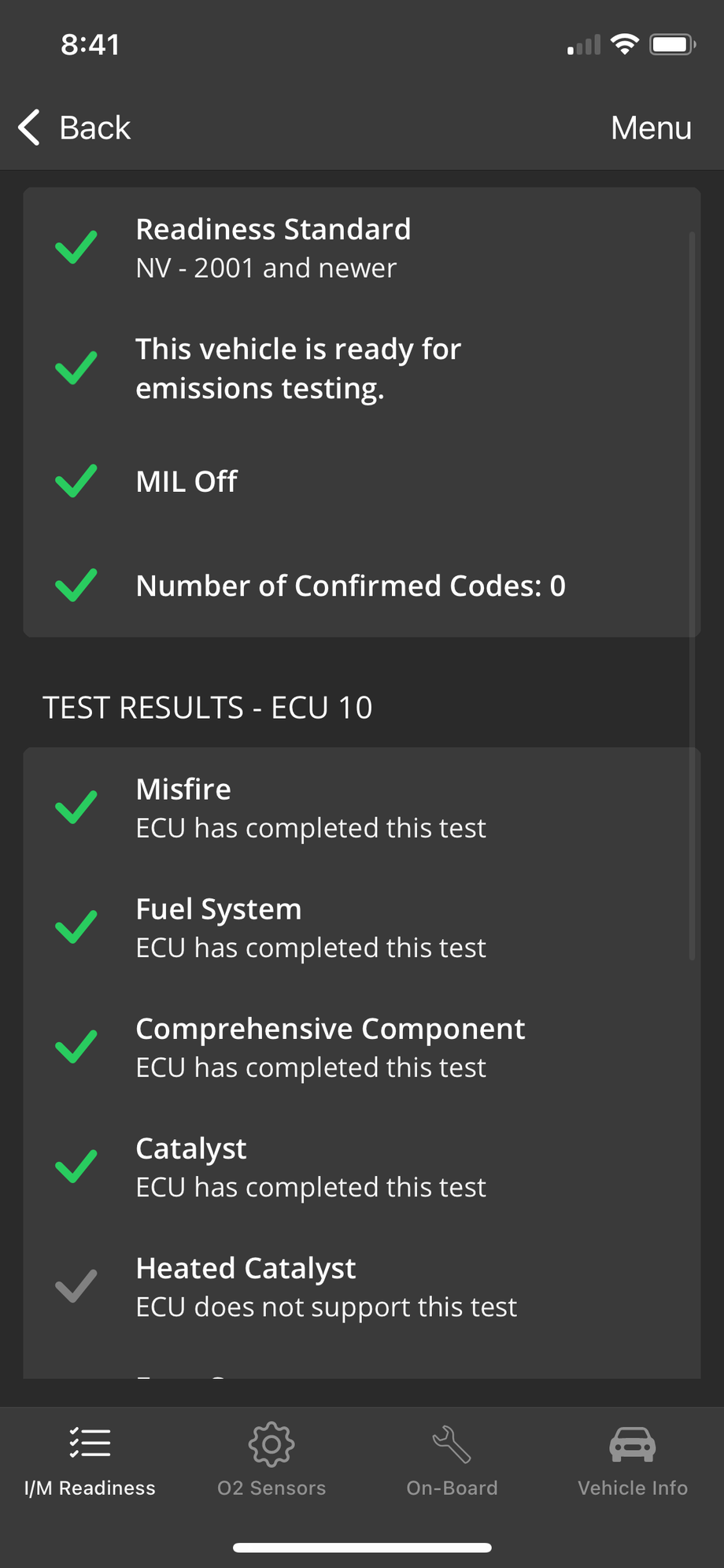

really didnt know where to post this, figured others have wealth of knowledge. anyways, in Nevada were allowed 1 not ready monitor and still pass. my question is are N/A or Not Supported monitors a fail or does it just read as that and they are good to go, ive included screen shot of my monitors. If I understand correctly I should pass, i wanna ask a smog tech locally but lil weary about it.
thanks for the help.
04 long tube headers full exhaust cats have been tuned out and a.i.r. pump been deleted

You don’t have a “heated” catalyst nor EGR or VVT…the hardest to run and pass is EVAP so if your state allows one monitor not to be completed you are fine.

thank you appreciate the response. i figured as much, gonna be applying for classic plates just wanted to make 100% sure
