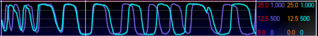

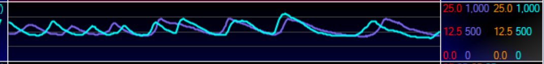

It was the o2 sensors. Either they were clogged, or something else was severely messed up.
Before, like in the log I posted here, they would not oscillate like normal. Highs of 700mV lows of 450mV
After I replaced just the B1 o2 I noticed that the oscillation was very different. I went and grabbed another sensor and now it looks like this (900-100mV):
The MAF readings are much lower too now because its not trying to compensate for this mess. Unloaded idle of 2600hz or 7.5g/s, and even at this reading the car want fully up to temp, so I imagine it'll be lower once its up to 200 oil 200 ct.
