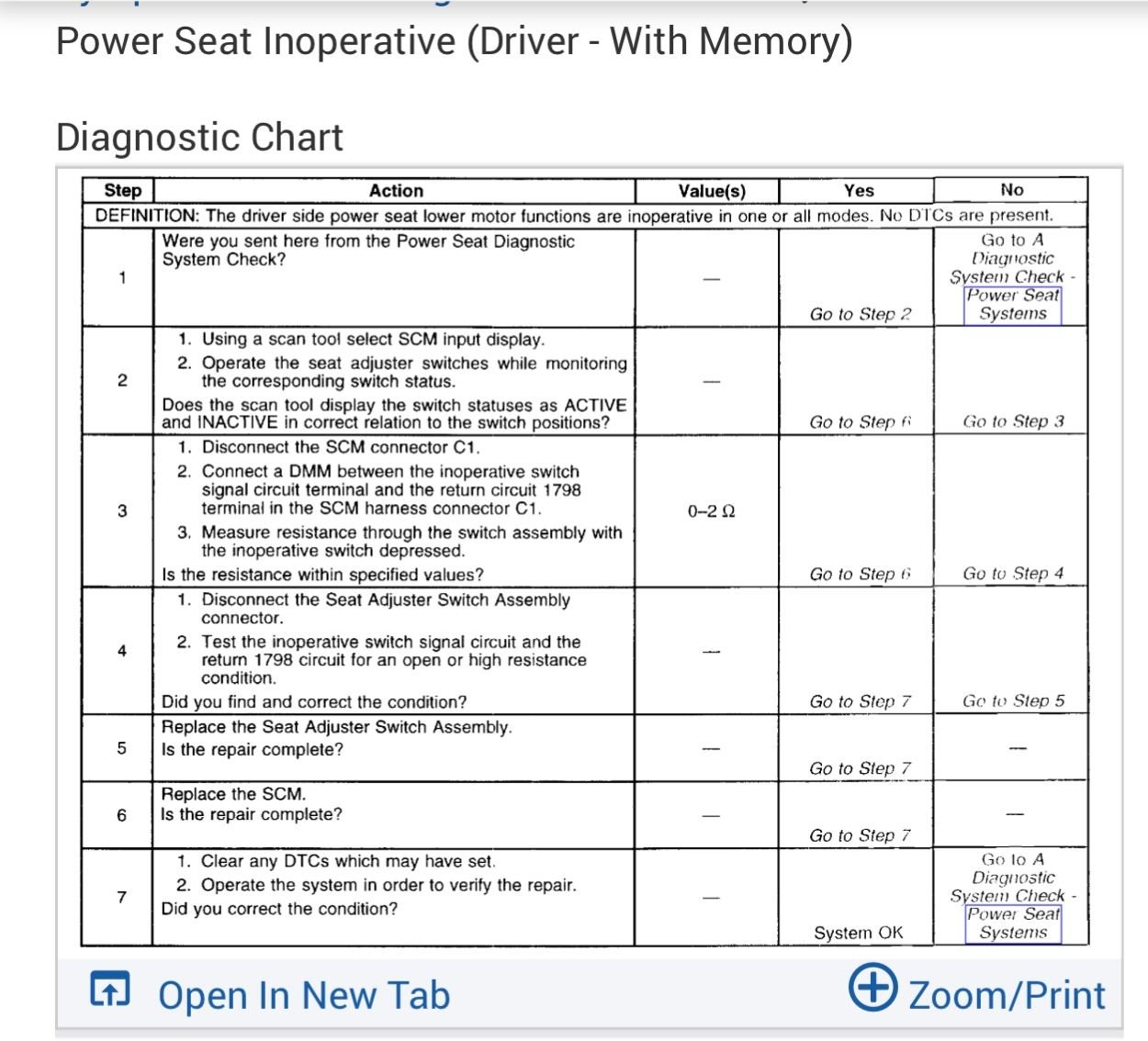

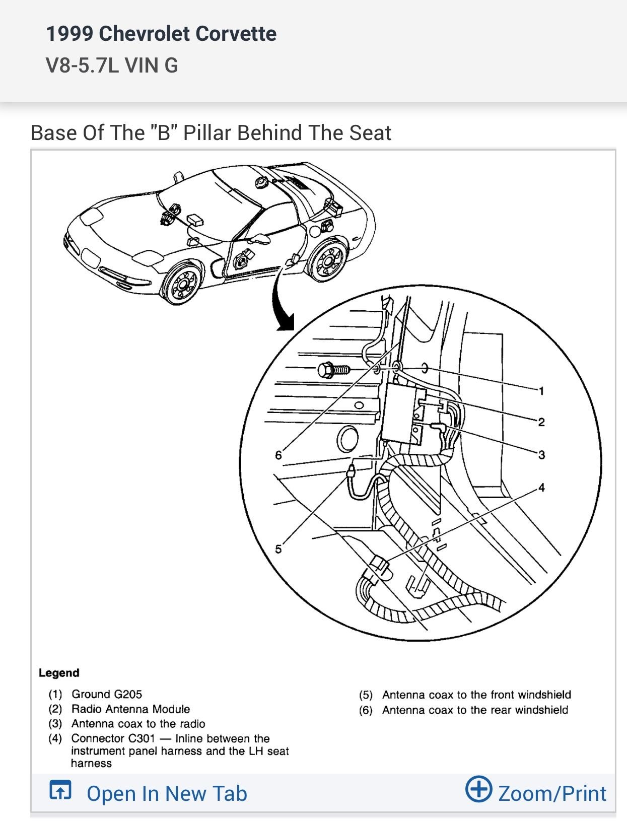

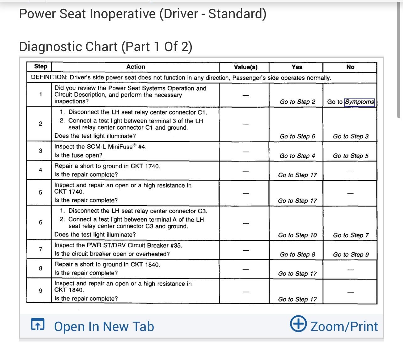

Not knowing if you have memory seats or not and you or your Bosch guy can follow the factory diagnostic troubleshooting chart below…helps to have a factory level scan tool or equivalent to check seat inputs and outputs….just having 12 volts going to the module tells you nothing !!…99.99% of DIY’ers don’t know how to properly check the ground circuit as well as professional mechanics…have you done that ??…good luck !!…if the seat say draws 1 amp and the ground circuit can not carry that 1 amp of current back to battery negative the motor will not function correctly or not at all.

G205.

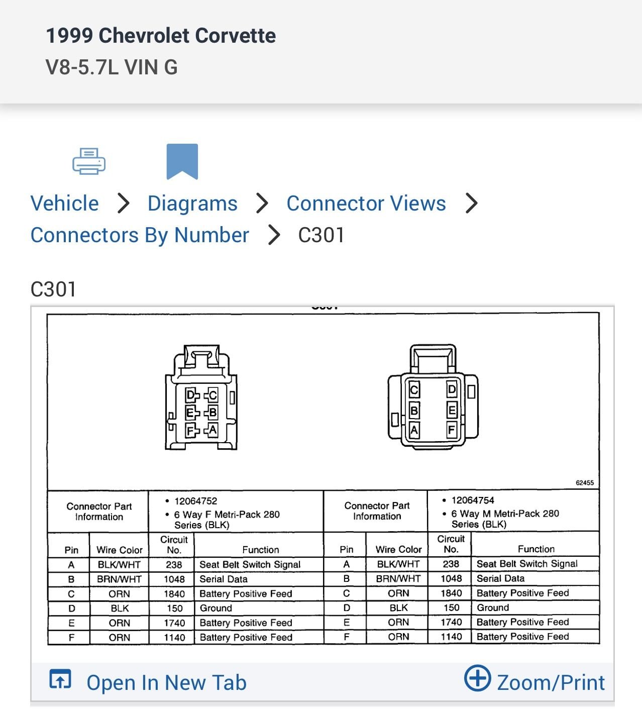

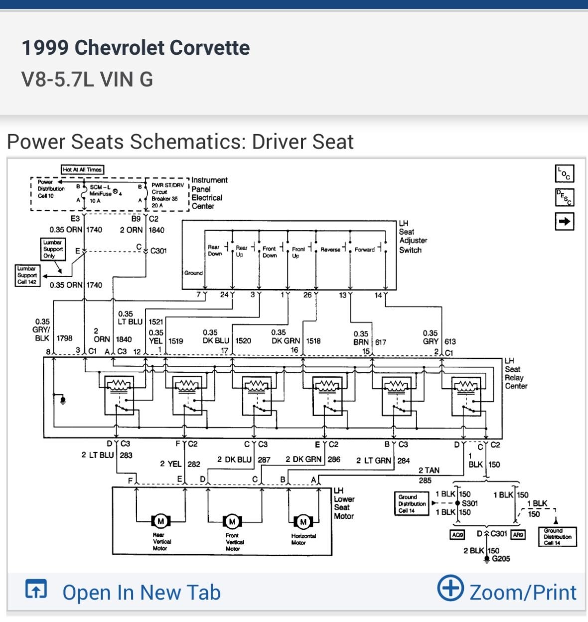

If you can interpret the wiring diagram C301 pin D is part of that circuit.
