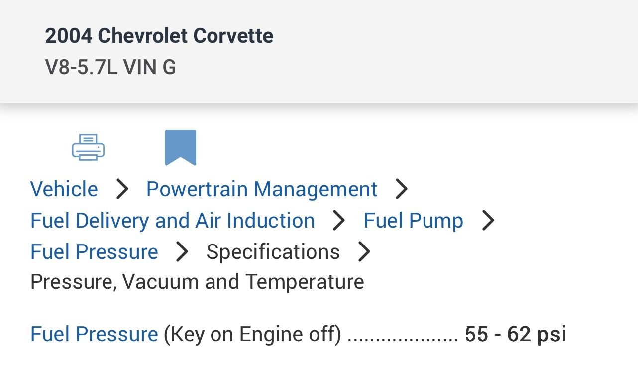

need the pressure guage. Have the otofix lite bi directional. Oh this is fun. Pressure at the rail should be 56psi?

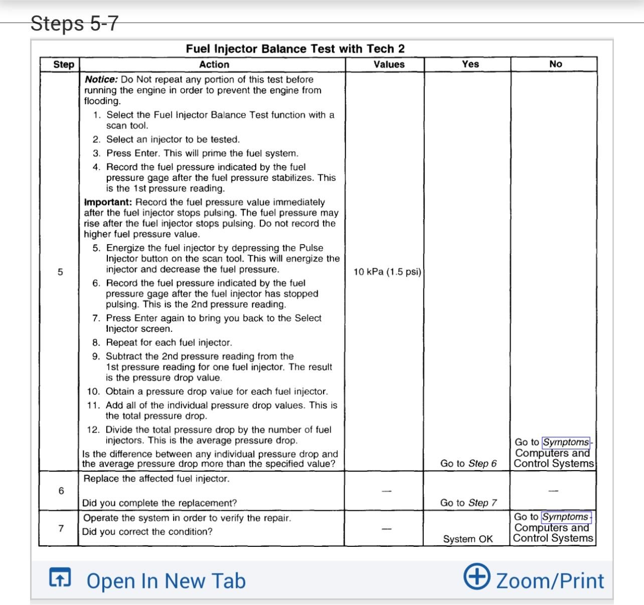

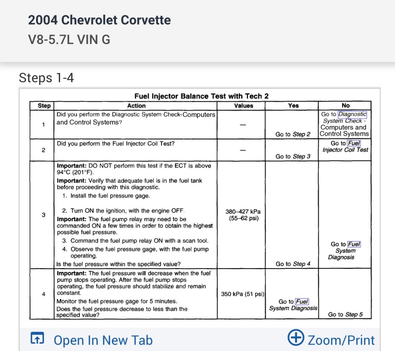

Very nice !!…here is the procedure to follow…just follow what the scan tools tells you to do…if you ever need diagnostic help down the road let me know…I use a pressure transducer these days when doing this test…more accurate and I don’t have to write the numbers down.
Old Aug 7, 2025 | 05:58 PM
Pauleyboy's Avatar
Pauleyboy
Joined: May 2025
Posts: 53
Likes: 63
From: Naples
very grateful for these details. Thank you

As mentioned above on step 2 a Fuel injector test should be carried out prior to the balancetest .
An injector with too high or low resistance may not operate correct and impact the pressure readings on the balance testing
