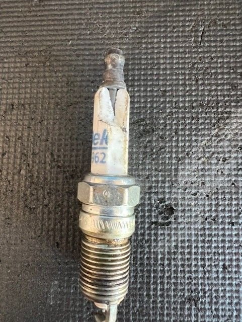

OP stopped by this morning to see what's going on with his car...first thing was check the battery and it was fine...next was "relative compression" test with the scope and all looked good there...scanned for codes and saw a P0300 and saw cylinder #3 was intermittently incrementing up from 2-8 misfires running the engine at idle...now the plugs and wires were changed so went to the injector and coil current and all was good there...MMM ??...asked where the plugs and wires were purchased from and the answer was ....Ebay !!...checked the secondary ignition waveform and saw the "firing line" in KV was lower than the good cylinder...then looked at the "spark line" which is the horizontal line where the spark plasma jumps across the spark plug and saw less than 1000 volts...839 volts to be exact...at low cylinder pressures you should see maybe 2-3 thousand volts on a good plug ....where the spark line curls up is where you draw an imaginary vertical line and anything to the left of the line means there is an ignition problem outside of the cylinder...we have an issue outside of the cylinder...removed the plug and saw the porcelain insulator missing and a fine hairline crack...looked at the Ebay plug vs. the OEM plug and as you can see in the picture the font size on the bad plug is different from OEM...moral of the story...DON'T BUY PARTS LIKE THIS FOR YOUR CORVETTE OFF EBAY OR AMAZON !!!....COUNTERFEIT JUNK !!!

C5 Diag to the rescue.Our venerable Moderator worked magic before my eyes. Carefully explaining each step in the process or elimination which eventually pointed to cyl 3- . When he pulled the plug, the porcelain was very badly cracked. I installed that plug with to much gorilla grip, lol. All praise to C5 Diag. I limped over this morning and flew home on the expressway. Thanks

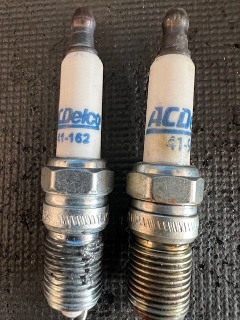

Had the same problem last year after replacing all my ignition plugs with new AC DELCO plugs during last winter.
I got misfire on cylinder 3 and the secondary voltage from the coil bounced from 0 to over 10Kv instead of a"stable" voltage between 6 and 7 Kv .
