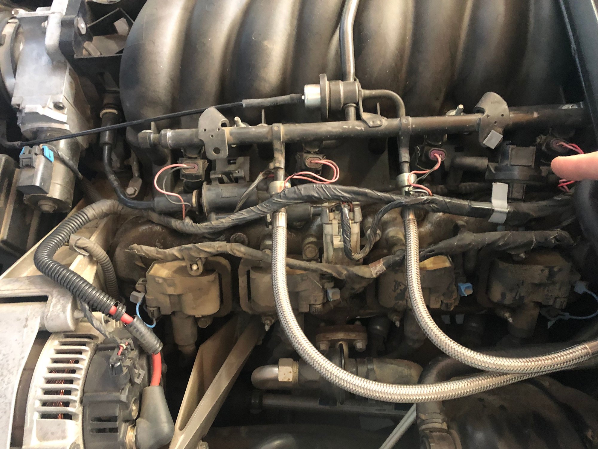

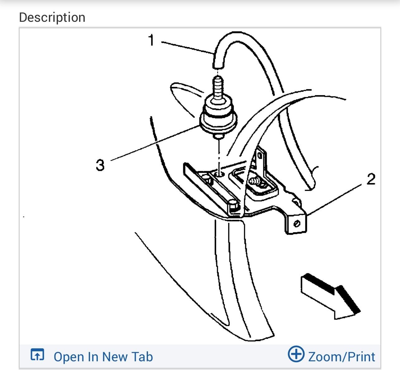

Thanks. You are right about the dealer. The shop foreman at the Chevy dealer in my area didn't know what the valve with the electrical connection to it was called or what it was for. He wanted to start removing the gas tank assembly and replace my fuel pump but I'm on my fourth pump so I doubt the pump is the problem. Something is causing these pumps to make noise. Incidentally, in the diagram you sent, there is a diagram of the vapor canister purge line with some sort of valve connected to that line. That is the valve that the dealer could not identify and has a rubber hose coming out of it that is exposed to the air (not connected to anything). Can you tell me what the valve is and how it functions as it comes before the purge valve and has an electrical connection to it. He are photos of the valve in question with my pointing to the mystery valve.on my 1997 C5. The third photo is a snip of the diagram you sent with the valve I'm taking about. What is this valve and what does it do? Can you tell me?

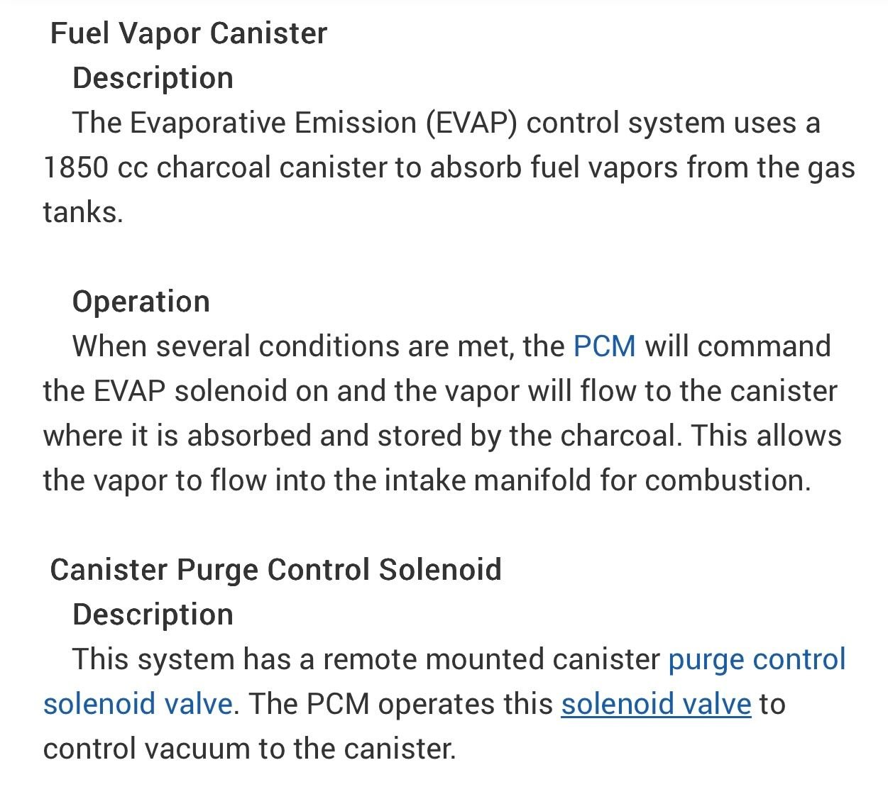

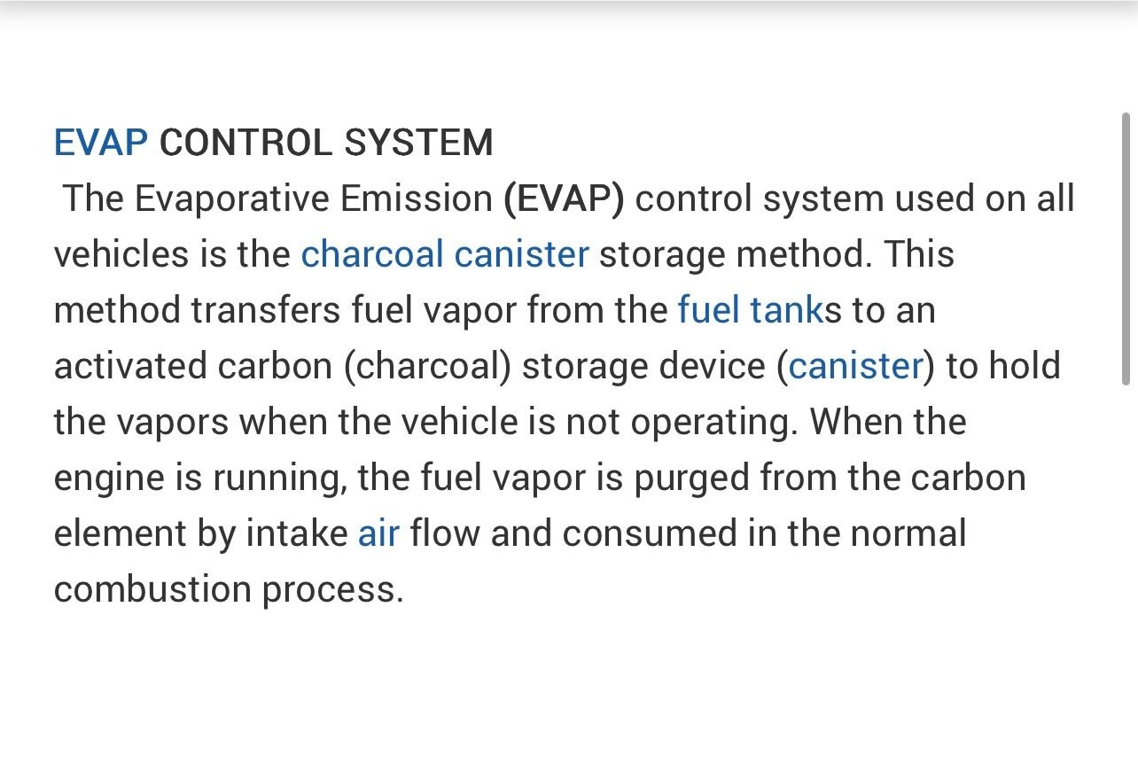

Old Aug 17, 2025 | 08:51 AM
Again….info below !!…may be best to seek out an auto diagnostic shop !!

Thank you. I think you have provided a comprehensive explanation and amount of information about the evaporative emission system and I greatly appreciate it. Because I am a bit dense, I want to make sure I am perfectly clear on your identification of the part I was pointing to in the photos and cut out I sent. That part in the line that runs from the evap canister to the purge solenoid and is placed in the line before the line reaches the purge solenoid...that part is called the evap system "PURGE VACUUM SWITCH." And, that switch monitors the function of the PURGE SOLENOID. Is that correct? Did I get that right? If I got that right, it seems to me that the PCM signals the Purge Vacuum Switch to open if there is a certain amount of VACUUM in the evap canister line and the PCM signals the Purge solenoid to open when there is the appropriate amount of evaporative PRESSURE in the evap canister line, sending gas vapors into the engine. So the Purge Vacuum Switch releases vacuum and the Purge solenoid releases pressure. Am I thinking about that correctly or do I have it all wrong? As a side note, I am NOT getting ANY PCM, ECM, BCM fault codes.
Here's another scenario I thought of: If all the Purge Vacuum Switch does is monitor the purge valve solenoid, then perhaps all it is there for is to tell the PCM that the Purge Valve Solenoid is working or not working properly and in that case send a signal to the PCM and in turn present an evap fault code. Perhaps reducing vacuum has nothing to do with the Purge Vacuum Switch at all.
