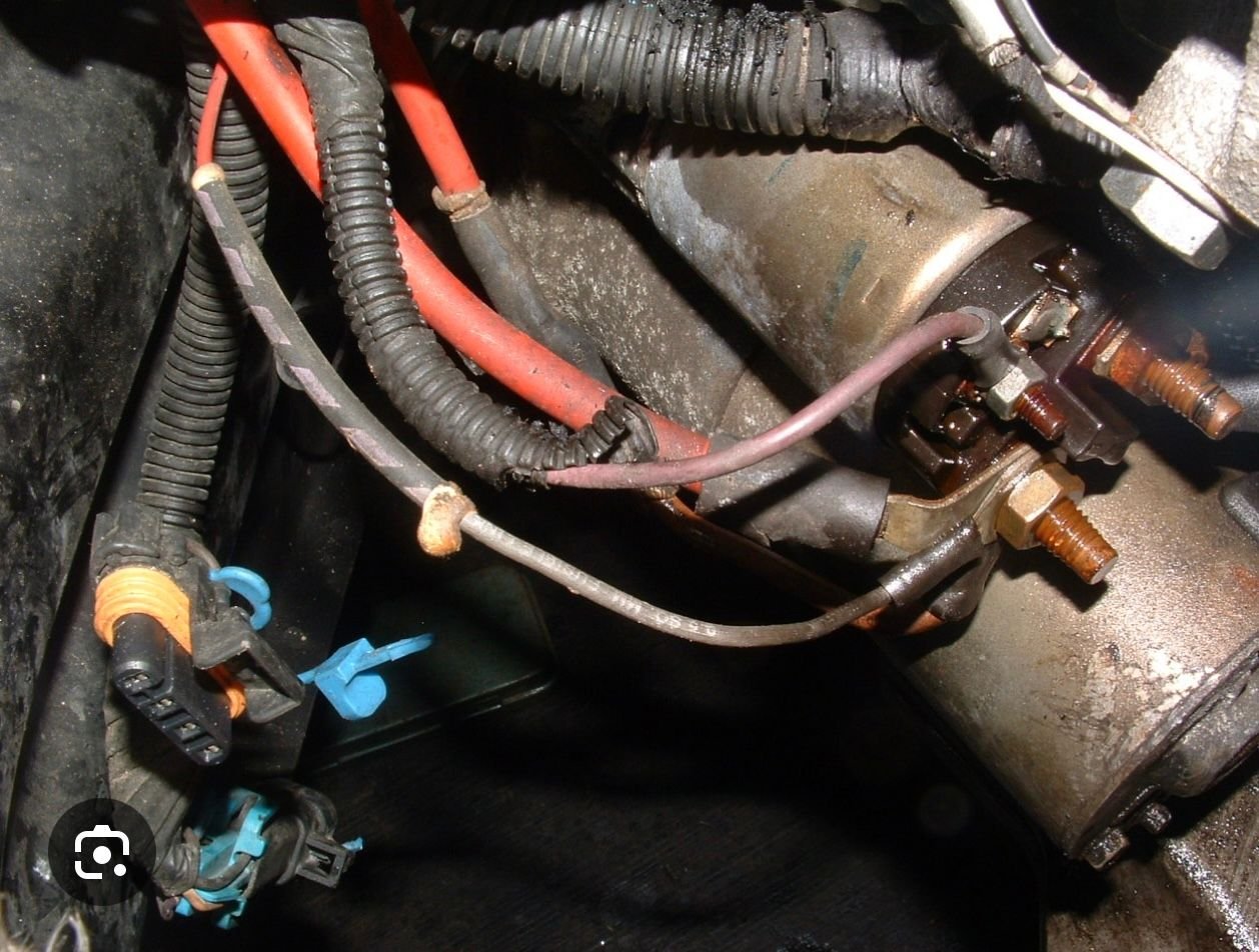

The positive battery cable and alternator B+ cable meet at the starter solenoid if you didn’t know that…if there is a bad connection or high resistance the battery will not be charged…the alternator may be delivering 14.5 volts but if you are seeing 12.5 volts at the battery you have a 2 volt drop…you should have less than 0.5 drop on the positive and negative sides of the charging system.

C5 Diag's Avatar
C5 Diag
Moderator, Tech Contributor
Posts: 15,633
Likes: 4,079
From: Cape Coral, Florida

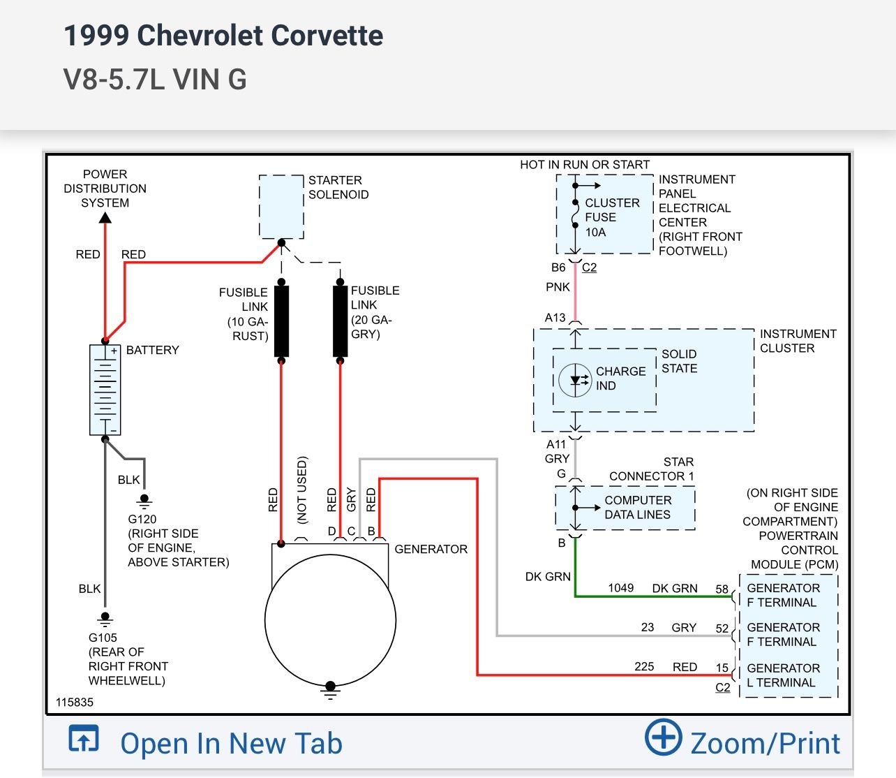

Old Aug 17, 2025 | 03:58 PM
C5 Diag's Avatar
C5 Diag
Posts: 15,633
Likes: 4,079
