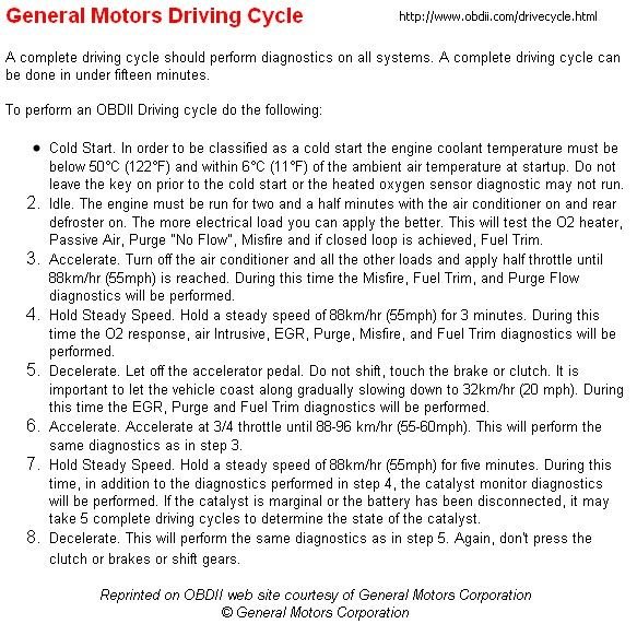

2004 C5Z needs emissions testing but the vehicle is reporting not ready for CAT and EVAP.
The battery was replaced a few hundred miles ago and it does have an active DIC "99-HVAC B0361 H C" with symptoms pointing to air door actuator needing to be replaced.
Edit: I also removed an after-market Vararam intake and installed an OEM, after-which I got a bunch of error codes. I pulled fuses 16 and 23 to reset the PCM and cleared codes (HVAC code above still active).
I followed the drive cycle procedure several times and drove a hundred miles without success. Is there something that can done to make it emissions ready?

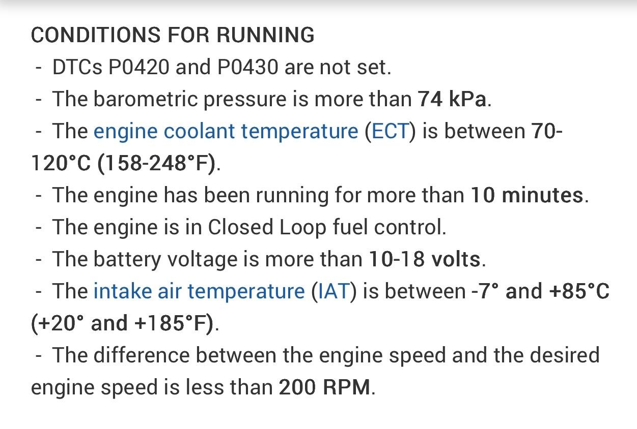

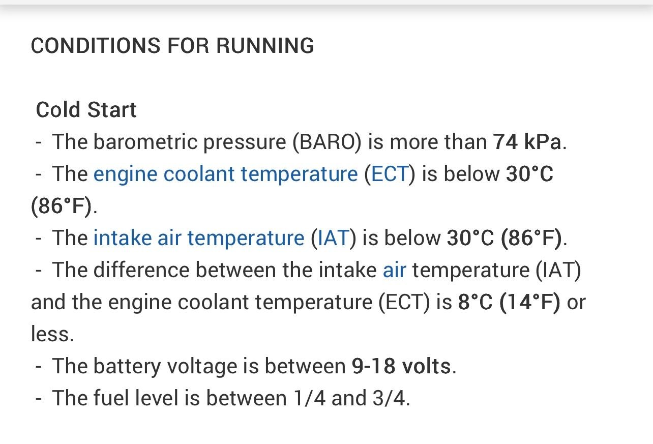

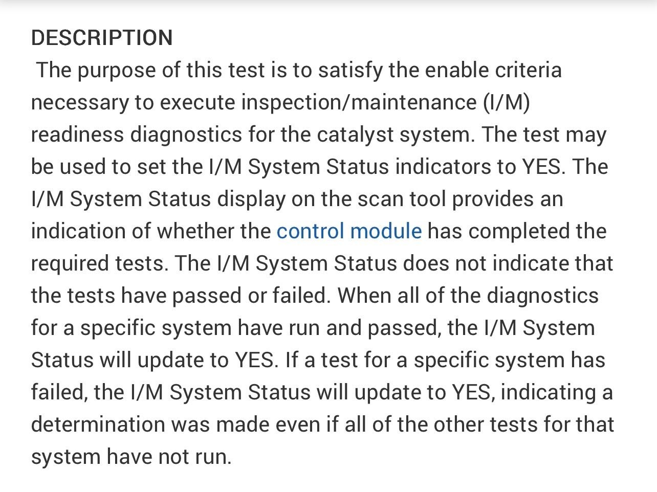

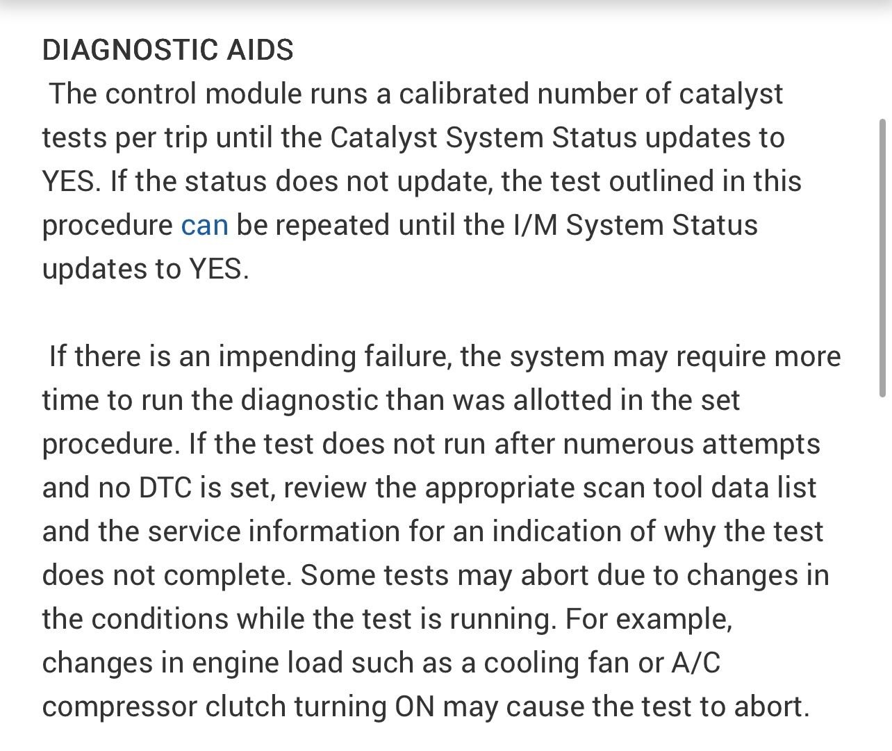

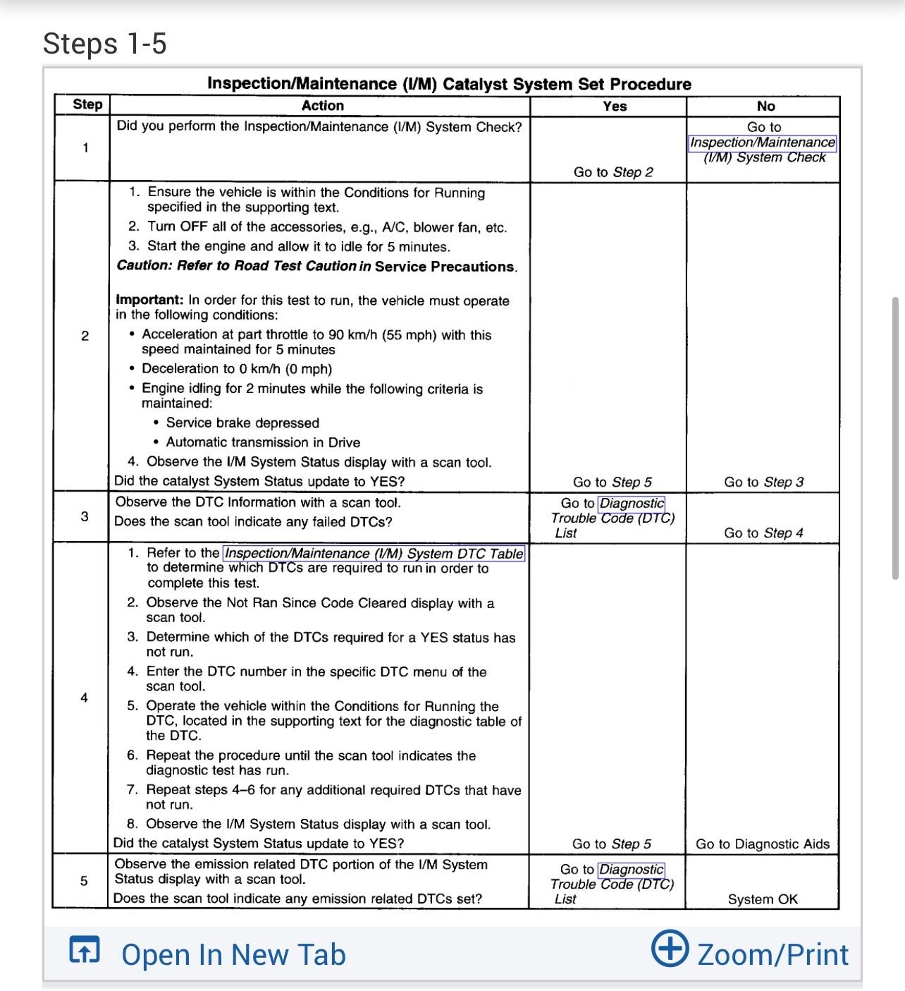

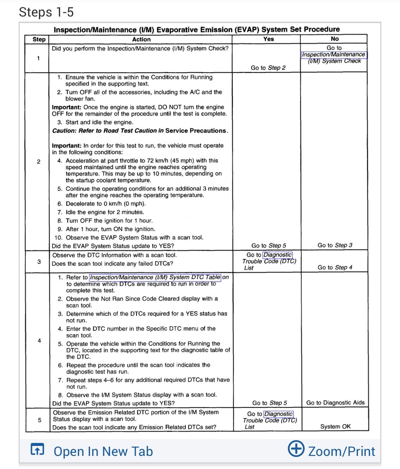

Does it say “heated” CAT which you don’t have ??…you are normally allowed 1 monitor not to be set which is EVAP because it’s the hardest to run and complete…with a factory level scan tool you can do a “Service Bay Test” which takes a few minutes..biggest thing with EVAP is the tank must be between 1/4 to 3/4 full and no accessories on for both…you must follow the drive cycle exactly !!…you should use the service info for your model year…this is for a 2004.

The Not Ready status is for CAT, not "heated CAT." Fuel levels were between 1/4-3/4 tank during the procedures. However, the instructions I posted state to turn ON AC and Rear Defroster (Step 2) after Cold Start while yours explicitly state NOT to. There are other differences between the two, will try the method you posted and report back.

The info I posted was from factory service information…I don’t know where you got your info from….your car being tuned or not does not affect your I/M monitors being run.

No luck following the procedure posted by @C5 Diag . Tried multiple times over several days. My ODB2 scanner still shows CAT and EVAP not ready.
What are my options? Is there no way to force systems to be emissions ready? My ability to get plates and register the vehicle are dependent on it passing.

Take it to a shop and let them do a “Service Bay Test” to complete the monitor for the EVAP…no need to drive the car and just takes a few minutes.

The evap was the hardest one for me to clear after following the factory manual procedure. I gave up and used my TECH2 clone to perform service bay test. Two minutes layer all monitors passed!!
