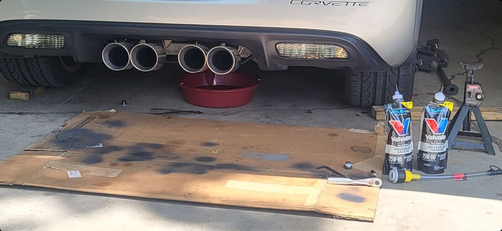

Have Valvoline 75w90 Limited Slip gear lube, says it already has friction modifier in it, but I see some adding additional modifier to these LS gear oils.
What is the consensus, is the amount of friction modifier already in the lube enough?

I recently changed the diff fluid in my Dad's C6 and used Valvoline 75W90 with no extra juice, no problems . After changing be sure to do several slow figure 8s in a large parking lot to get the new lube into all of the clutch packs.

Ok, thanks, already done deal.
