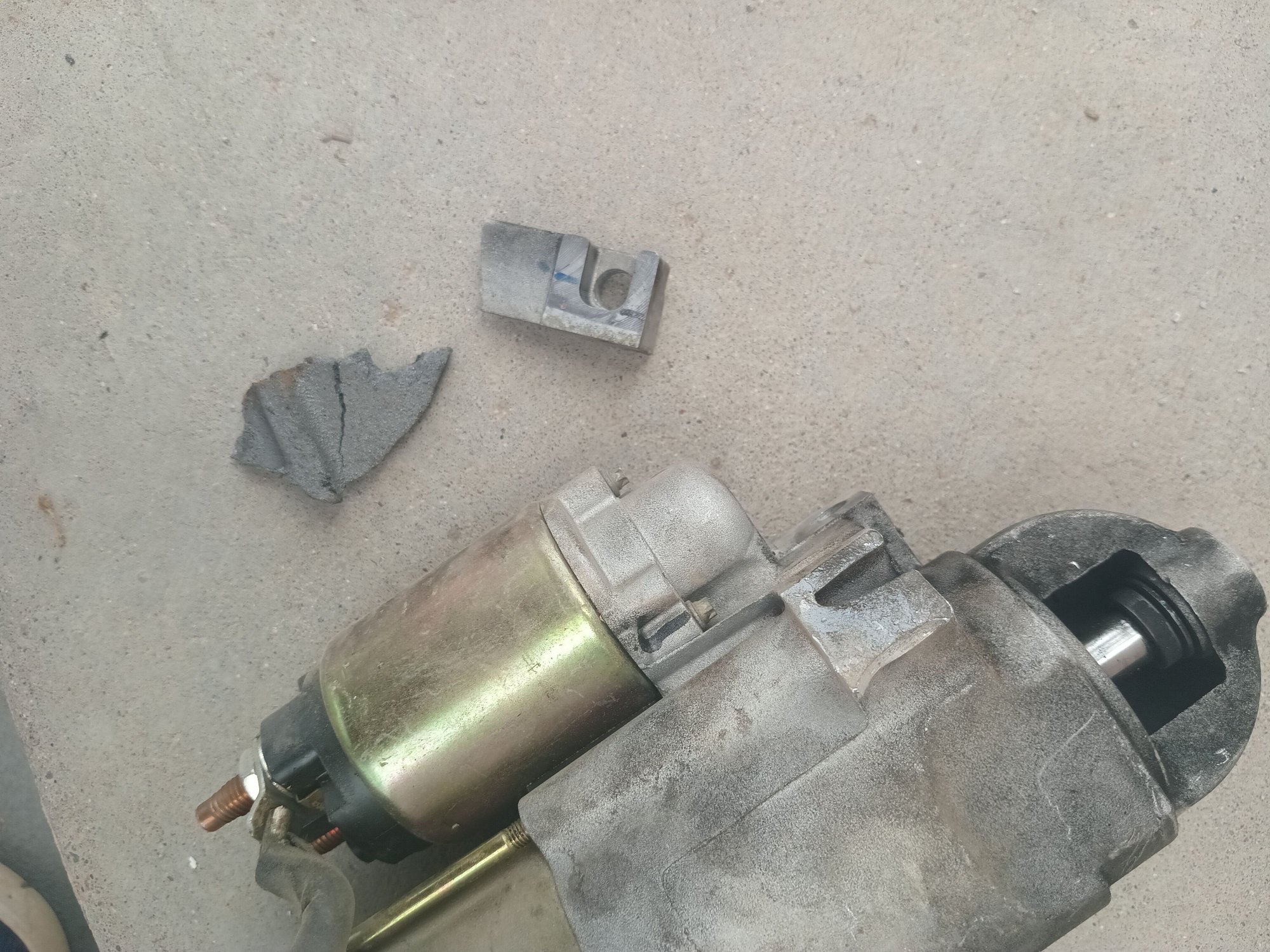

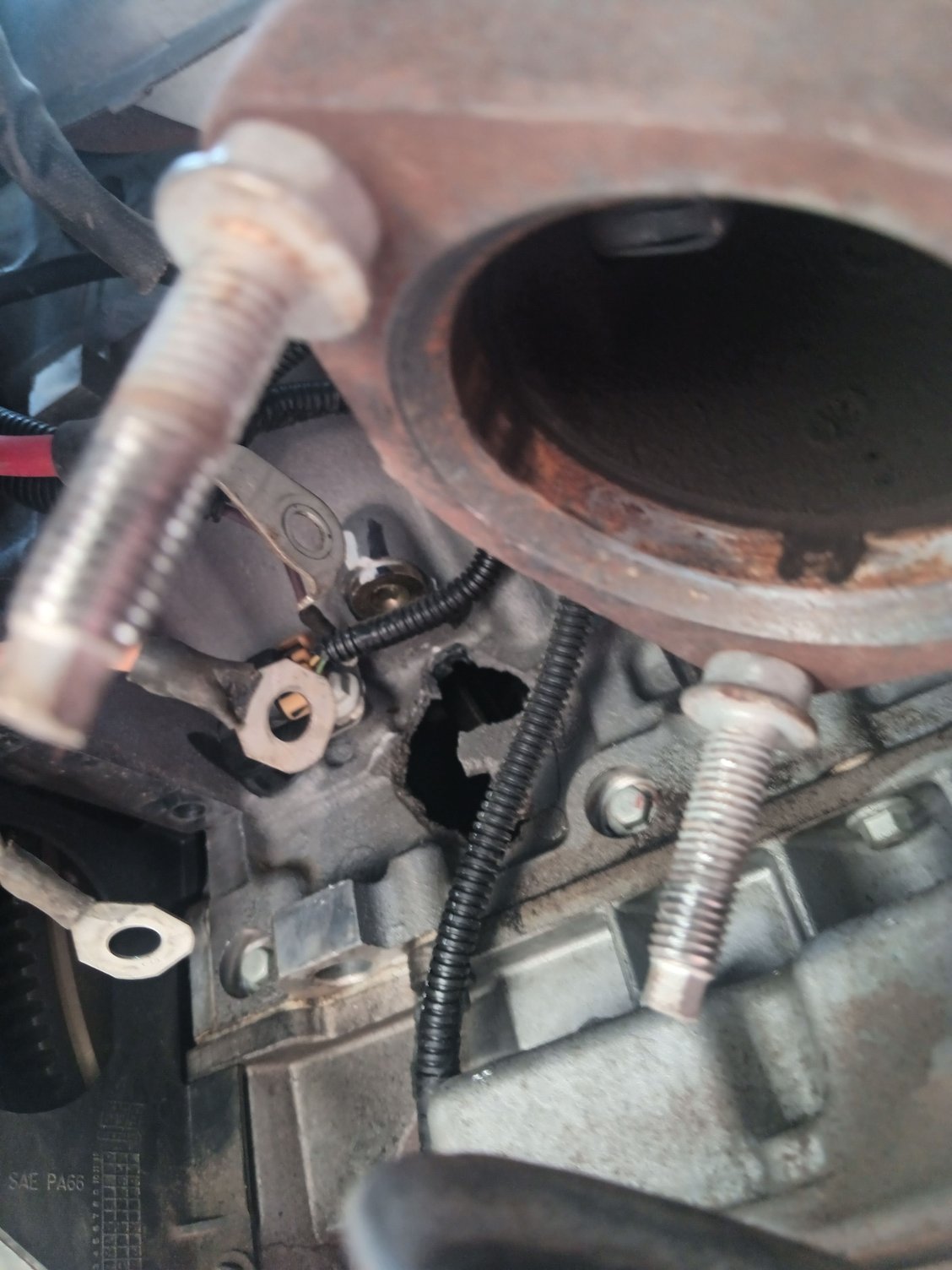

BTW, buddy has never filled the N2O tank and I'm pretty sure it was just for show with the PO.
He took his bore scope and he says he can see the piston in the hole but the connecting rod is AWOL. Seems like what you get when you hydro-lock the engine in an Arizona Monsoon.
I've been dragging my feet on putting a lift in the shop at my new house, but sooner is better than later.
I will be in AZ end of January and told buddy that if he gets a trailer I'll haul him and his car up here and we'll put in a "used" engine ourselves. Then he gets to shake it down with a 1200 mile winter drive home. What could go wrong?
That's about all I can do...

Agreed. If the pistons aren't shattered and the rod is gone that doesn't sound like a typical nitrous failure.
