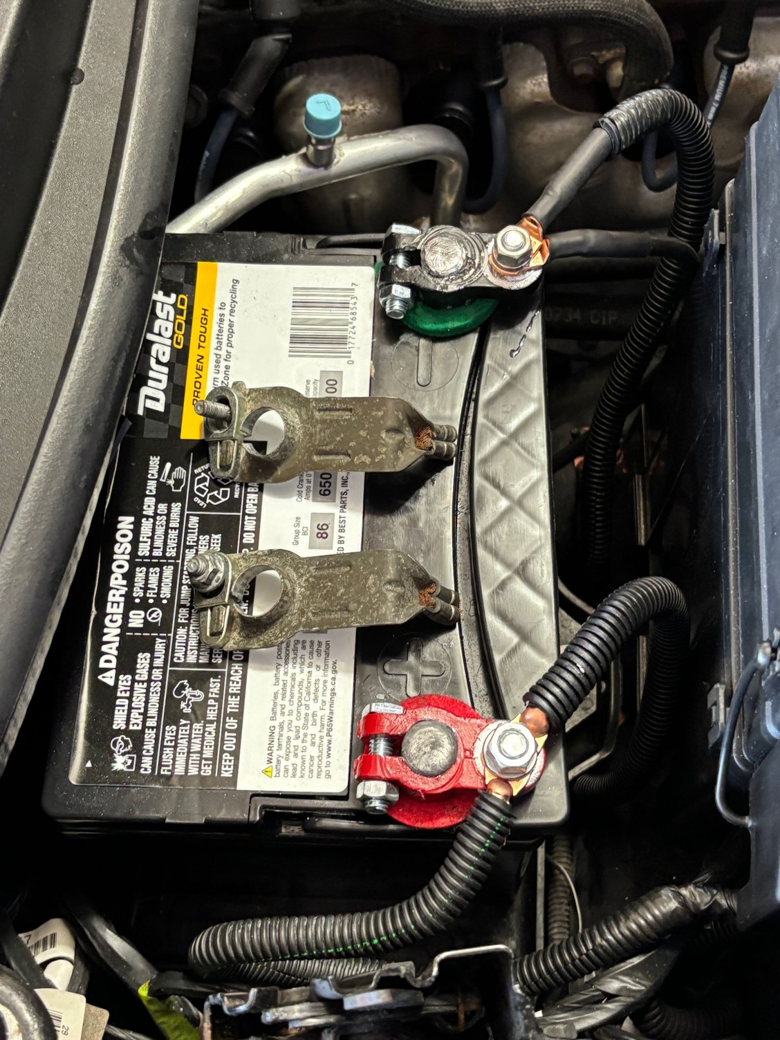

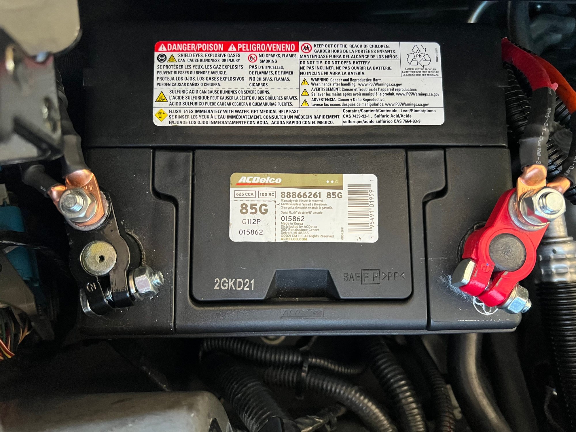

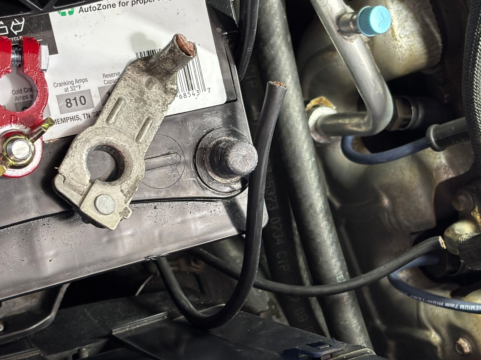

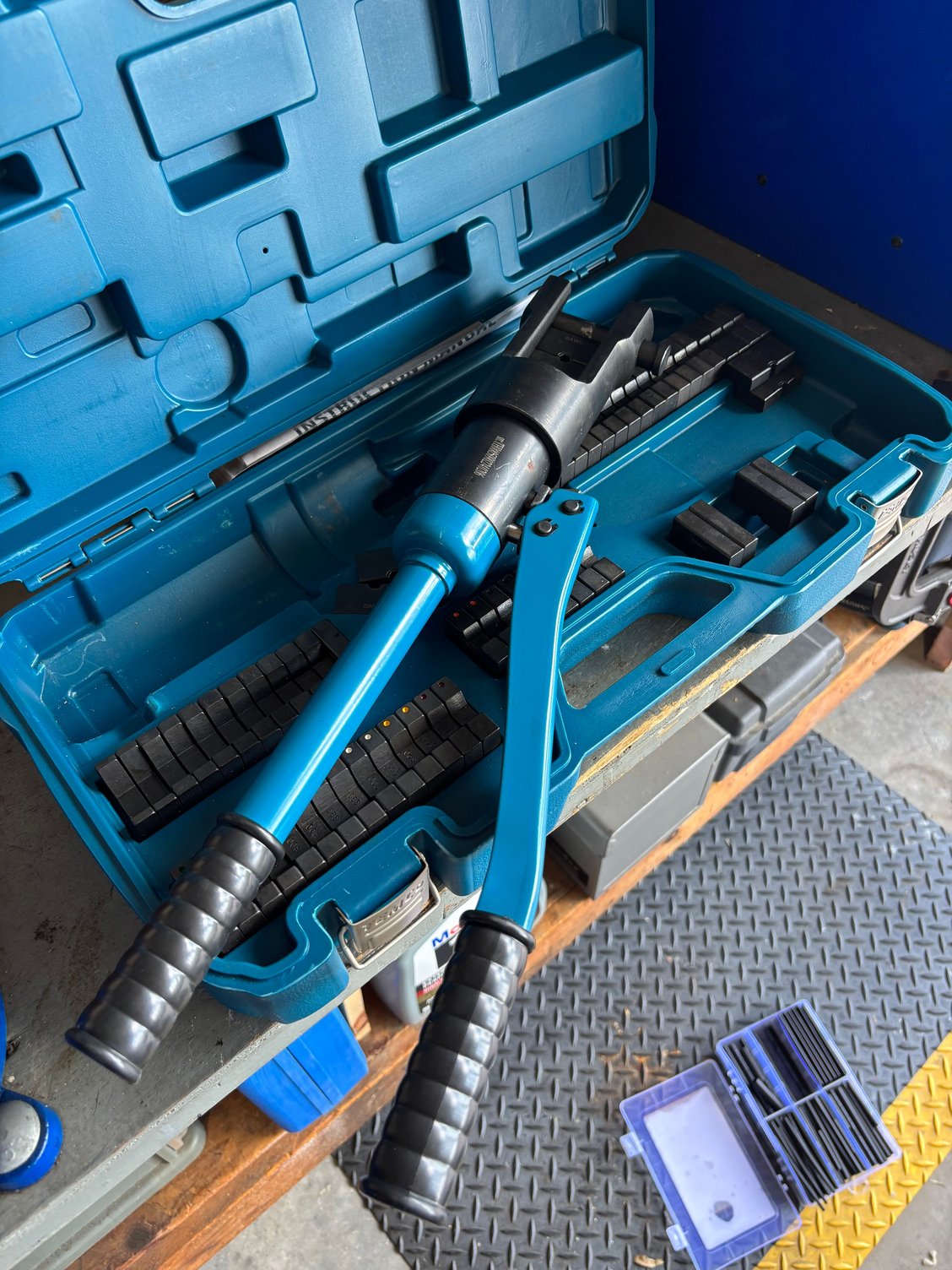

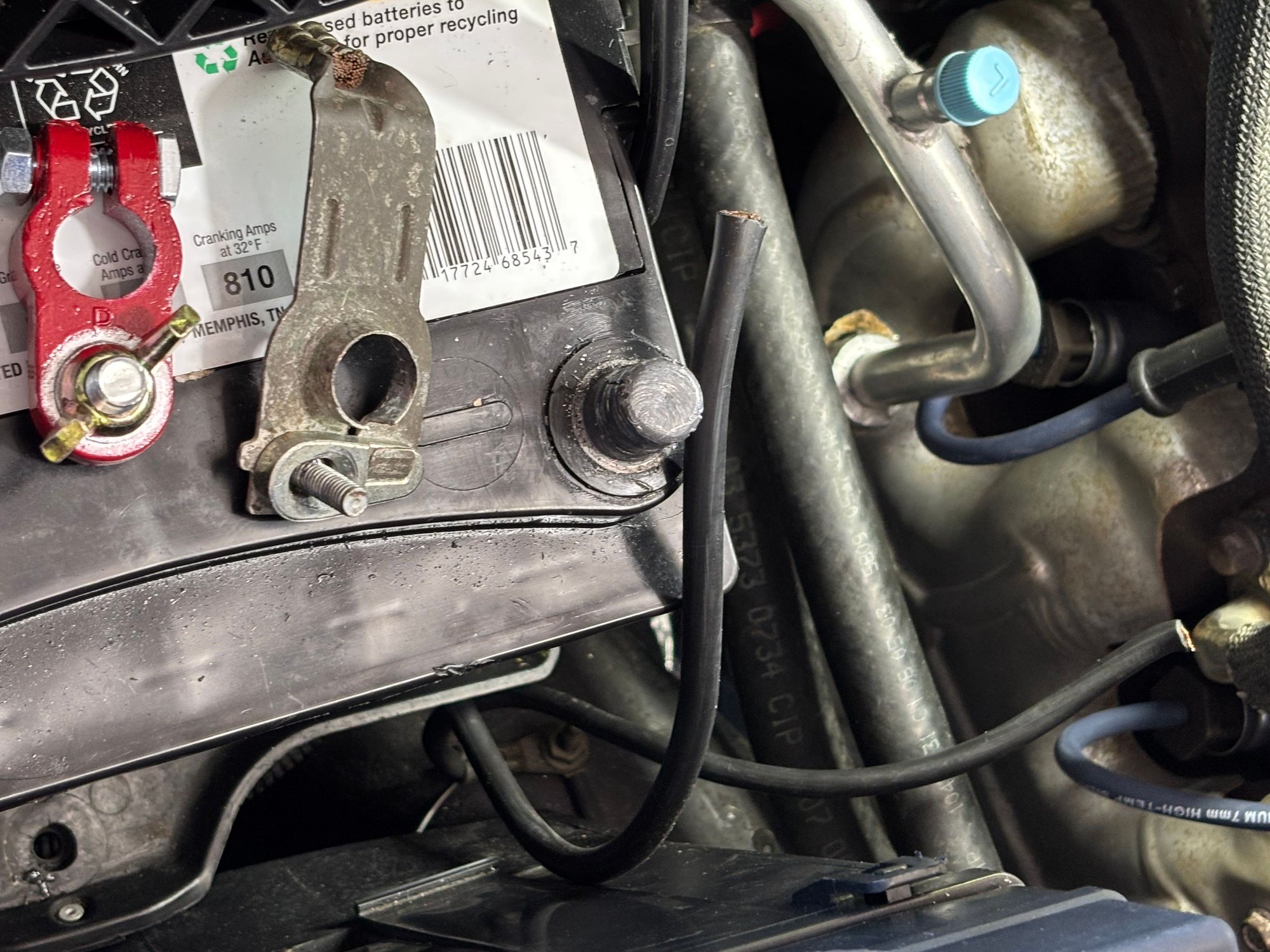

Since day one (April’25) I was unable to sufficiently tighten the negative battery terminal. GM in all their brilliance came up with a true Rube Goldberg contraption in the design of their battery terminal clamp. Even super human wrenching on the 10mm nut yields only sloppy tightness, a C5’s undoing in the offing. Thanks to our Moderator and Tech Contributor C5 Diag, who broke out the heavy guns ( an hydraulic crimp tool) and a bunch of experience, new traditional battery terminals were installed. No longer will I have to cross my fingers going over bumps. A shout out and many thanks to C5 Diag for his time and valuable experience.

Just get yourself some bare copper or tinned copper lugs and a good hydraulic crimper…a good TEMco crimper that I use is a little over $200.00 but is the best on the market…some of the dies that come with these cheap Chinese crimpers are not sized correctly.
