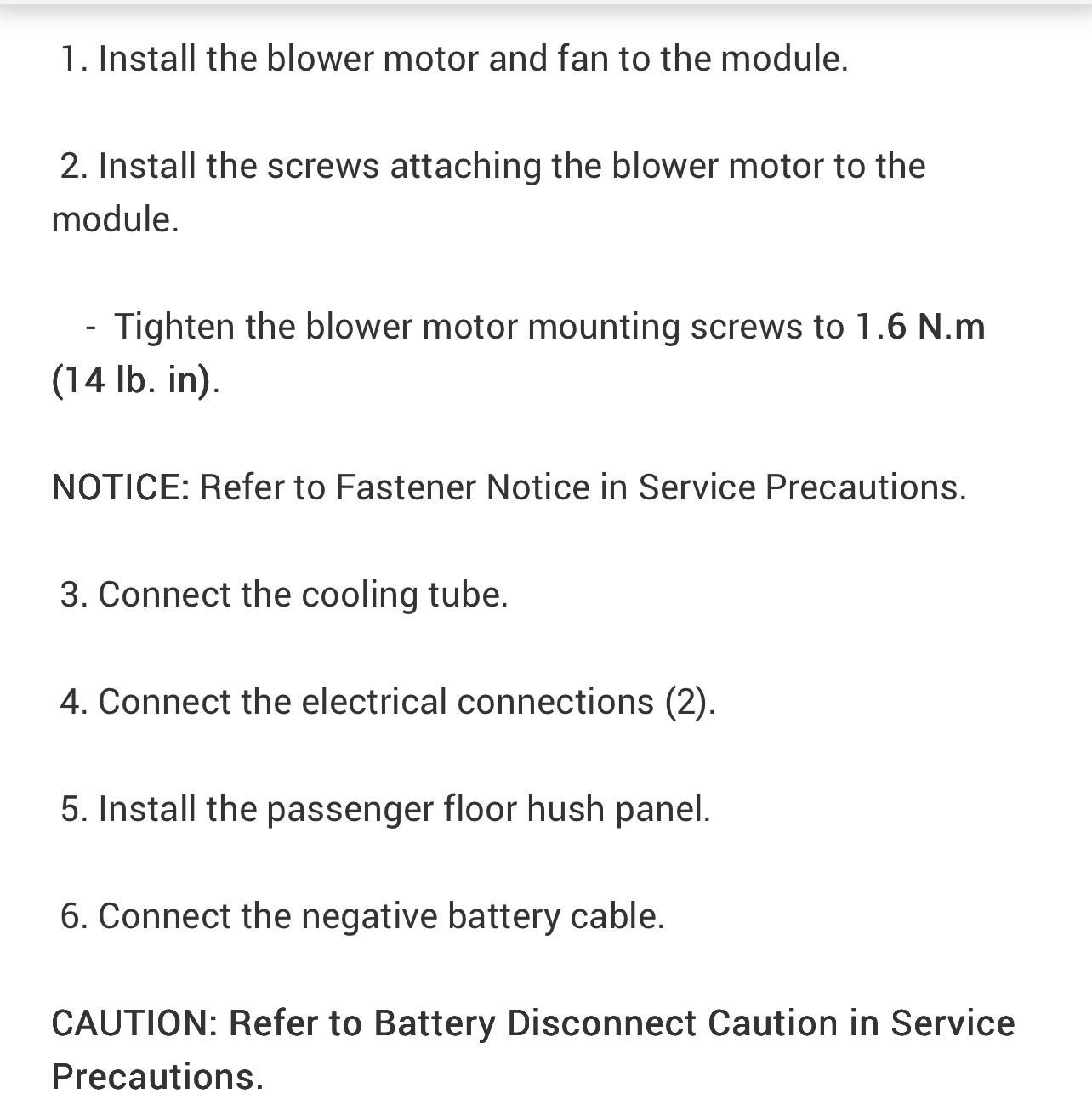

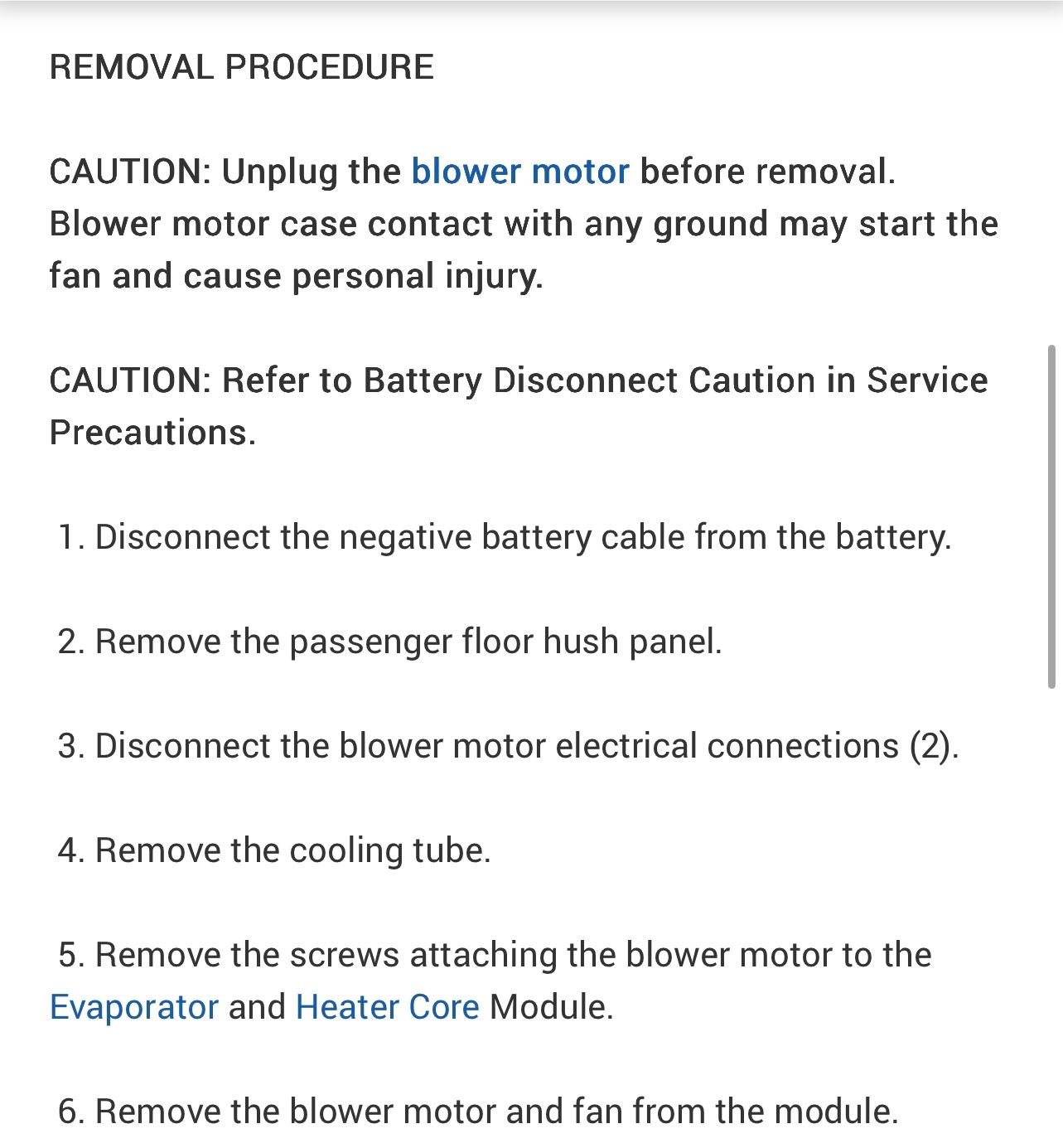

You never mentioned what the symptom was, but the blower motor removal is not that bad to do IF you are physically able to get in there.
A few fasteners will need to be removed by feel (not in sight)
