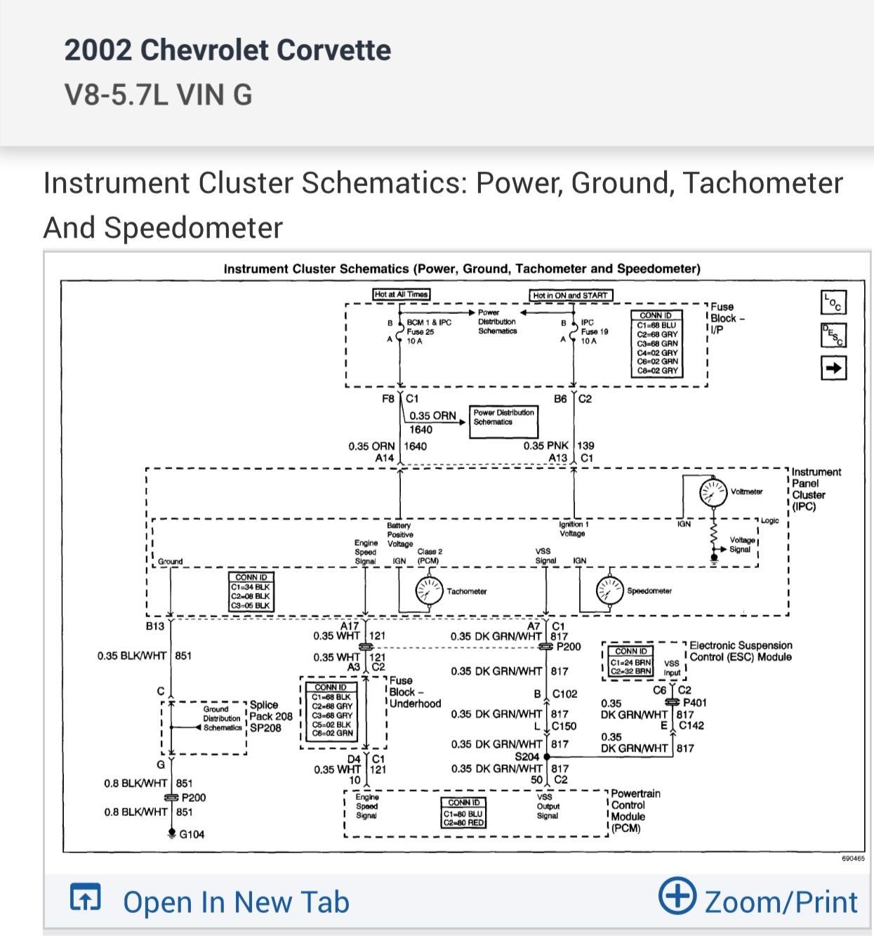

Possible bad ignition switch contact…DIC voltage is taken from the Ignition 1 voltage signal going to the IPC…if you know how to use a DMM connect one lead to battery positive and other lead to IPC fuse 19 when you are seeing 7 volts… you will probably be reading 6 volts or so on the DMM…you are dropping 6 volts across the switch contacts.

Yes, that is correct...we don't know that...happened to me when my switch went bad...7 volts on DIC.
