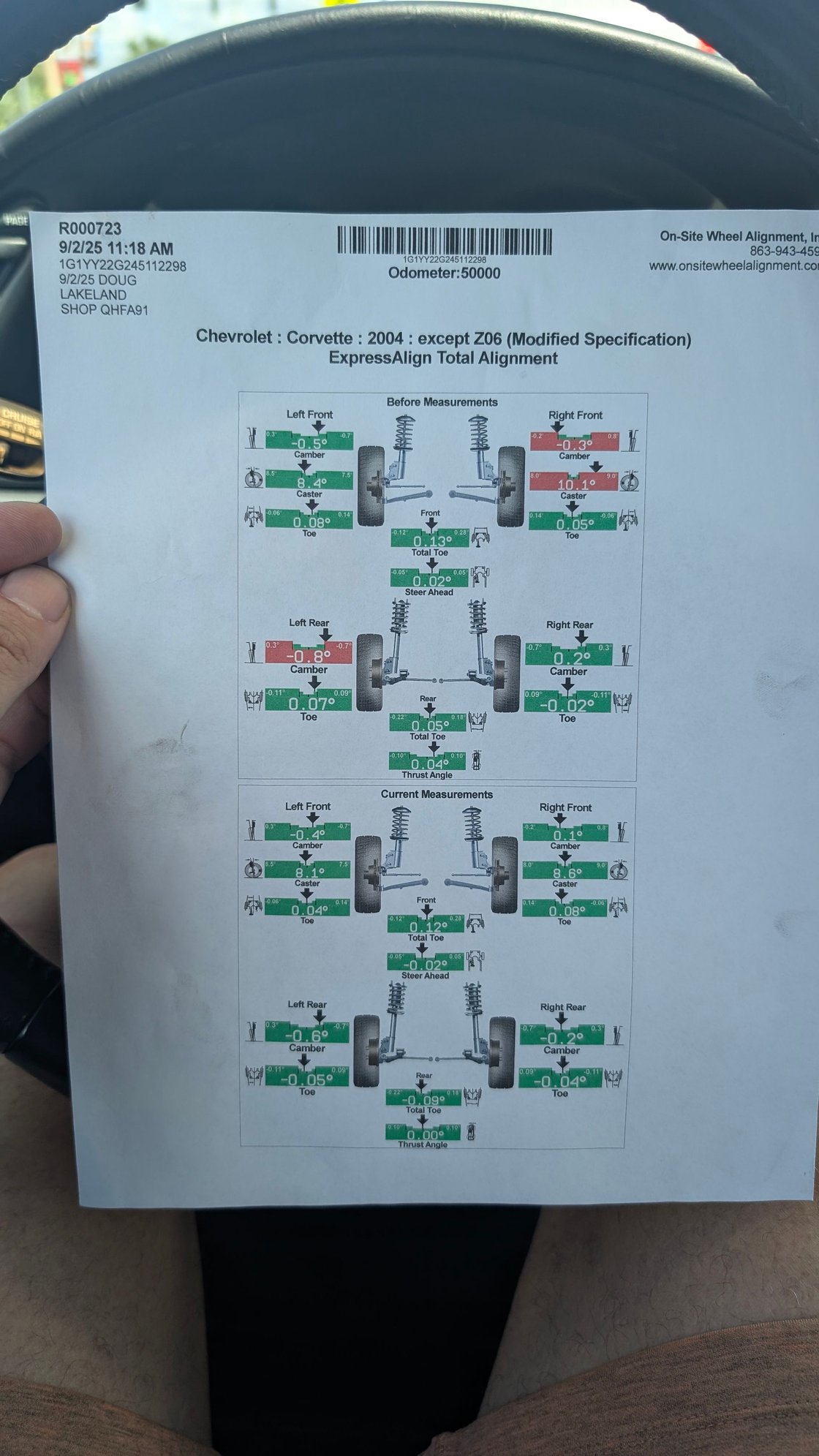

New alignment shop corrected camber and caster and problem resolved now

Any magic needed to bring the caster into spec?
Old Sep 4, 2025 | 02:47 AM
douglasjre's Avatar
douglasjre
Joined: May 2021
Posts: 403
Likes: 64
I honestly don't know. It's a different specialty from mine and I didn't get to watch. Check my dog to the vet for dinner cleaning, installed two pumps, a 6 gauge ground wire with copper lugs custom made by me, and other miscellaneous repairs to keep my day busy. Couldn't keep up with all that went on. But it definitely fix the alignment and now I can stomp on the car and traction control doesn't kick in unnecessarily. One thing to note: it is not possible to reset the steering angle sensor on this car. You just have to get the alignment right.
