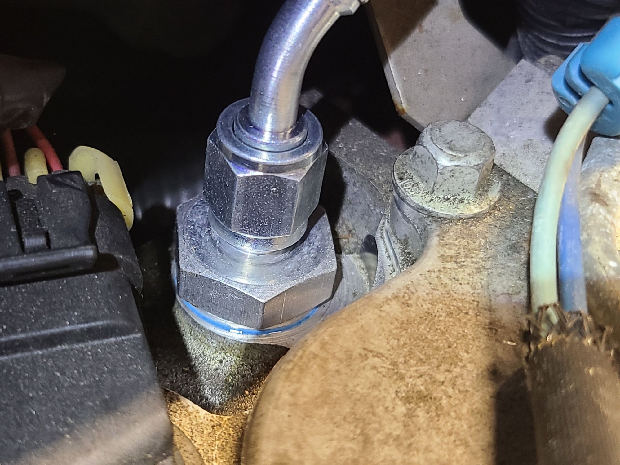

Many thanks to everyone for the advice. I pulled the intake yesterday and relocated/replaced the oil pressure sending unit under the fuel rail cover. It went pretty smoothly overall, and it took about 7 hours, but I was very careful - especially about cleaning everything - and I took lots of pics along the way.
I added 5" of vacuum line to the rear of the intake. That vacuum line is 1/4" on my 2000.
This fitting This fitting
screwed into the block and accepted the 4an hose, so no additional fittings were required for that. I used
this hose this hose
with a 45 degree fitting that attached to the fitting in the block and routes the hose at a nice angle to hide the sender under the fuel rail cover. And
this fitting this fitting
attached to the hose and accepted the oil pressure sensor.
I also used
this wiring extension this wiring extension
I did use the new ARP manifold bolts. I'm sure the old bolts were plenty strong enough, but when I removed them the factory thread lock on them made them feel tight in the threads. I didn't think those bolts - without a lot of cleaning - would have the proper torque on the re-install.
The car started right up with no leaks and is running great. I'm glad I don't have to pull that intake very often.
