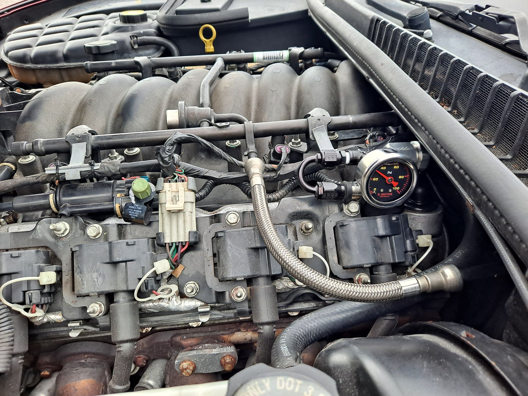

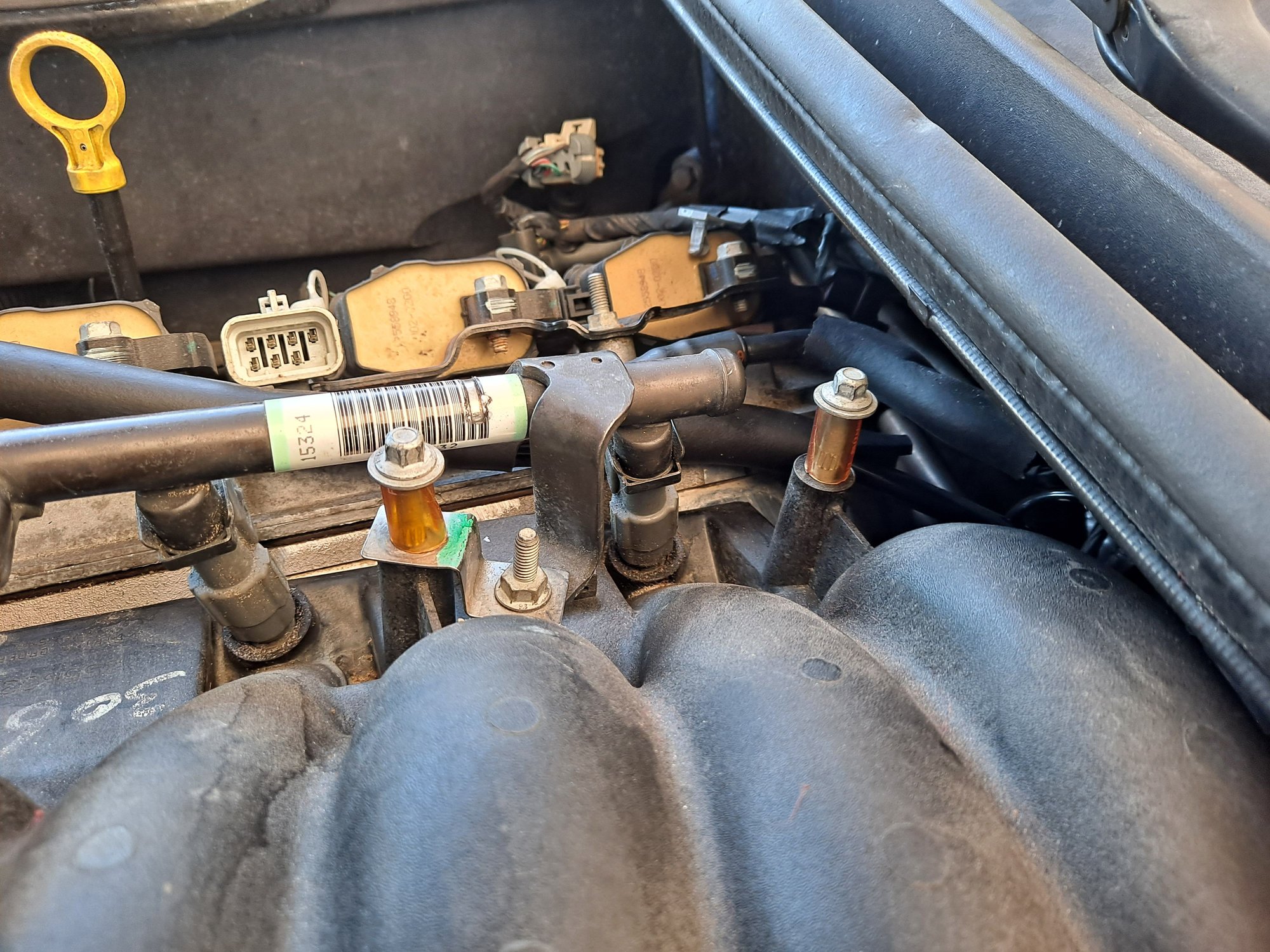

When putting the manifold back on putting a piece of split hose over the rear fasteners holds them up making it much easier to slide the manifold back in place along with the mentioned vacuum hose extension. I also did a home made pressure relocate with a mechanical pressure gauge.

Thanks for the info everyone.
That looks really nice. I hope to make mine similar to that, but without the gauge.

Originally Posted by C5Mat
It is not a hard job. you don't have to pull the fuel rails (just disconnect the line as you stated). You can leave the vacuum hose on the back for the booster, I usually just disconnect it at the brake booster. The HVAC line you should be able to disconnect once the intake is loose and pulled forward enough to get your hand back there.
You can leave the throttle body on too. May have to disconnect coolant line if yours still has them running through it.
You can use rubber bands or something to hold the rear bolts up so they don't keep falling while you trying to move it forward.
Clean it up real nice and keep debris from getting into the intake ports.
The passenger rear is the only bolt difficult to torque down if I remember correctly.
I've read about guys using clothes pins to hold the bolts. I've never used anything. I just pull it forward and lift the bolt that is holding up the removal at any given time. As for oil sending units, dont replace the junk factory sender with more junk, aka the OEM GM sender. I installed the 1 year guaranteed O'Reilly sender at least 6 or 7 years ago. Never had another issue, still on there. Didnt torque it down, either. The OEM senders are as reliable as an Ex-wife's testimony at a custody hearing!! Yes, I like that analogy, and no, DON'T ASK why!!!...

[QUOTE=Six7390gt;1609070371]Thanks for the info everyone.
I've got a couple more questions:
Do you remember the length of the stainless hose that you used? Maybe 15" or 18"?
To extend the small hose at the back of the intake, will I need 5/32" or 3/16" hose? I've seen it called both.
I made my own piece of hose with stuff I already had. It ended up around 16-18" IIRC. I cannot remember exactly what size vacuum tube however I believe either will work. Remember to get a vacuum line coupler as well to connect to the original tube.
