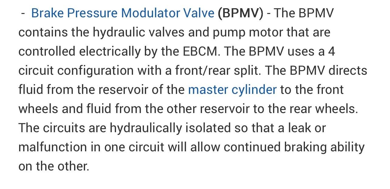

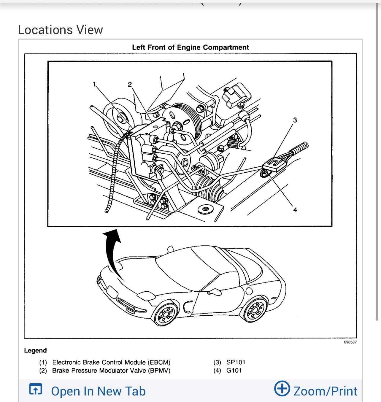

There are eight model year C5s! 1997 t0 2004. The 97 to mid year 98s had the EBTCM mounted in the rear behind the differential. Those models are very unique and rare these days! After midyear 98, GM moved the EBTCM to the front. Between the radiator and engine/
The 97-2000 EBTCMs were labeled as Early Systems. The 2001-2004 were labeled late model systems and the late and early are significantly different.
There are two parts to the EBTCM. The mechanical/hydraulic side, Brake Pressure Modulator Valve (BPMV) and the Electreonics part of the module. They are bolted together as a unit and can be separated. The part that you are describing as being bad is screwed into the BPMV.
