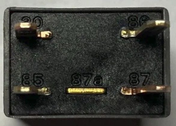

85 and 86 are diagonal from each other. Using the picture below, you are saying you have battery voltage on 85 and 86 ...socket side, with key ON ?

Sorry, looked at it incorrectly, voltage at 86 and 87
