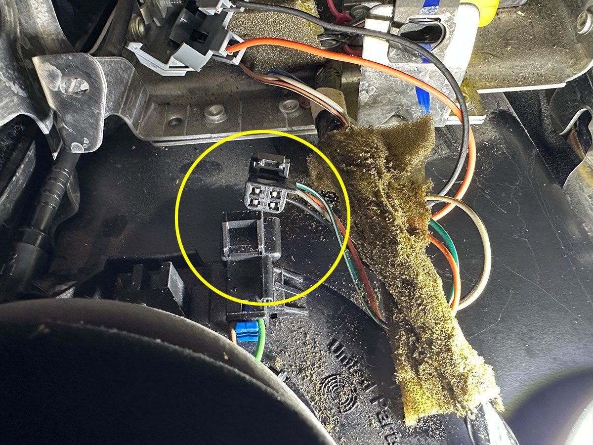

I think I have watched every video on the Internet the past few days regarding this issue and I saw a couple people show where all they did was disconnect an electrical harness plug on the shifter harness as a opposed to either replacing the solenoid or breaking/disengaging/restricting (mechanically) the solenoid itself (as a workaround).
I finally thought I would give this a try first. The photo below shows the 4-prong plug I disconnected tonight. Shifter button now shows no resistance to press down in Park now and car starts and goes through gears fine now. The question is, by disconnecting this harness as a solution does it cause any other issues besides deactivating the problem solenoid? I am not seeing any obvious side effects or codes so far.

Long since discontinued. No harm in leaving the connector unplugged...just bag and zip tie.

FYI - Might also mention that unplugging that socket also removed the "Brake Before Shifting" message on the DIC (for anyone reading this).
CORRECTION: I noticed tonight that the DIC message DID appear when I got in the car (not sure what sequence causes it to show up - after 25 years of driving the car, I just became numb as to what causes it to appear).
HOWEVER, apparently the PRND123 interior shifter lighting no longer lights up at night so apparently the socket I unplugged trashed that feature? Now I need too see if there is a way to get that back as I drive almost exclusively a night.
