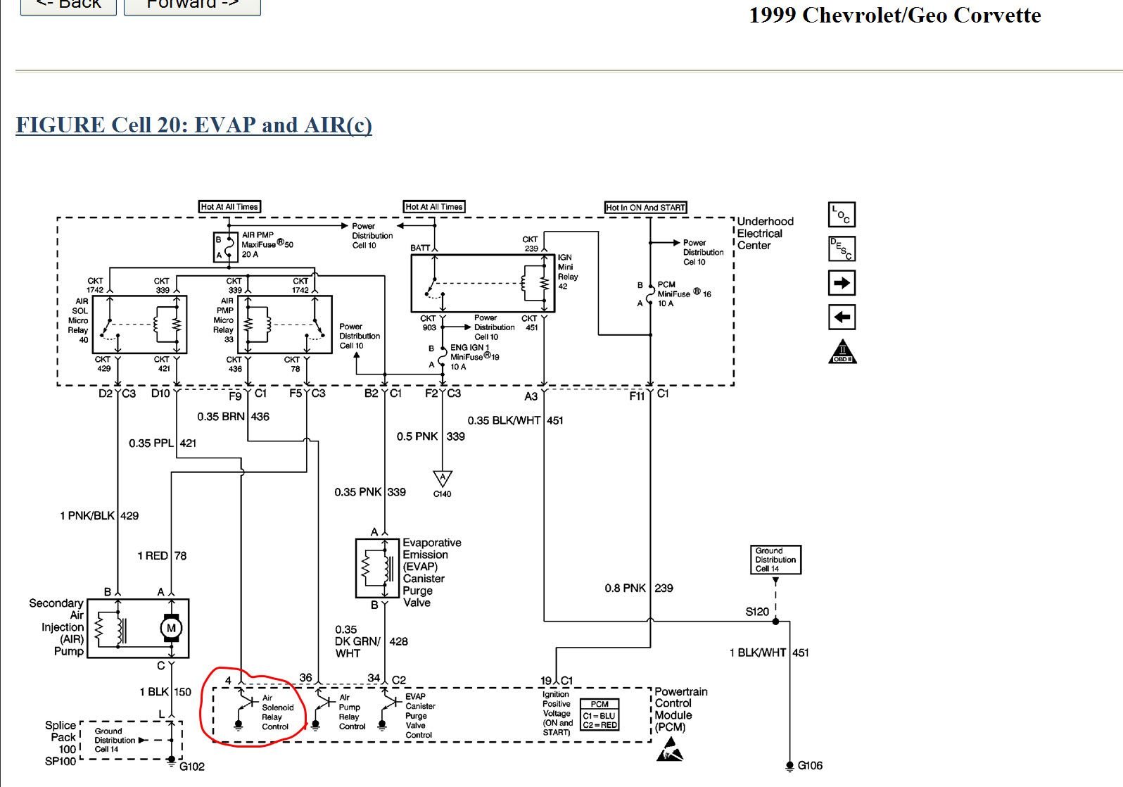

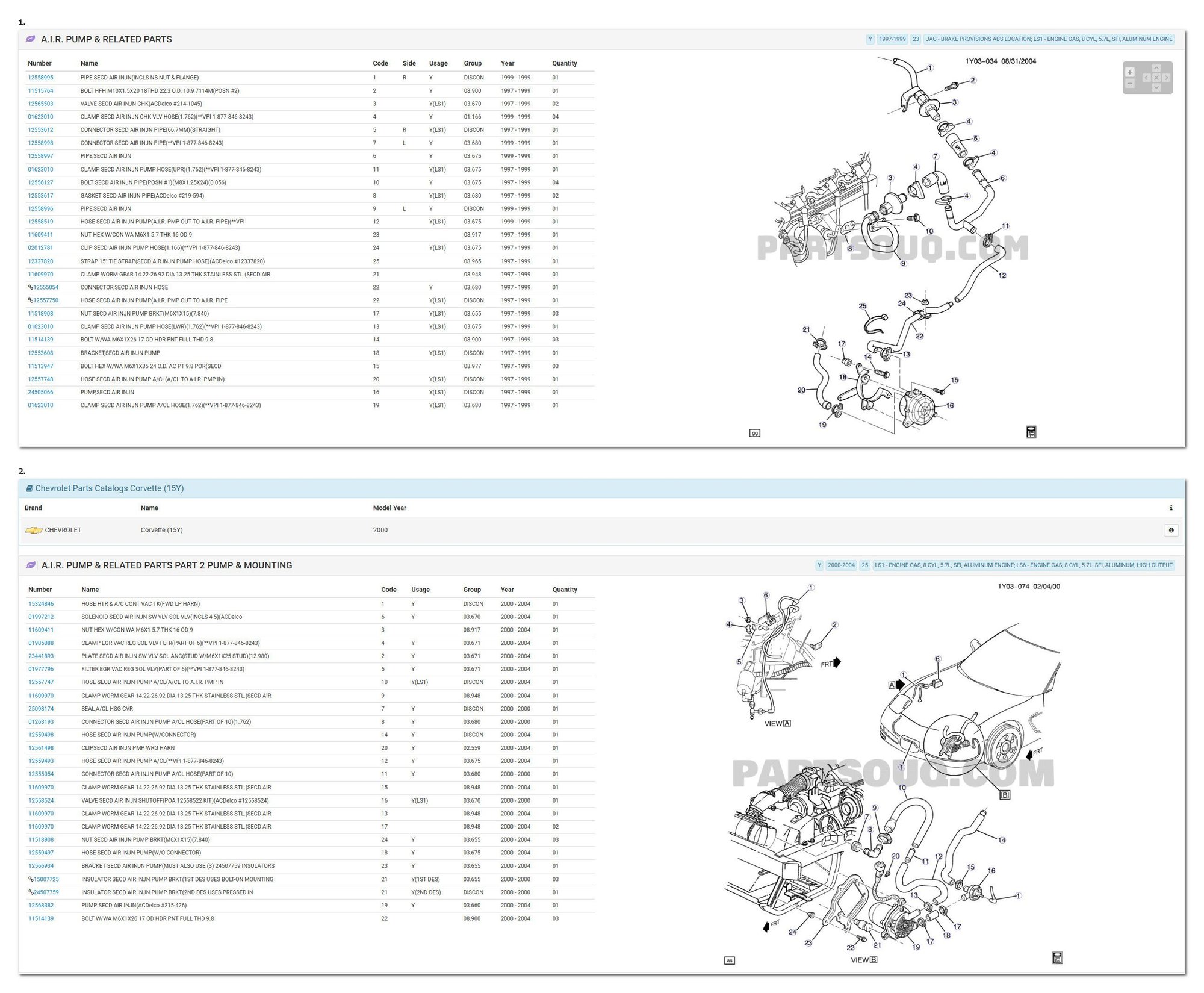

I was not aware of this fact ,but I see now that the shutoff valve on the air pump outlet is missing on the part drawing on the 99 compared with a 2000 .
Even if the electric drawing in the SI manual indicate the AIR solonoid on a 99 ..............

The schematic is correct. The PCM controls the A.I.R. solenoid in the pump housing via the relay. This control changes to a vacuum solenoid control in 2000
