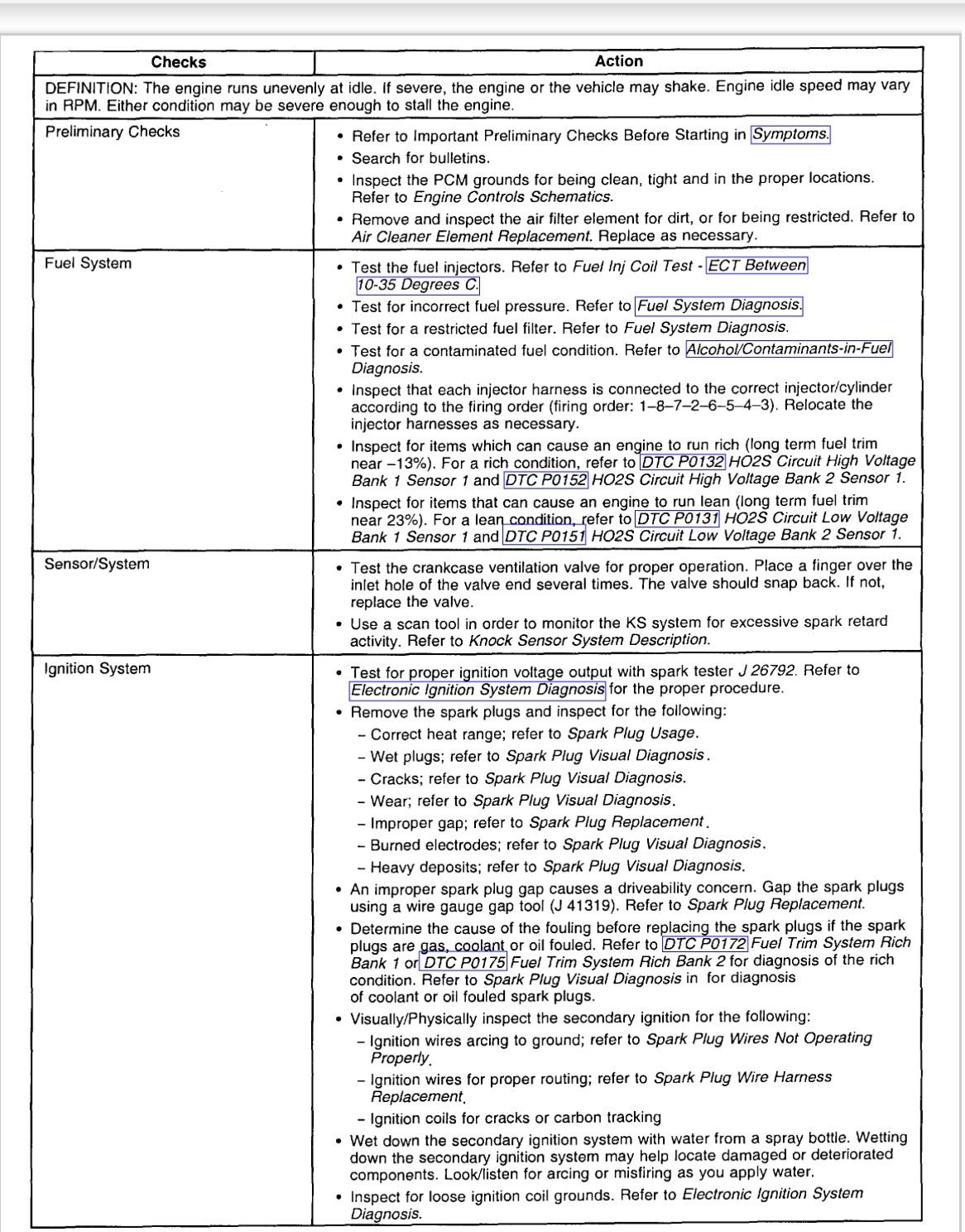

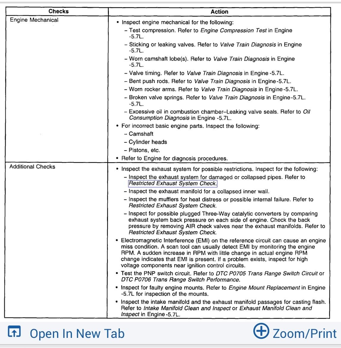

Can be MANY things…see below !!…unfortunately can’t diagnose this for you over the Internet.
