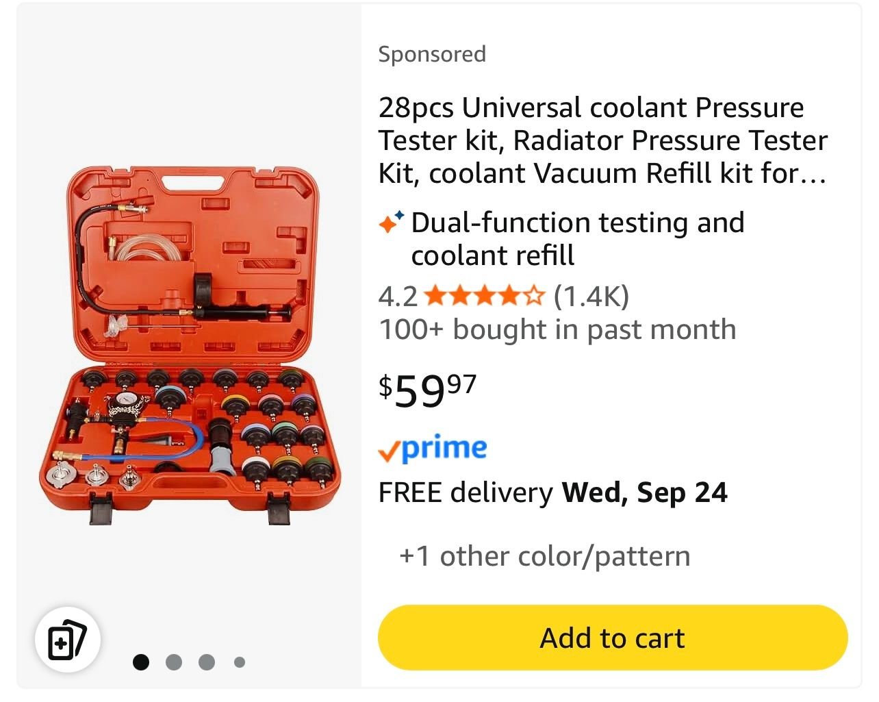

Instead of us guessing for you invest in a coolant pressure test kit and verify 100% where the leak is coming from…also includes a vacuum refill kit which is the best way to change your coolant these days…you just need an air compressor.
